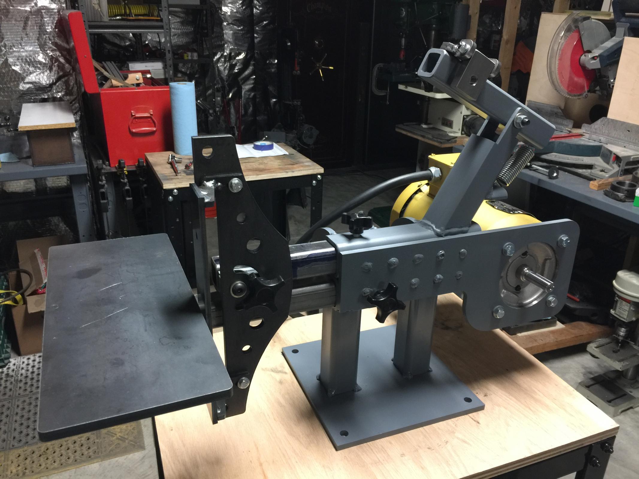

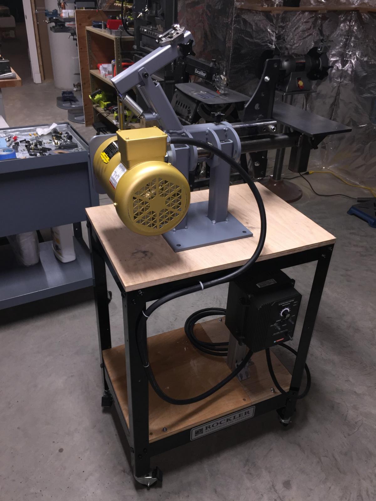

    This was a kit supplied by Brian House that included the plans, a few metal brackets, and some hardware. I furnished the square tubing and did the necessary machine work and welding. I used a 2 HP Baldor 3 phase motor and a KBAC VFD.
    I would guess that I have about 20 hours in the project, spread out over a week. As soon as the wheels and belts arrive I will be in business.

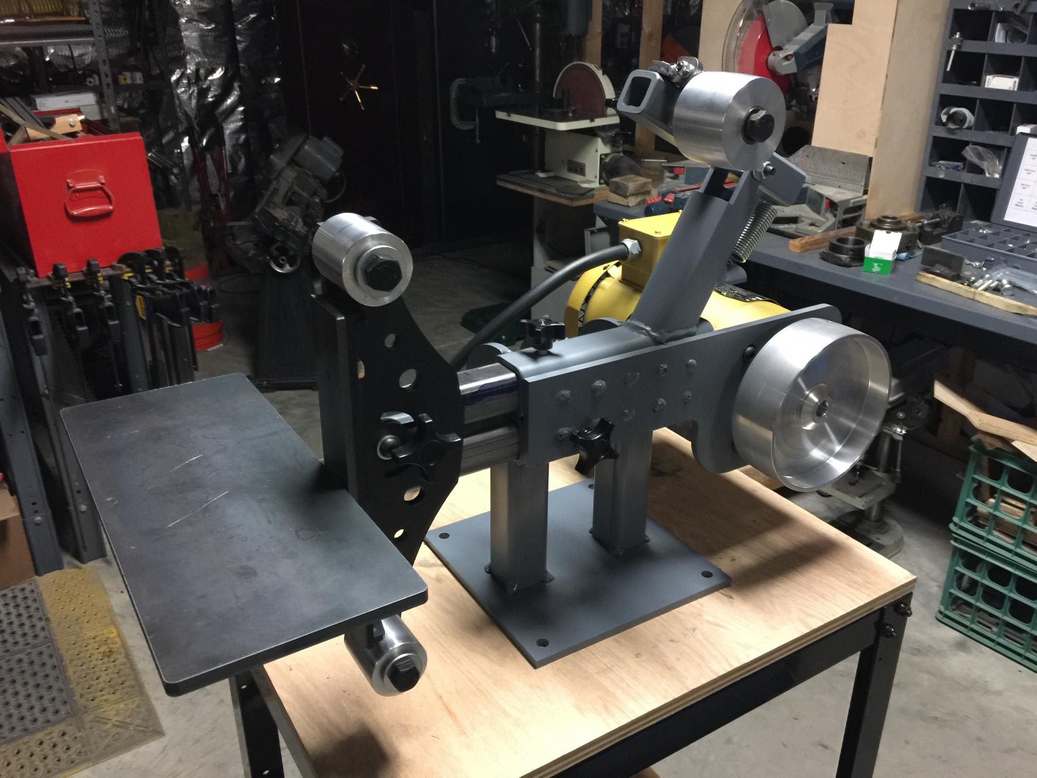

    Got the wheels today. Still waiting for the belts.

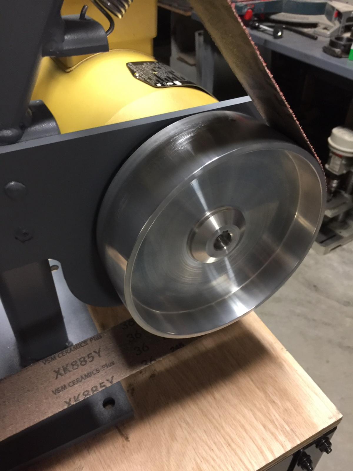

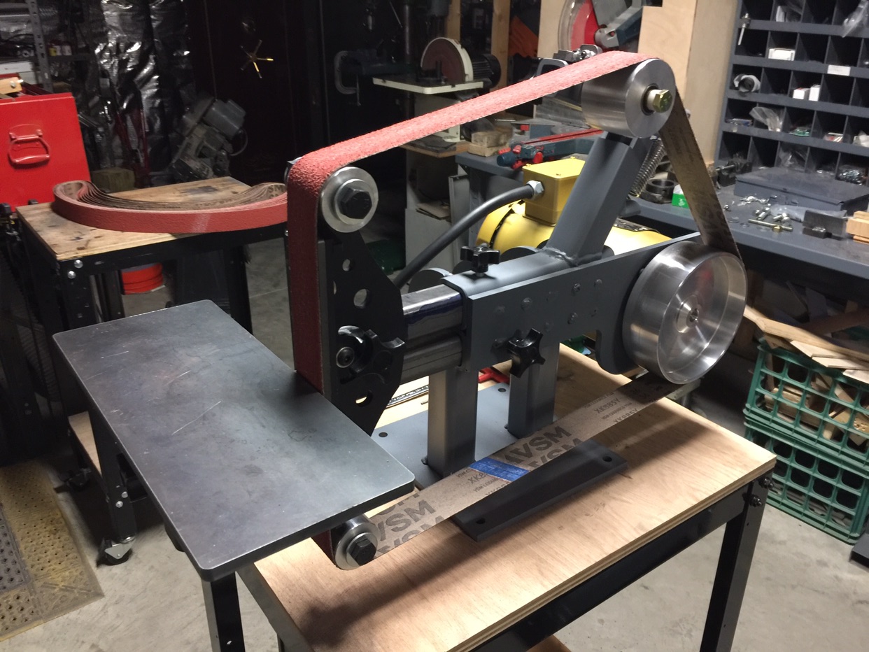

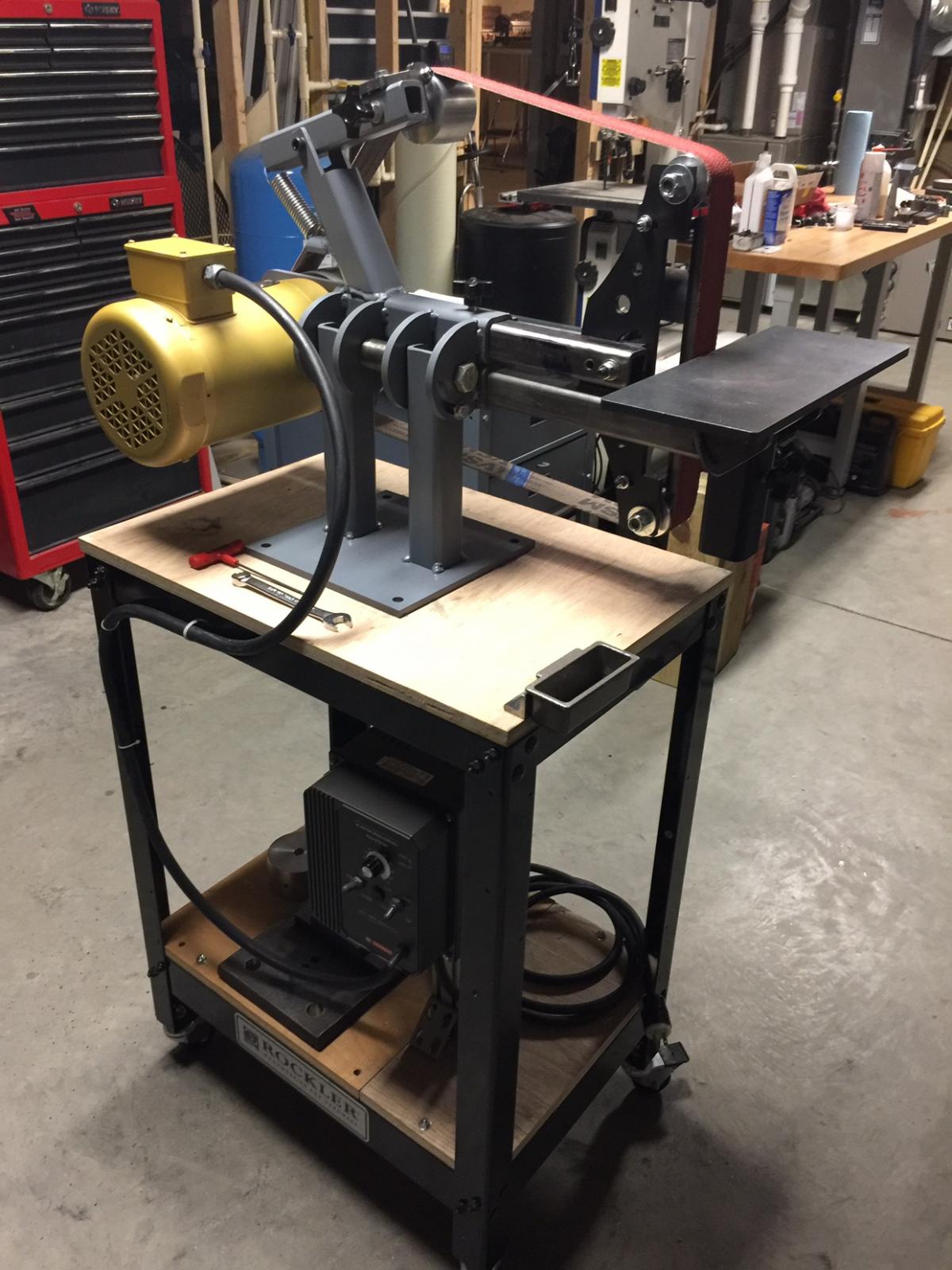

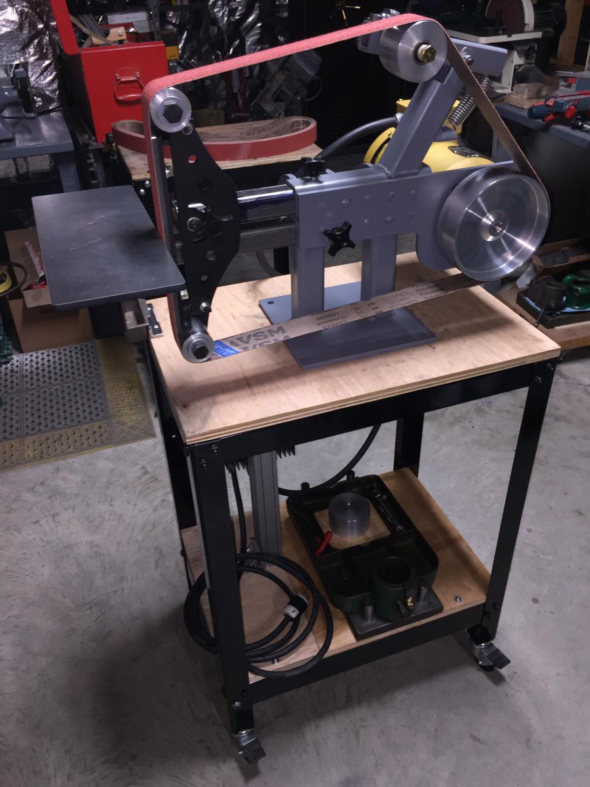

    All finished!
    With a 7" drive wheel top speed is just over 6,500 sfpm (surface feet per minute). I haven't tried grinding anything yet above maybe 3,000 sfpm, but with a 36 grit belt even that was scary fast at removing steel.

    Quote Originally Posted by tmate3 View Post
    (edit . . . ) With a 7" drive wheel top speed is just over 6,500 sfpm (surface feet per minute). I haven't tried grinding anything yet above maybe 3,000 sfpm, but with a 36 grit belt even that was scary fast at removing steel.
    I have always used the yardstick of 4,000-4500 max FPM and 1HP per inch of belt width. It is a beautiful and versatile grinder design, but as you indicate, 74 MPH seems a bit much.

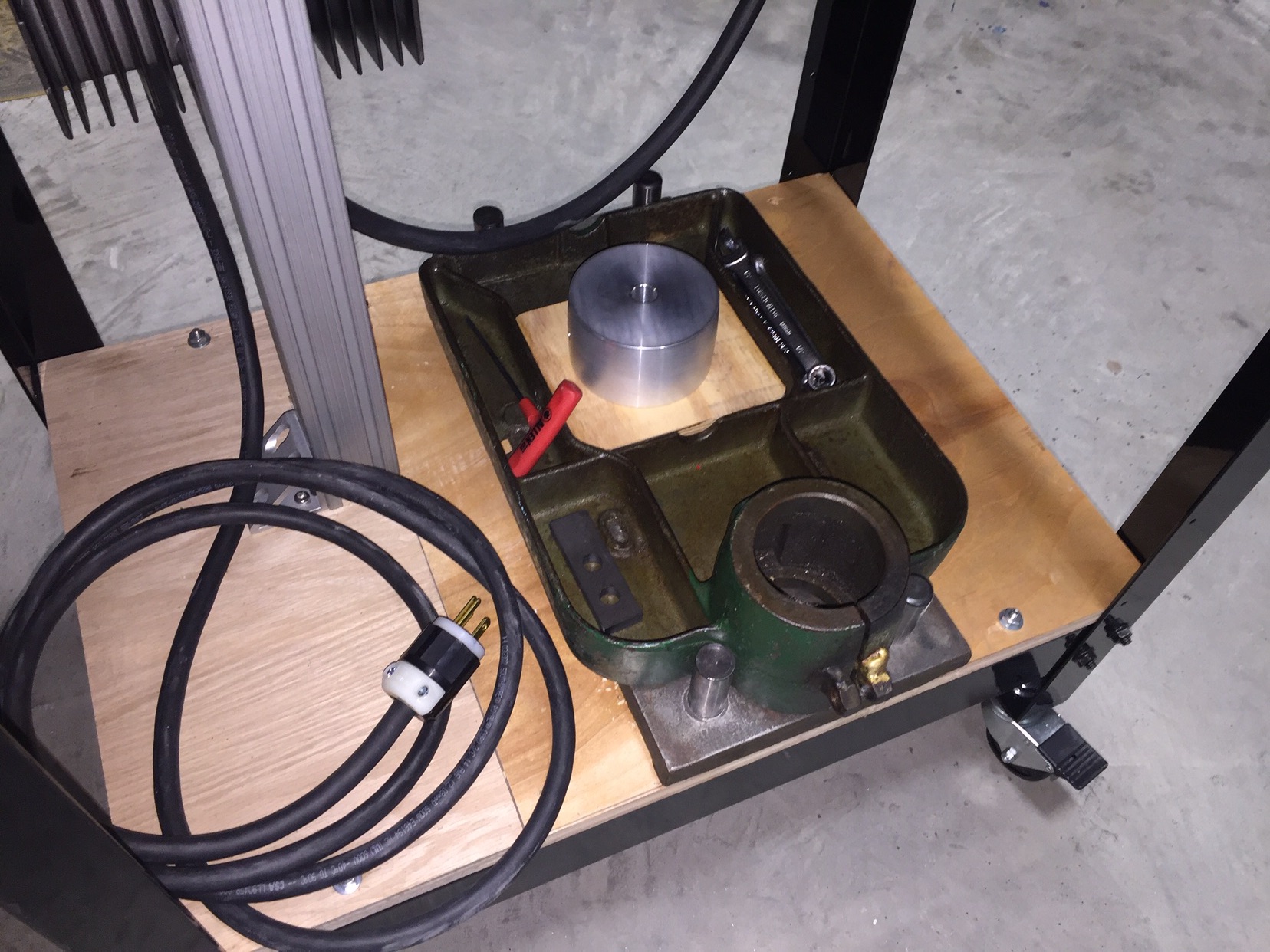

    I wanted to add a bit of weight to the 2x72 grinder cart for stability purposes, and put an old 70 lb. plate off a press brake on the lower shelf. Then my eyes fixed on an old scarred up Walker Turner drill press table I had replaced that was leaning against the bottom of my lathe.
    As it turned out, when I placed the table upside down on the brake plate, it fit perfectly between four 7/8" dia. dowel pin holes. The webbing compartments on the bottom are perfect for keeping wrenches, spacers, and other grinder related items handy. I now have 100 lbs. of ballast which makes the whole works feel a lot more solid.
    No, that isn't a square hole in the middle of the drill press table. I put a small square of plywood in there so it would be flat.

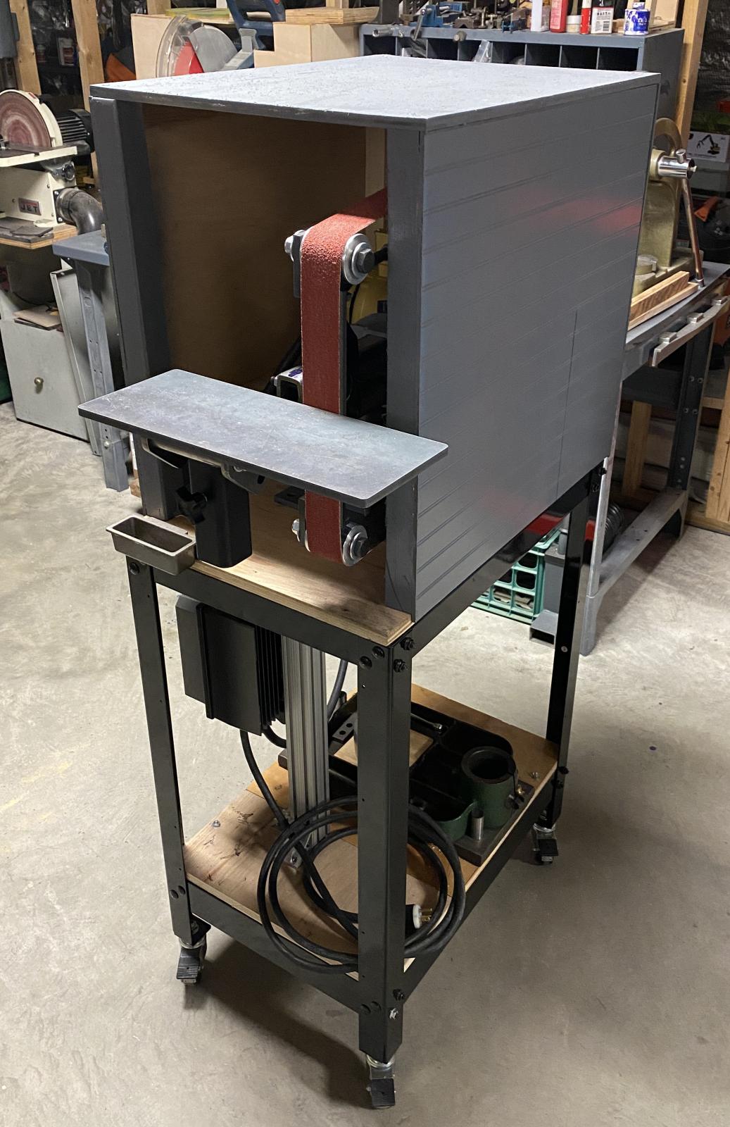

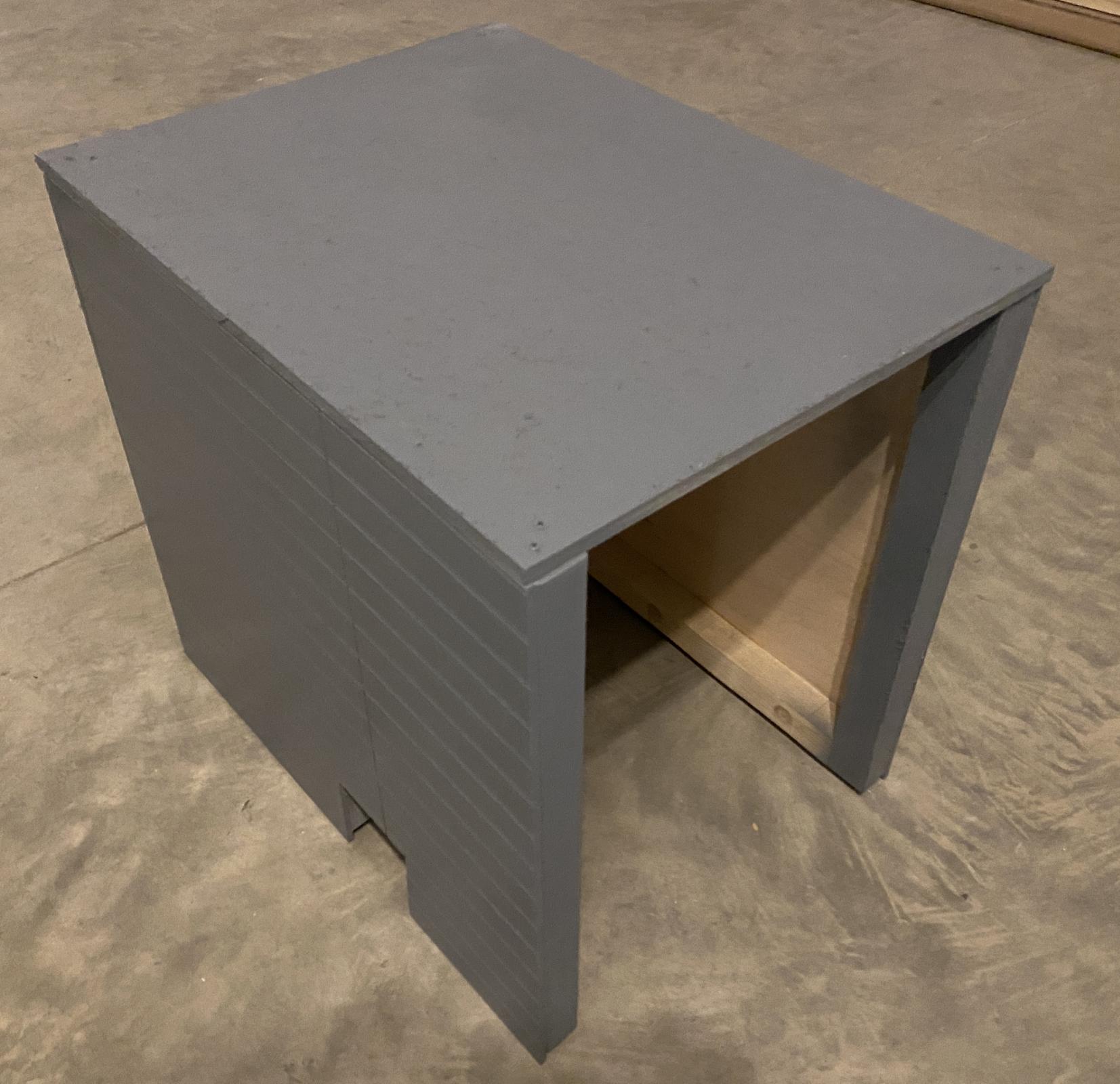

    Plywood Shroud for 2x72 Grinder
    I threw together a plywood cover for the grinder, which I hope will partially contain the debris and soften the noise a bit. It lifts off in seconds for belt changes, etc.
    Motor is a TEFC unit so I don't think it will be affected as long as there is plenty of air circulation around it. Cover should also provide some protection in case a belt disintegrates.

    Nice! I did one myself but made all the pieces myself including the wheels! It added to the time line but was a lot of fun. My 2 x 72 can be seen here:
    2 x 72 inch Revolution Belt Grinder (aka The Metal Muncher!)
    If your like me, next you will be building all kinds of accessories to go with it. I did everything but a buffing wheel and surface grinding attachment. I too did the 7 inch wheel and it's CRAZY fast! Too fast I think, I usually run only about 1/2 way.
    I see your trying to control the dust. That's a big issue with these! I take mine outside every time I want to use it which is a pain. I was thinking of building a tent over mine but I like your idea of a box. Rig in a shop vac and you might just have something there!
