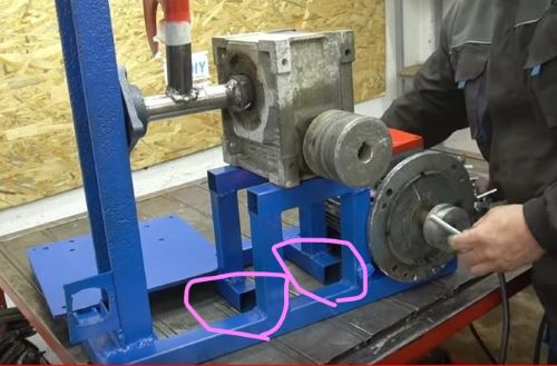

    Percussion log splitters are very clearly dangerous, A portable saw is far safer:

    Agreed. Horrendous. Starting with goofy turned down hat brim. What blade?
    Without enough inertia for a sure cut, throws your timing off.
    Hello emergency room, goodbye digits. The terrain says one not around the corner either.

    I see his key-way cutting skills did not stand the test of time! His solution rather appalled me, welding the shaft at both ends to the gear hub! :-(
    Severe thumbs down for that! His one bolt fastening of the electric motor, was right up there with Heath Robinson, too!
    His lack of materials lead to a couple of design anomalies... see the bottom of the gearbox mounts...
    Attached Thumbnails Attached Thumbnails Amazing Homemade Log Splitter Wood Processing Machine using Worm Gearbox 20:1-wood-splitter_li.jpg
