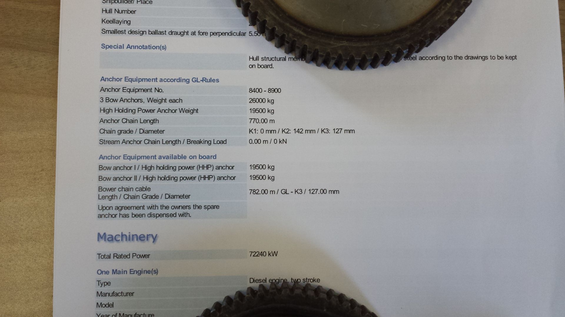

    Hello Toolmaker 51,
    Can't agree that anchors are just decoration, as classification societies require minimum weight of anchor for every ship. If anchor is HHP (high holding power), all classification societies allow anchor weight reduction of 25%. For example anchors on my ship (14000 TEU container carrier) are AC14 type anchors and each weighs 19.5 metric tonnes. And yes, the weight and length of paid out chain is very important. Original chain diameter on my vessel was 127 mm (5 inches). More chain you have in the water, the angle between the chain and the sea bed is smaller, which makes pulling of anchor more horizontally. Sole chain without anchor can't keep the vessel anchored. Dragged anchor several times, but it was always on the ships with Hall anchors. So far never happened to me with this AC14 type anchors. Part of technical file from class certificate attached.
    Best regards
    LMMasterMariner
