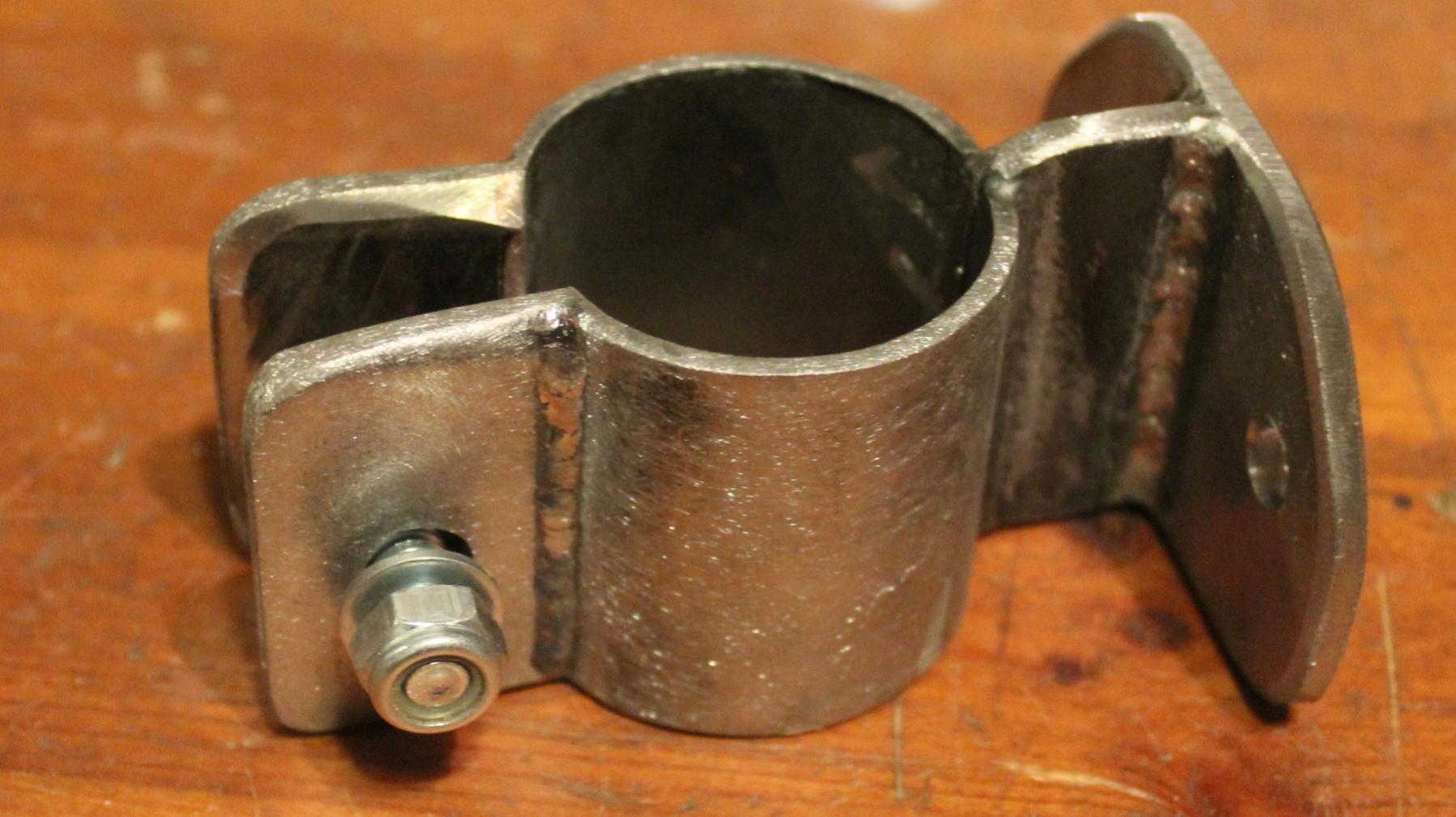

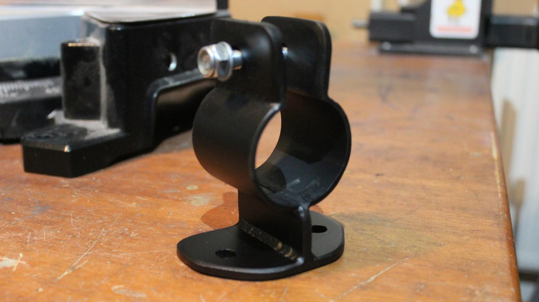

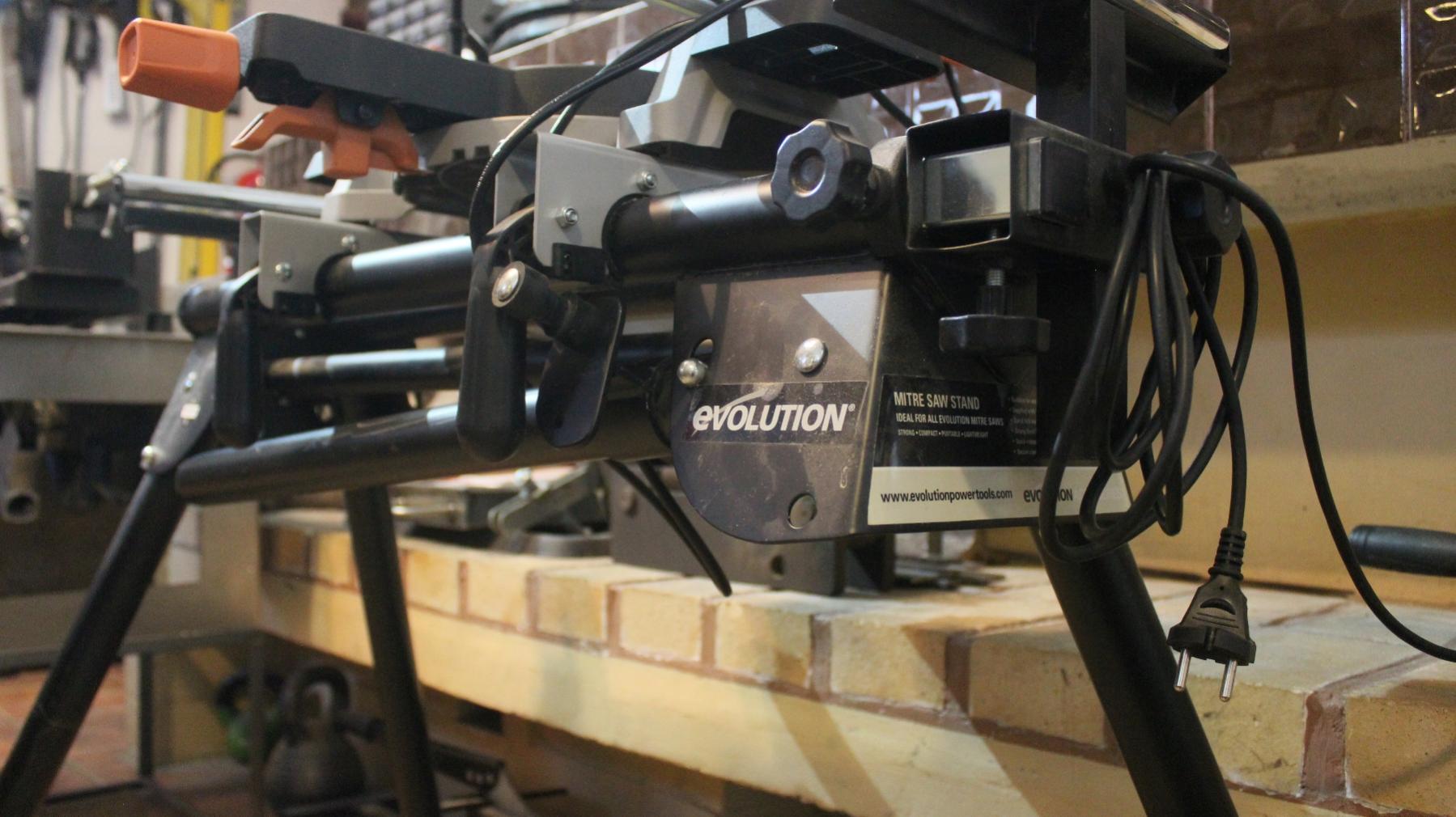

    Last days, i have used miter saw quite a lot for cutting metals.
    Tought that it would be usefull if grinder comes with it, then i can wipe out coarse right after cutting.

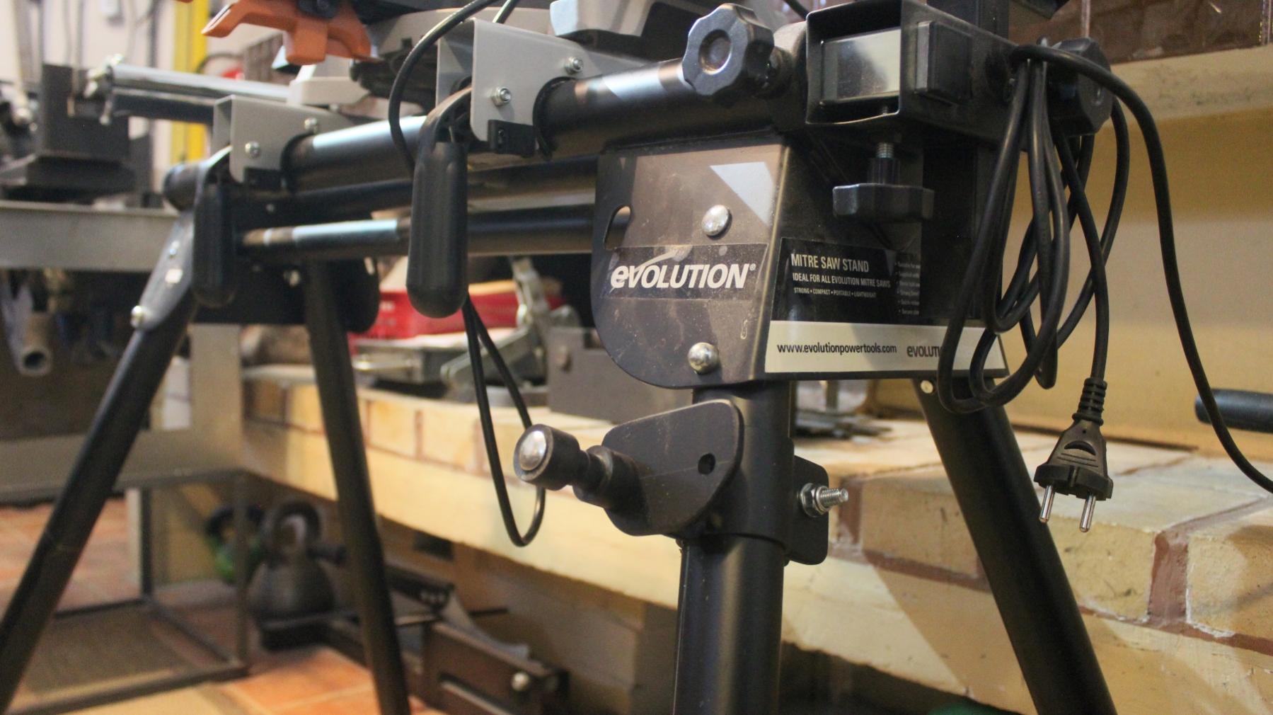

    Made this simple holder for my grinder.
    Material is 45mm pipe and 5mm steel plate. M8 screw and some rubber plugs that i have hoarded somewhere.

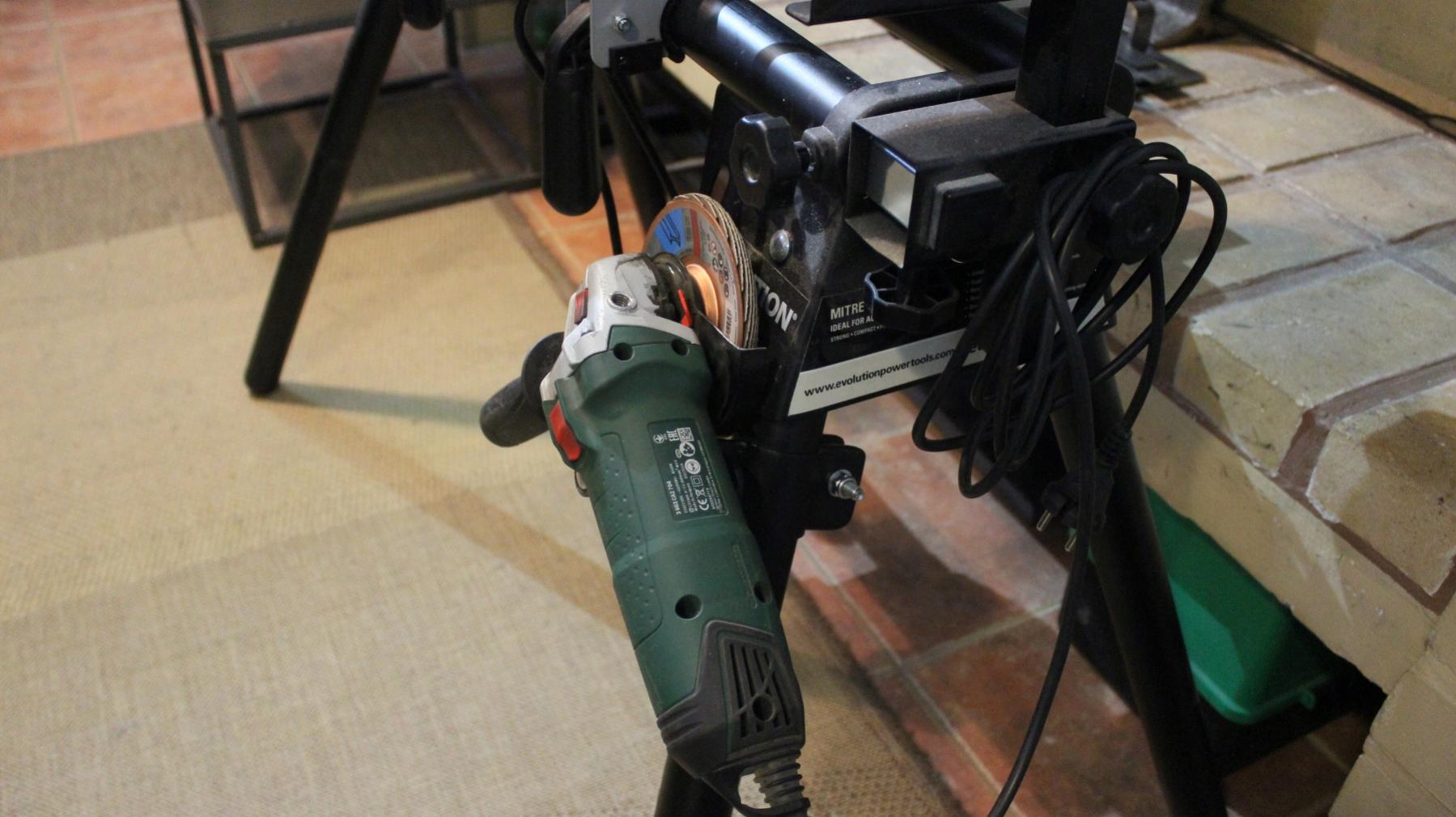

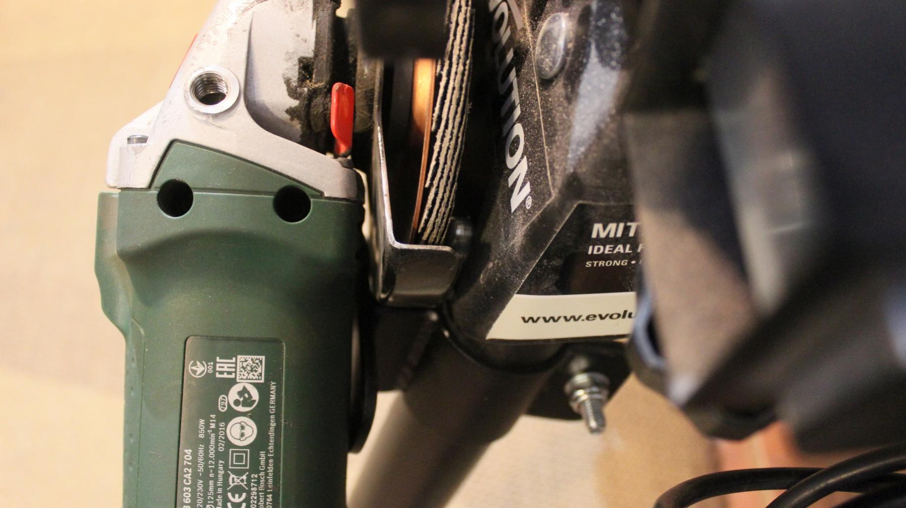

    Angle grinder rests between rubber plug thingys, and disc guard leans to the locking button of the stands feet.
    Grinder stays nicely on its place, even when shaking the stand. Very simple solution.

    What Tuomas has done is to make a holder which attaches to the leg of his table saw stand to hang his rt angle grinder on. This way it will be right at hand to de burr or clean up the cuts he is making without having to look for his grinder all the time. Actually a great idea as it not only saves him time it safely stores his grinder.

    My original idea was to weld hooks for the plate, and place grinder between it. Then i noticed that hooks, ain't necessary. That's why it has two holes, but only one in use.
