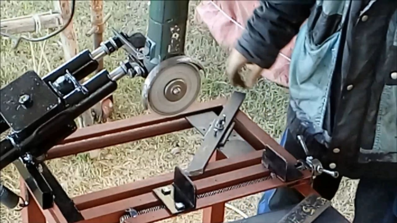

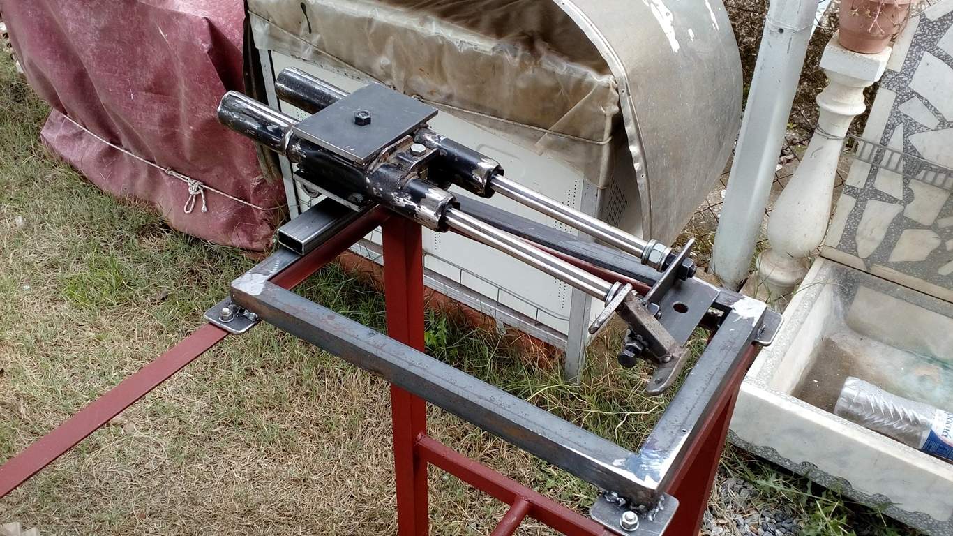

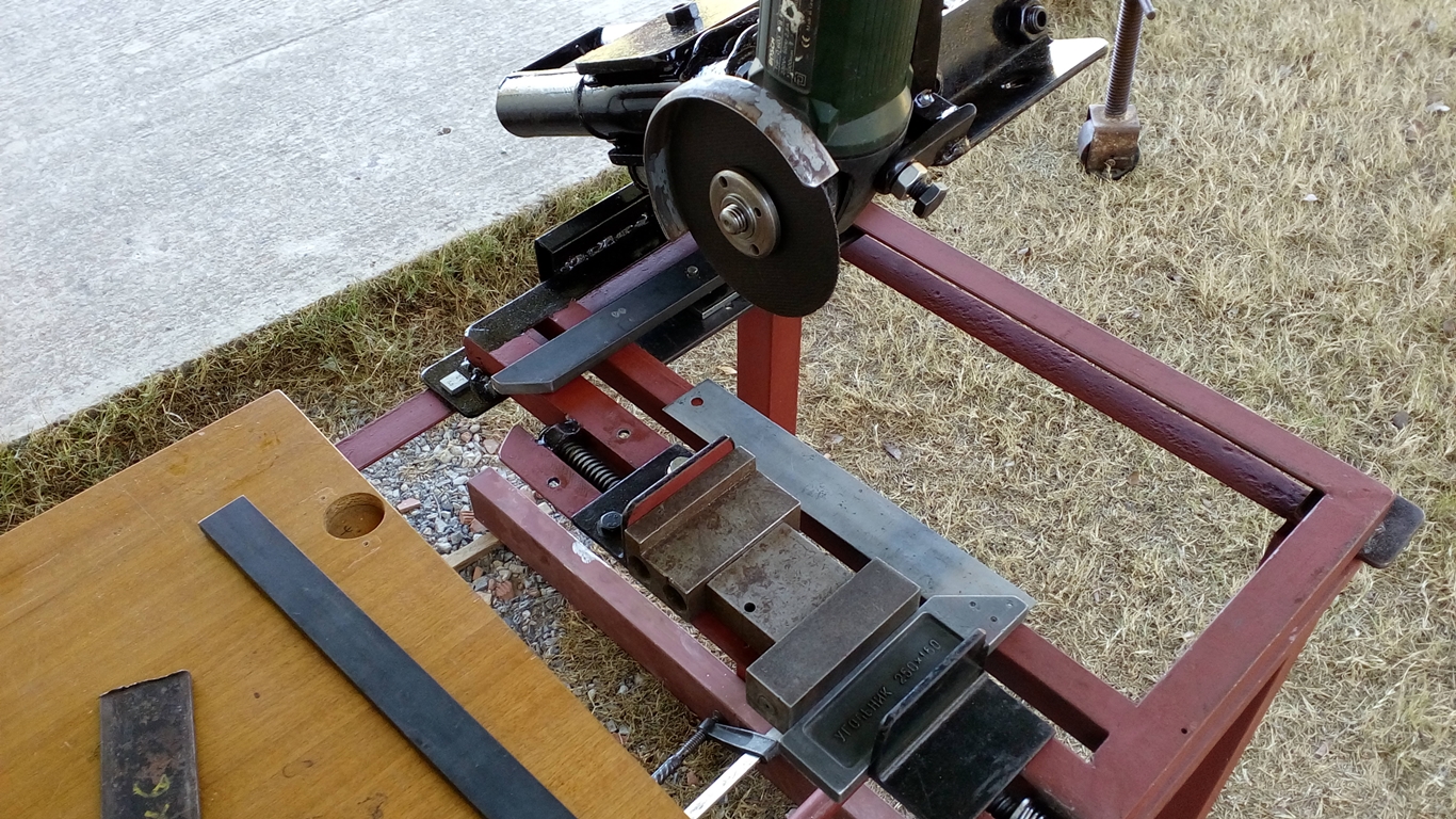

Angle Grinder to Radial Chop Saw

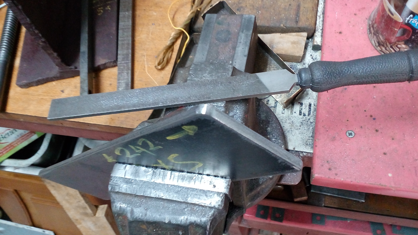

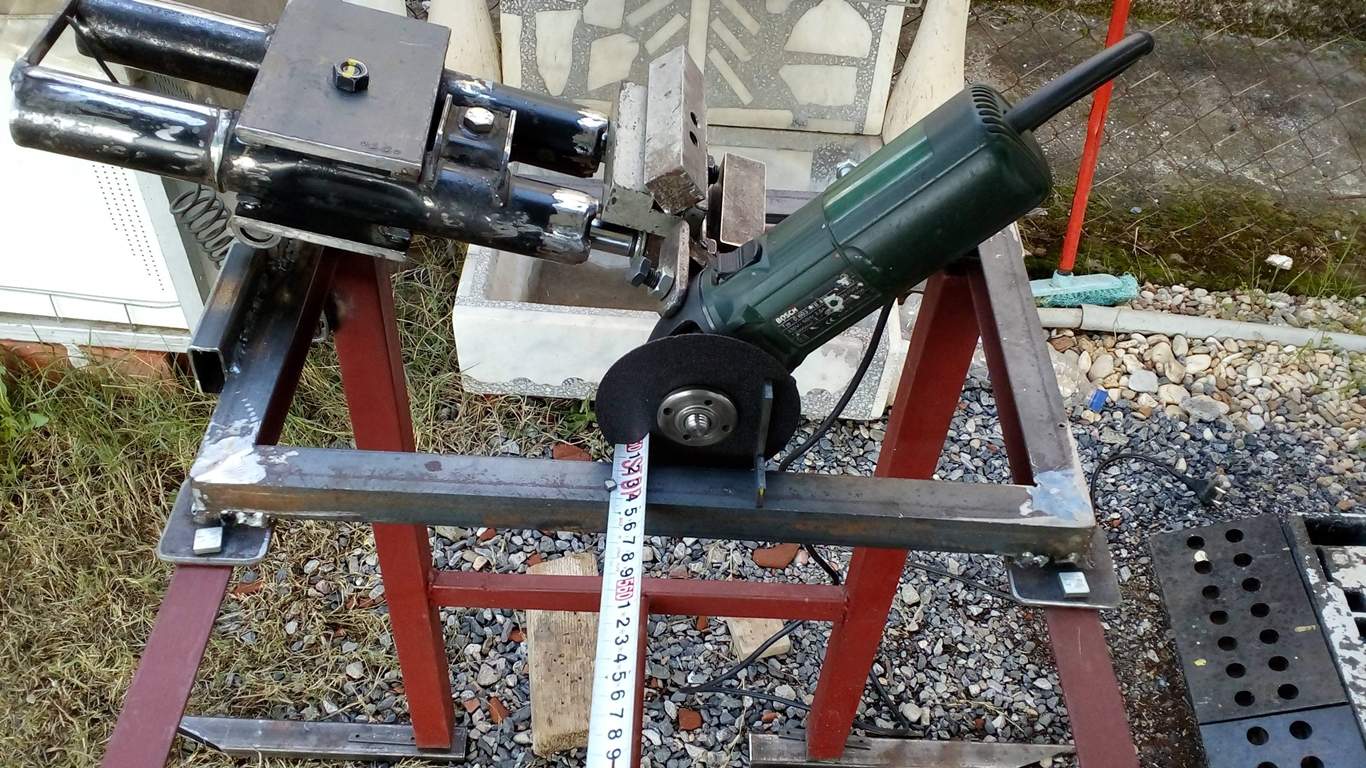

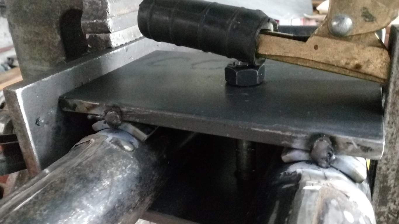

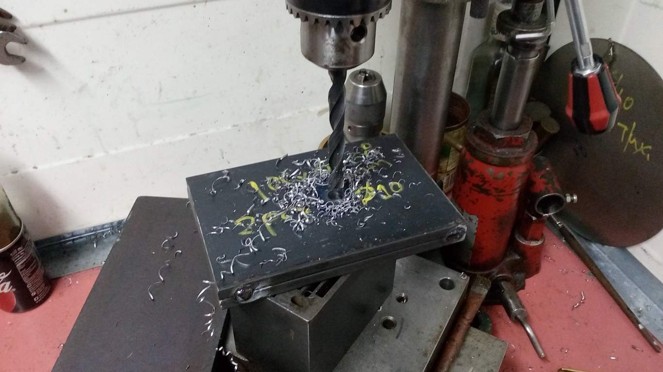

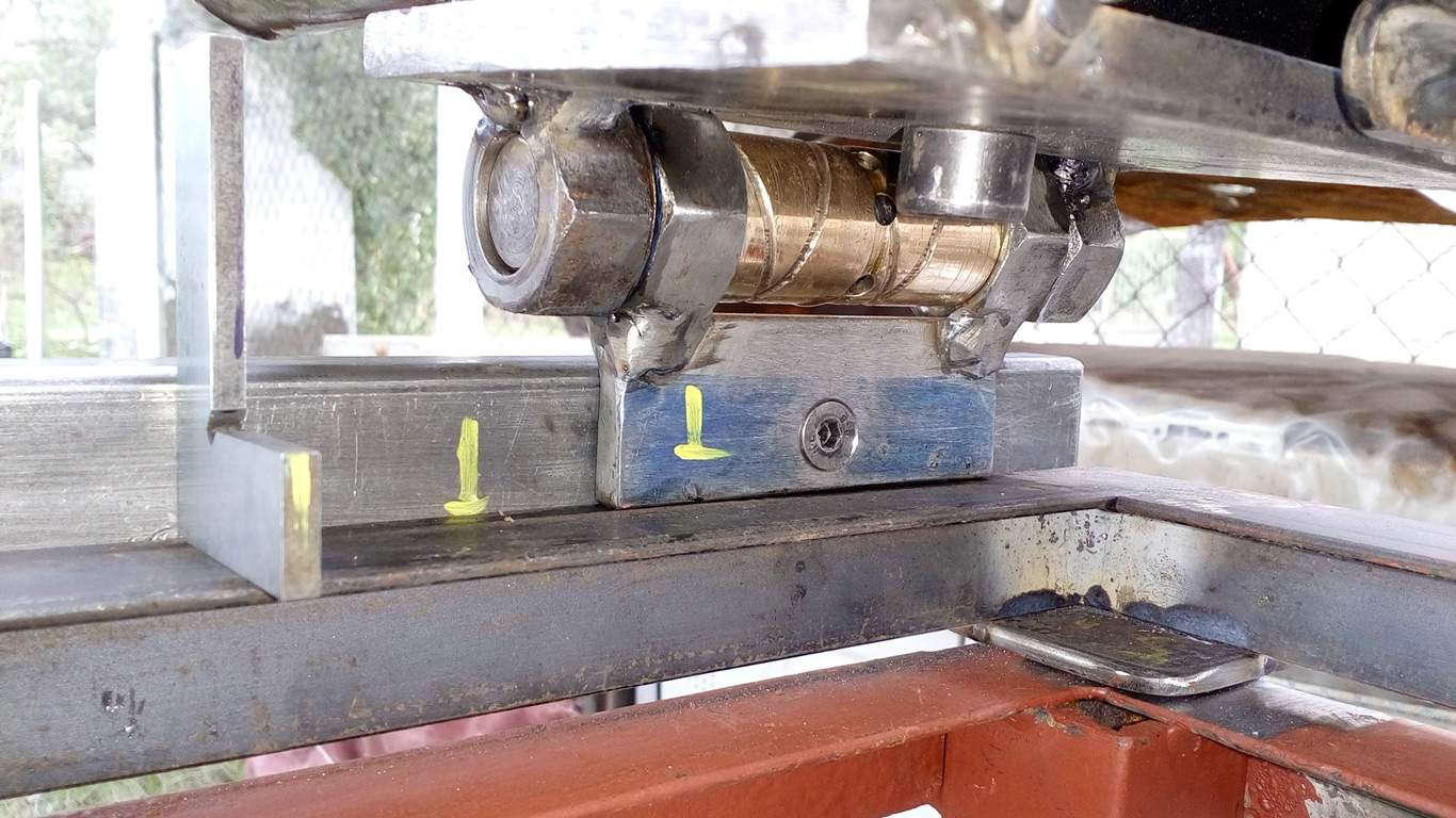

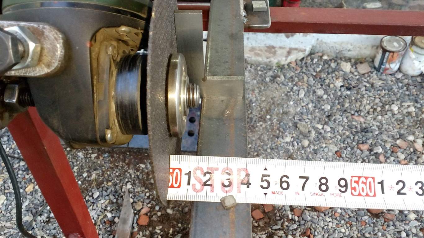

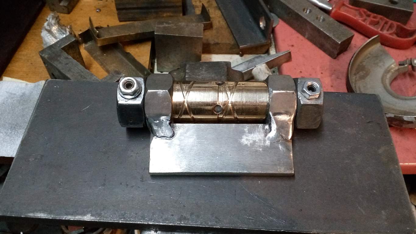

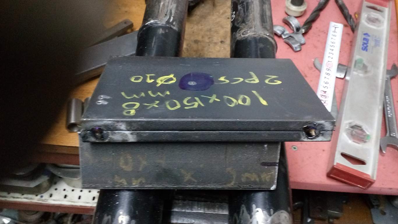

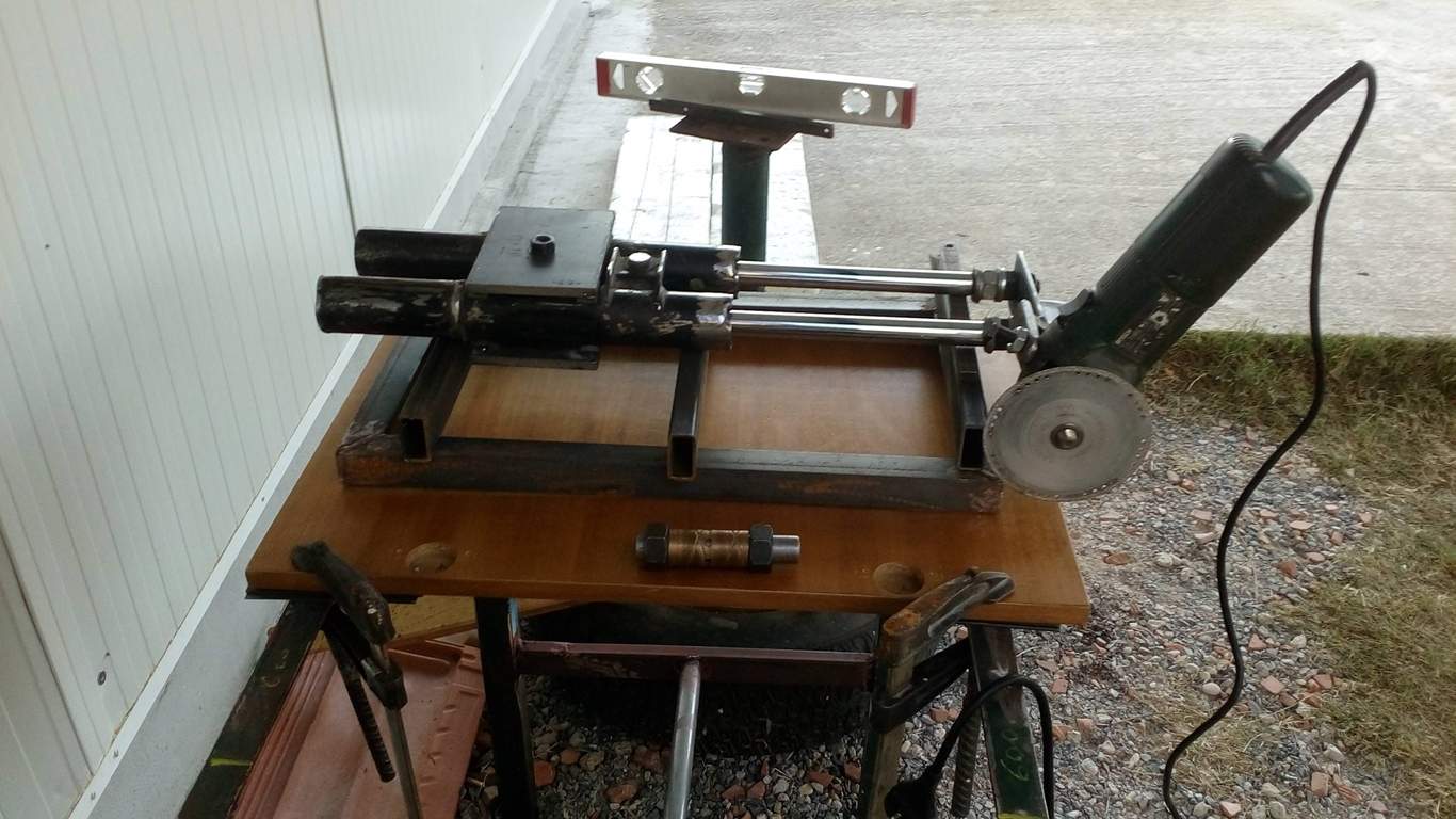

For this build used two old used shock absorber bottles into one pair of a parallel arrangement and an angle grinder Ø115mm.
The grinder's traveling is 175mm.
Before proceed to anything I had remove the hydraulic fluid from pressure tubes.

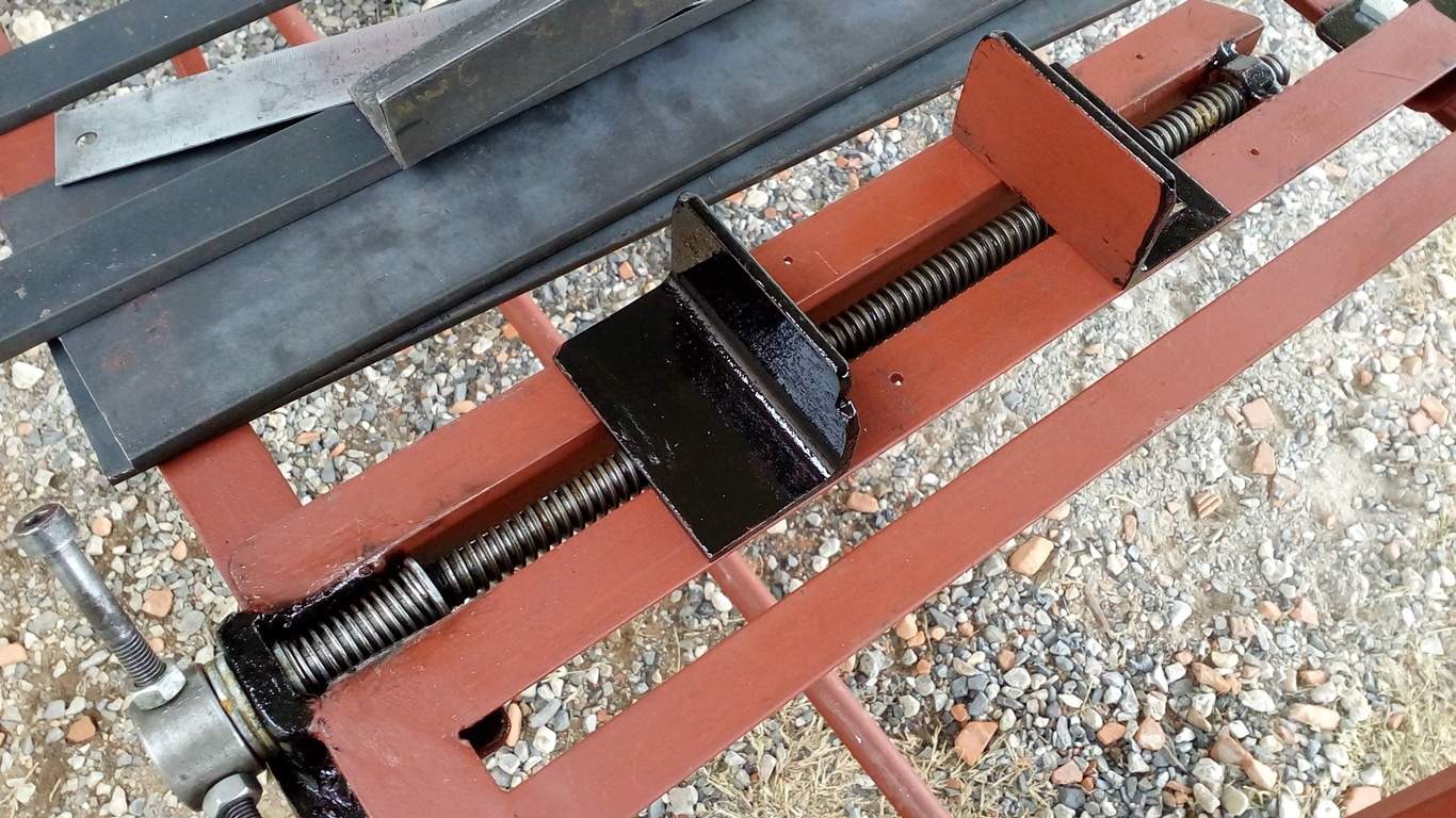

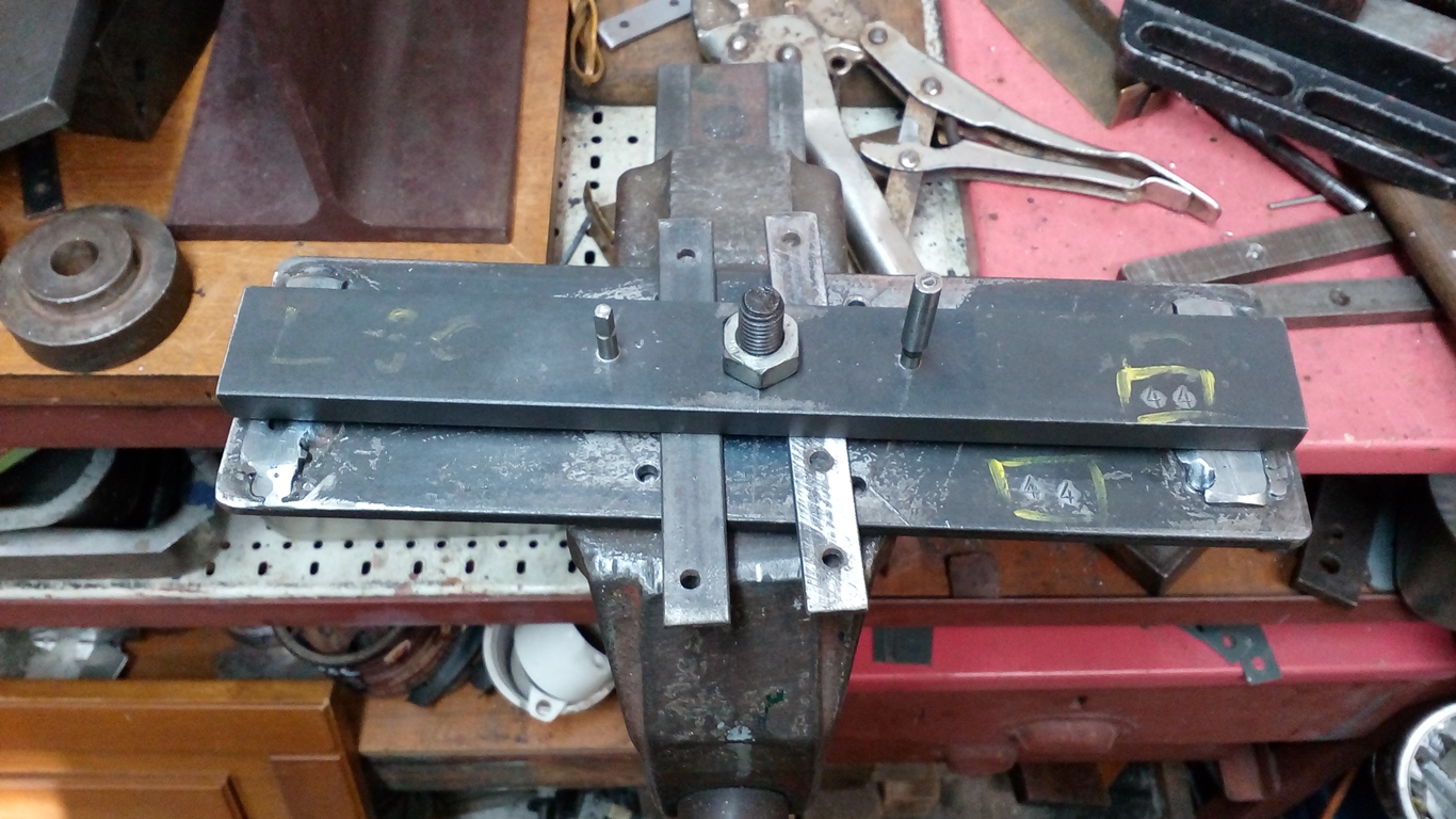

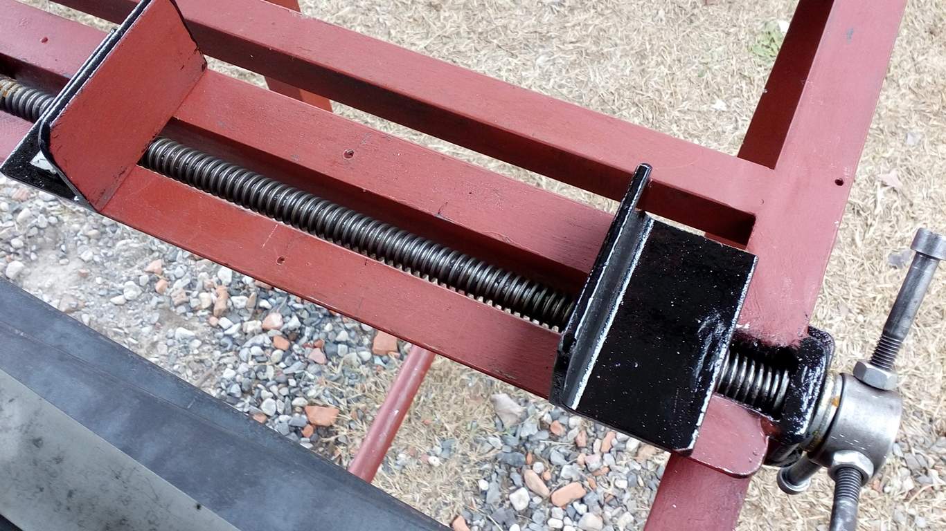

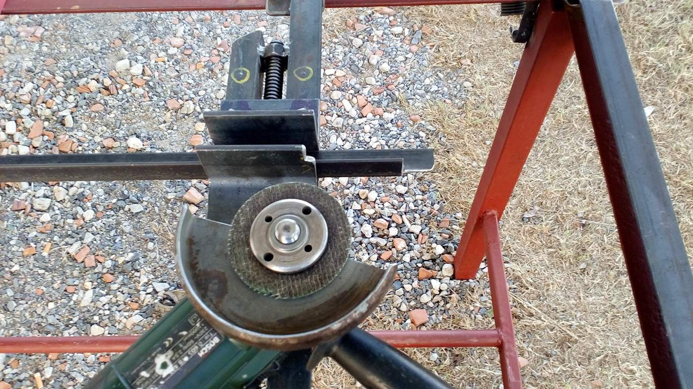

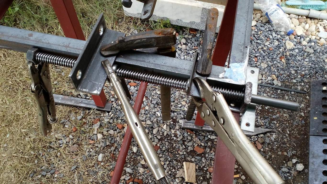

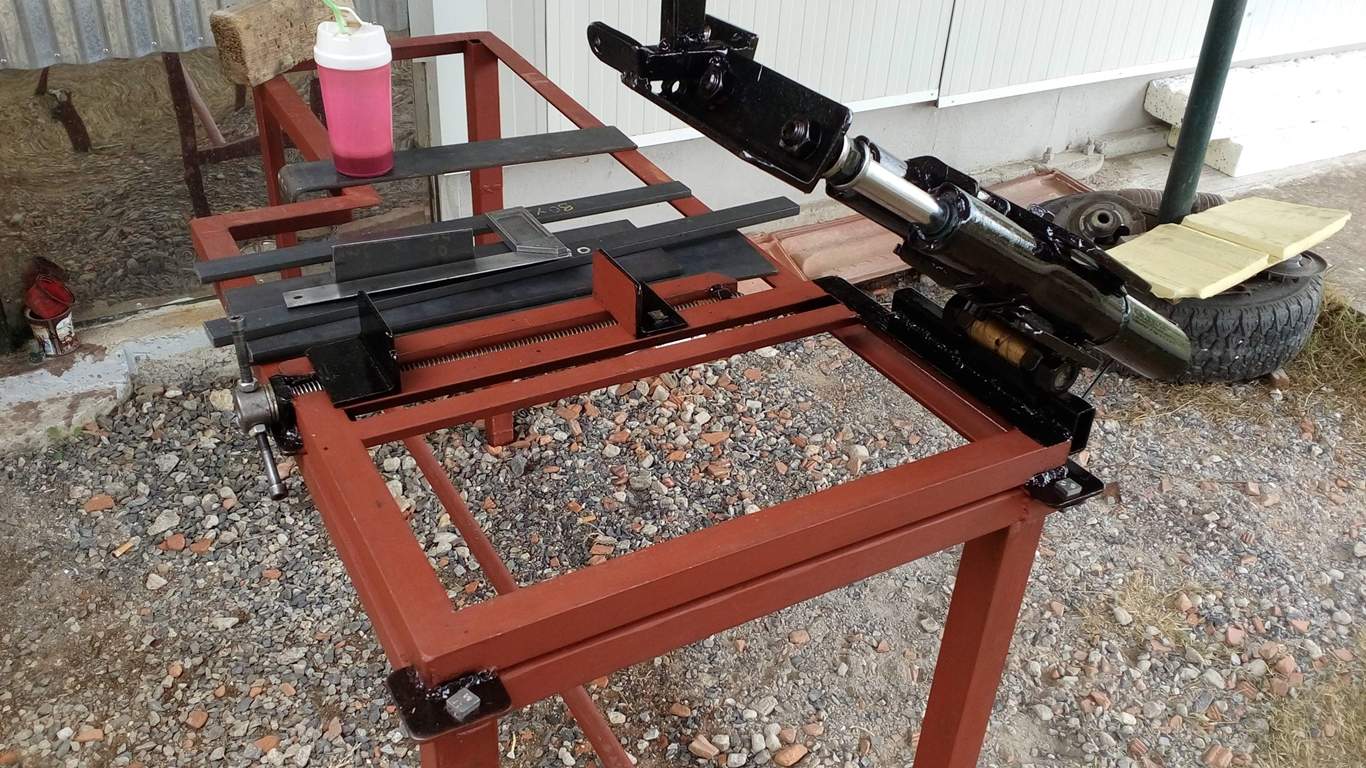

Over the base at the left side I made a vise for straight cuts as well and a sliding cutting guide at the right side for straight cuts at zero degrees and bevel cuts at 45 degrees.
My English is too poor to describe the whole process of this project and I will need too many hours for translating.
So I will use some sort descriptions and of course I will answer at all questions to everyone.
So please forgive me.

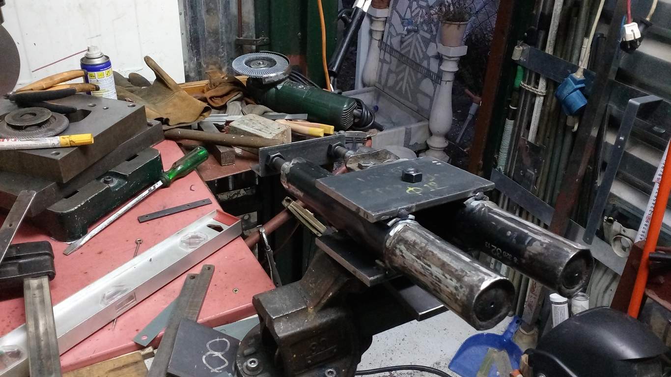

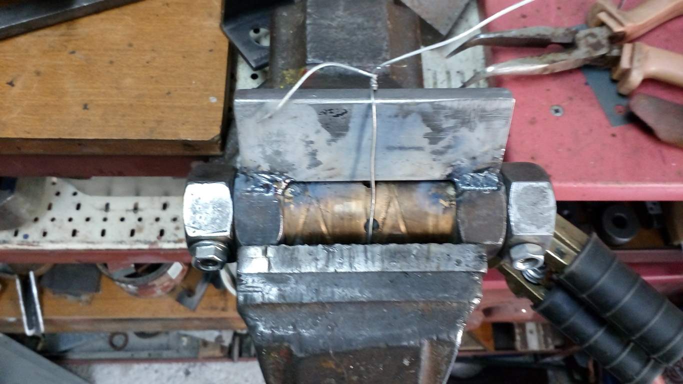

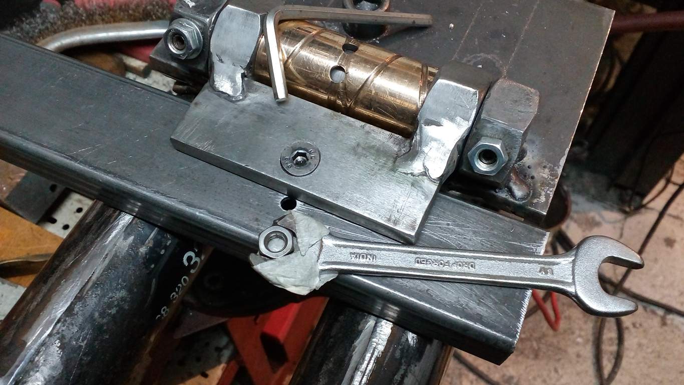

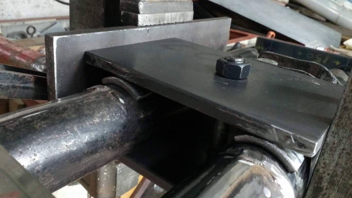

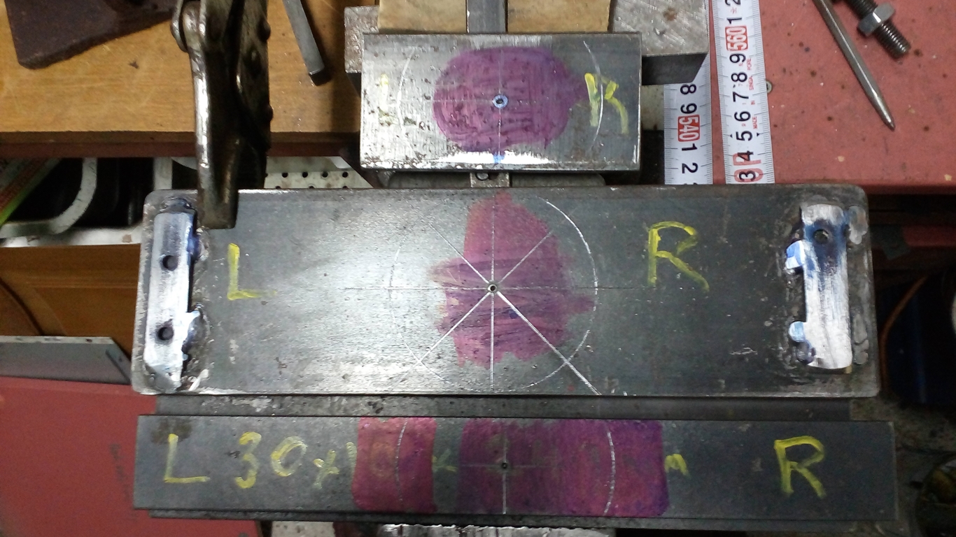

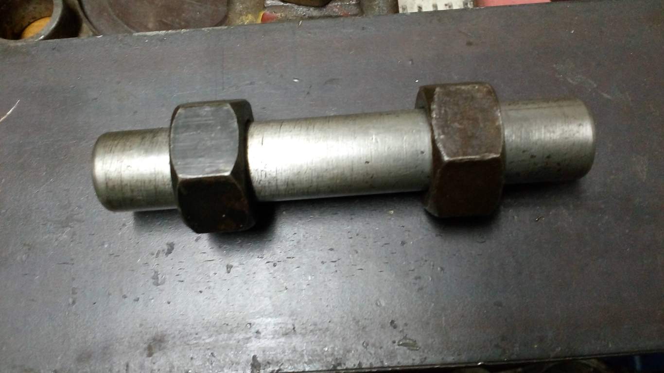

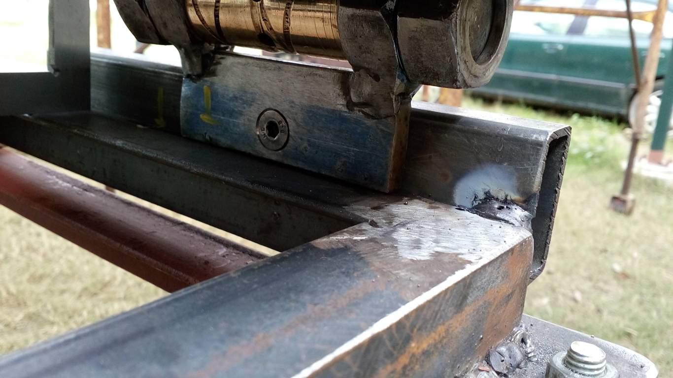

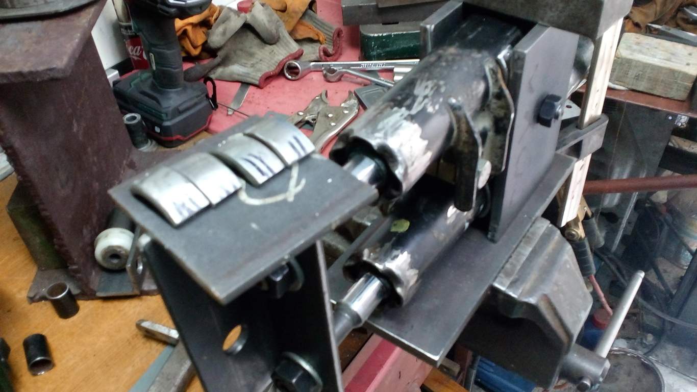

Part1
The two shock absorber bottles into one pair of a parallel arrangement.
Pivot and bousings.
https://youtu.be/TLDHSptYSns
Attachment 32768 Attachment 32769 Attachment 32770
Attachment 32771 Attachment 32772 Attachment 32775
Attachment 32773 Attachment 32774 Attachment 32776
Attachment 32777 Attachment 32778 Attachment 32779

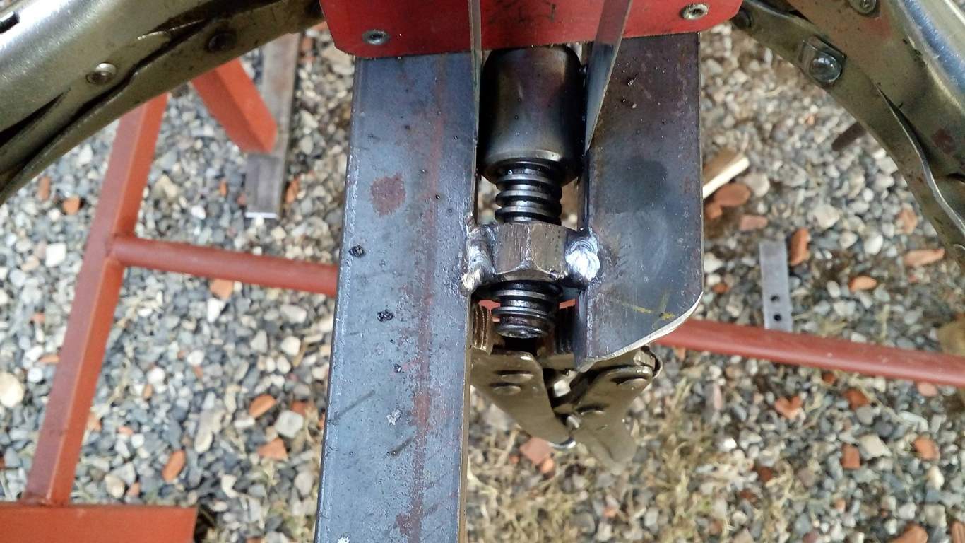

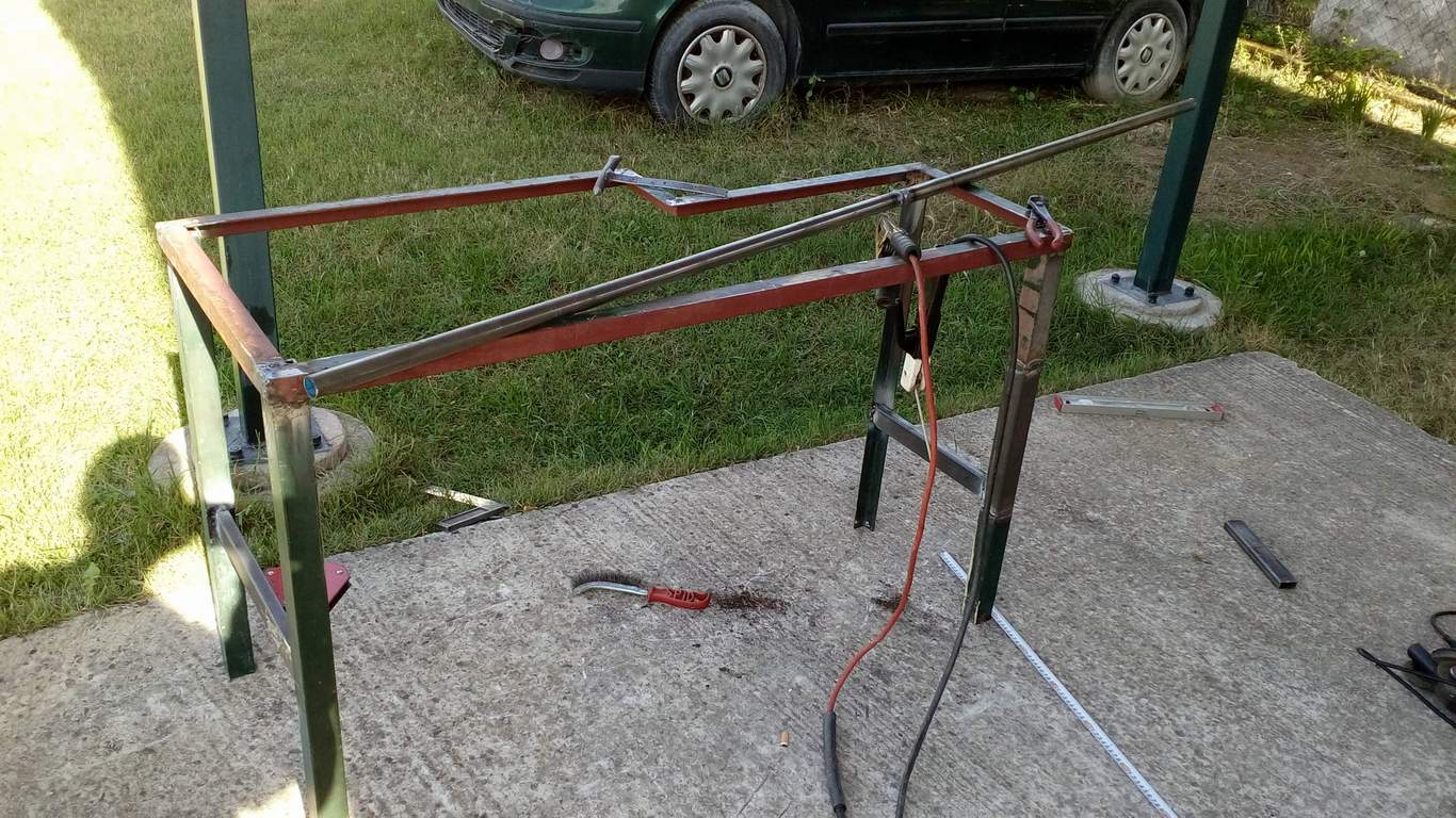

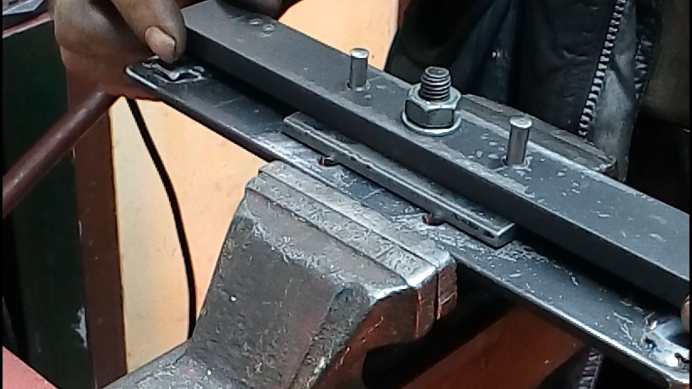

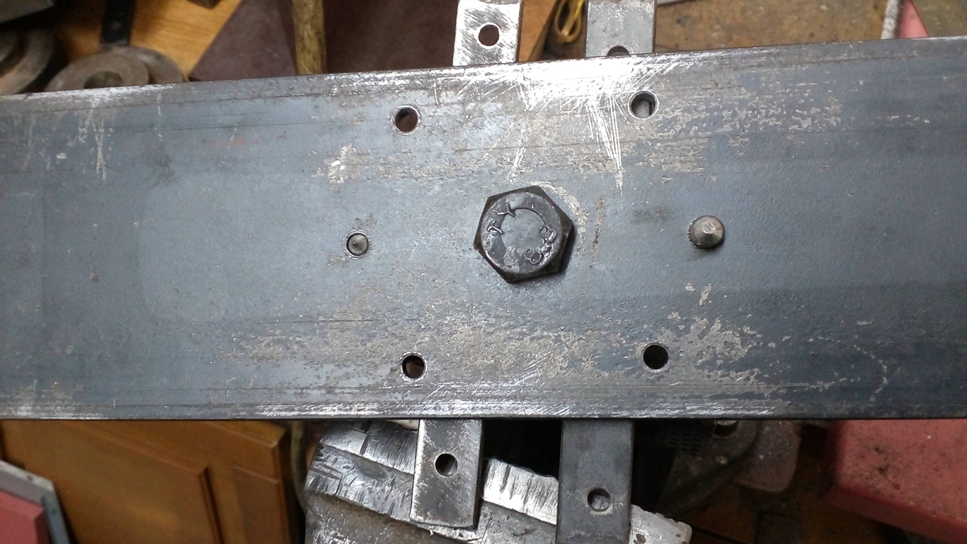

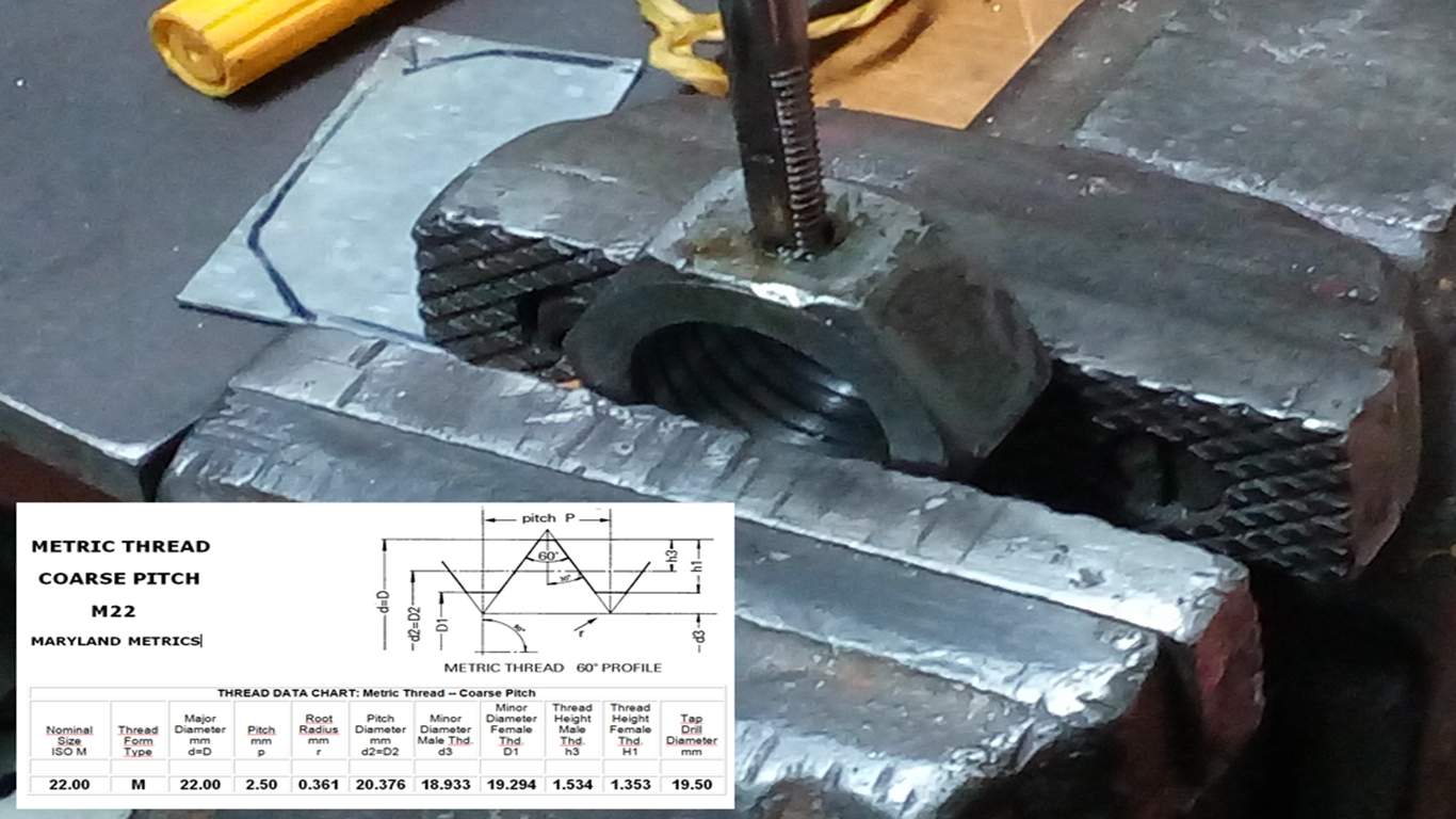

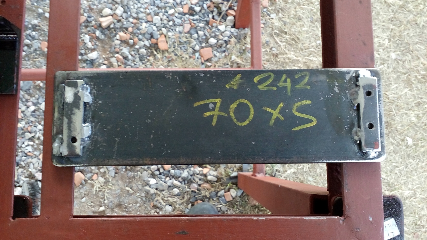

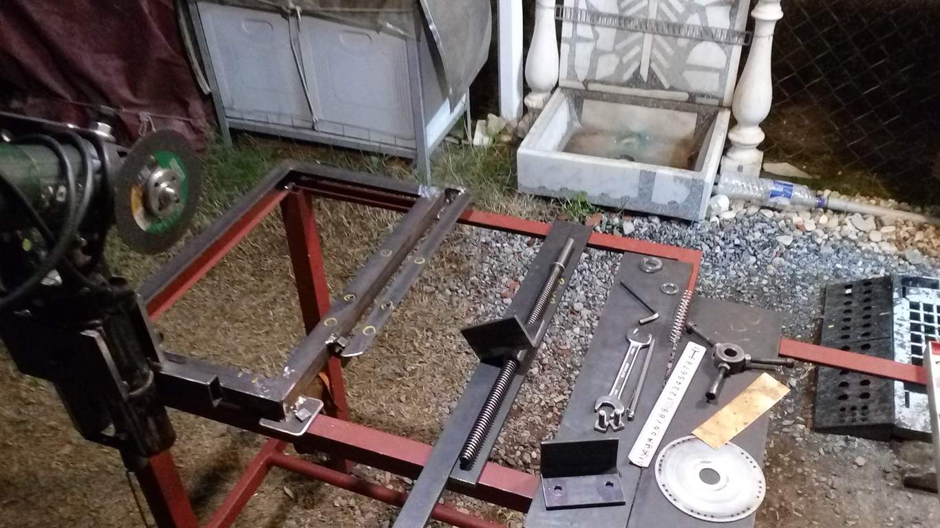

Part2

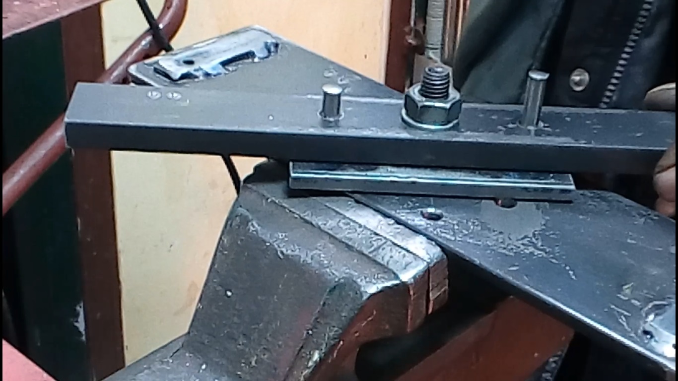

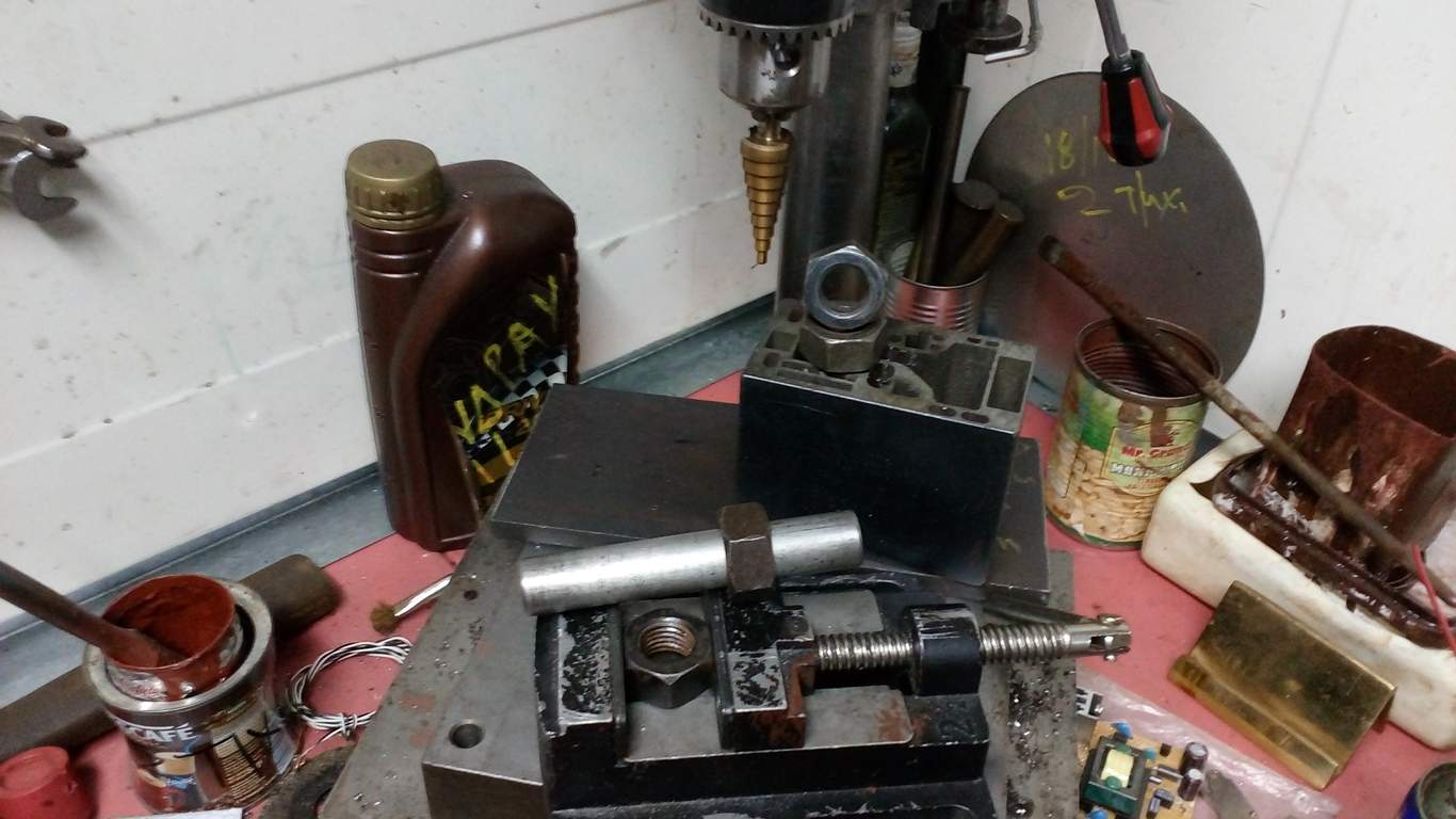

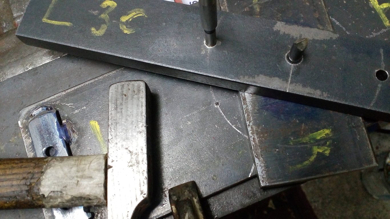

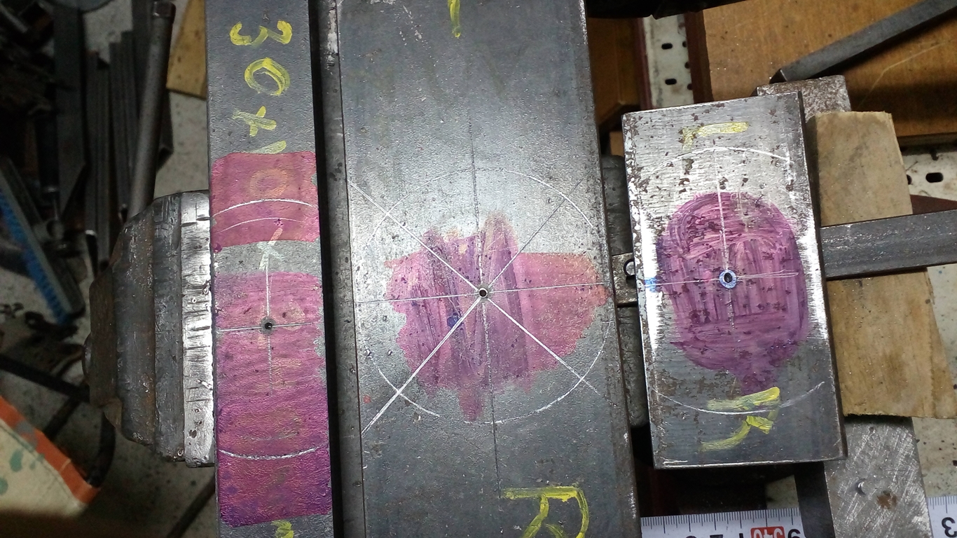

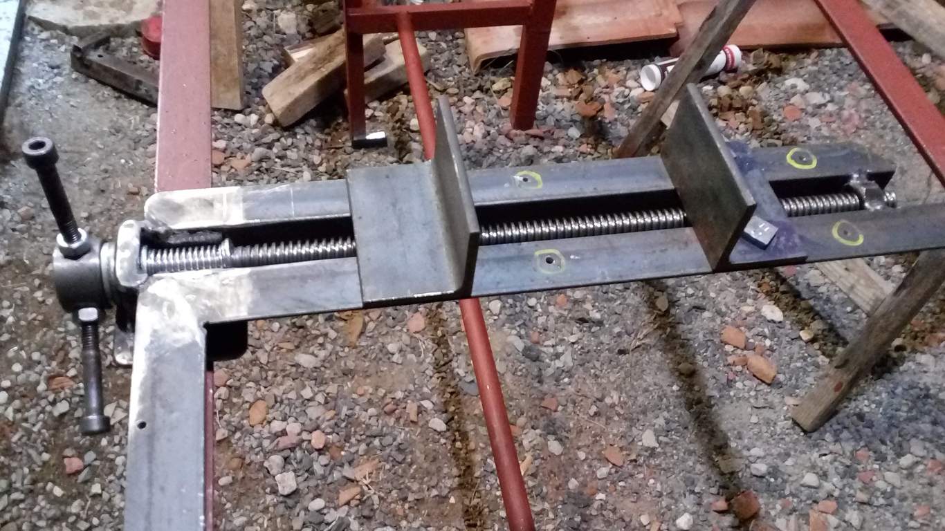

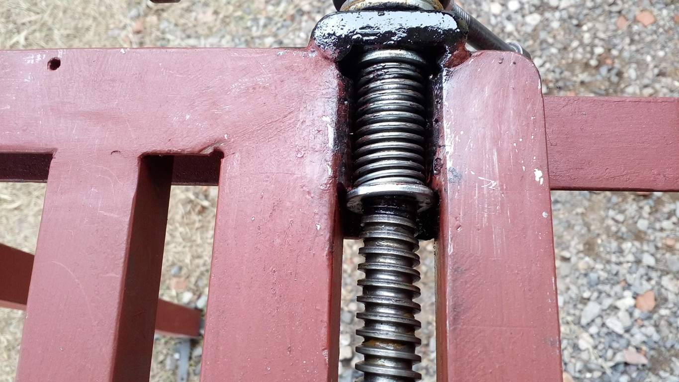

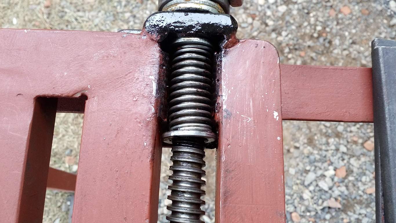

Bench - Βase
Mounting and leveling at the base the arrangement with the shock absorber bottles
Vise
https://youtu.be/XBZ7POLpXtI
Attachment 32749 Attachment 32750 Attachment 32751
Attachment 32752 Attachment 32753 Attachment 32754
Attachment 32755 Attachment 32756 Attachment 32757
Attachment 32758 Attachment 32759 Attachment 32760
Attachment 32761 Attachment 32762 Attachment 32763
Attachment 32764 Attachment 32765 Attachment 32766
Attachment 32767

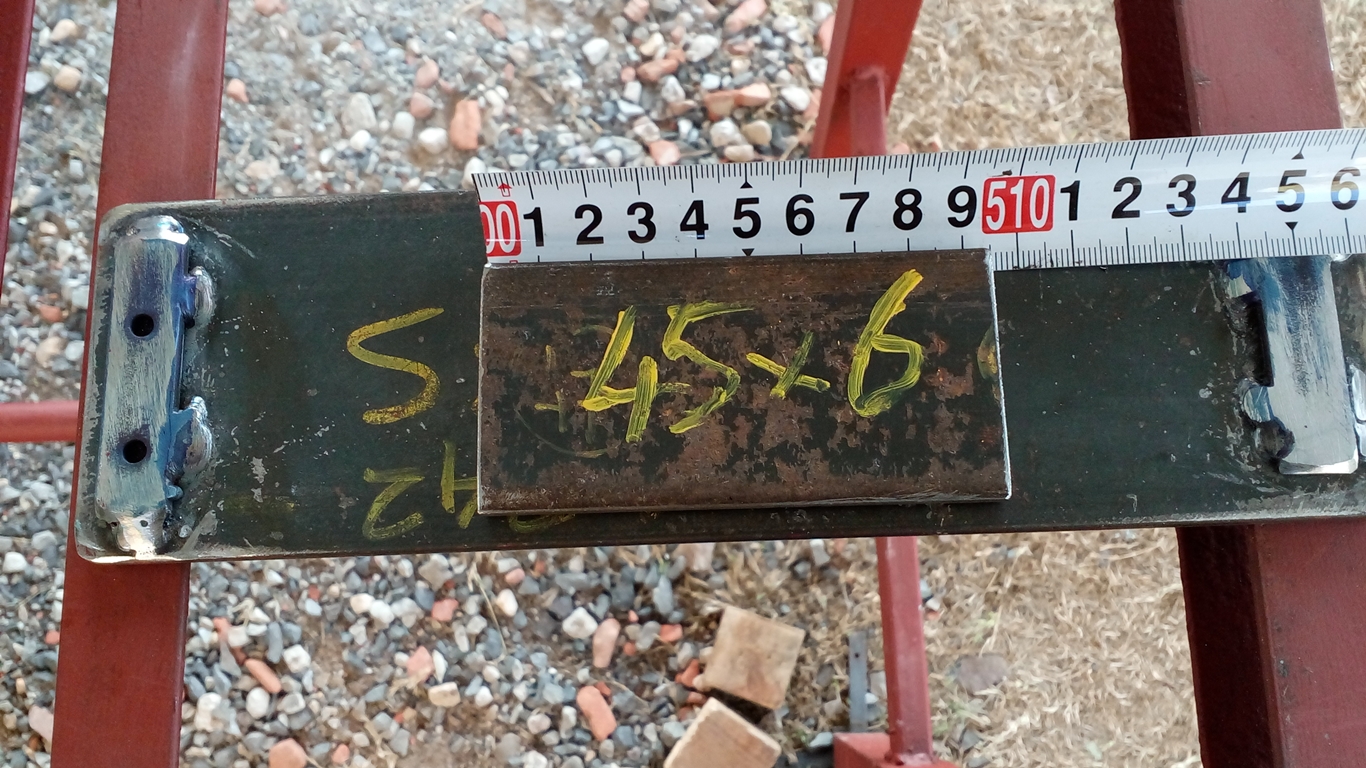

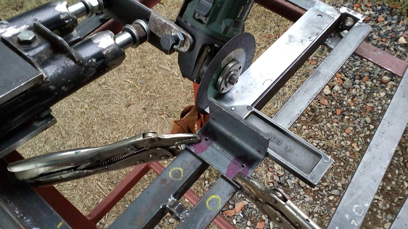

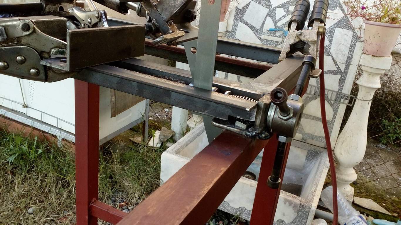

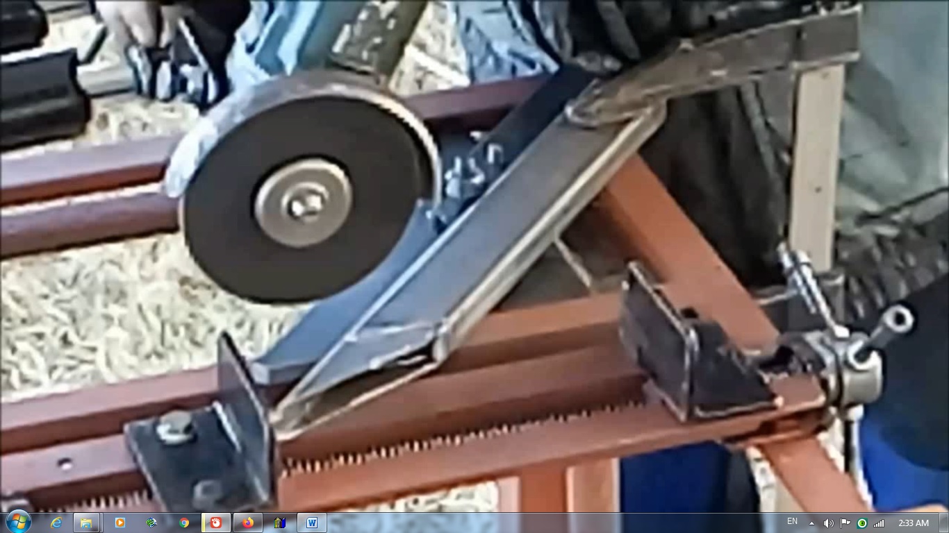

Part3
Cutting Guide Zero & 45 Degrees
https://youtu.be/vBXIOFMUXho
Attachment 32780 Attachment 32781 Attachment 32782

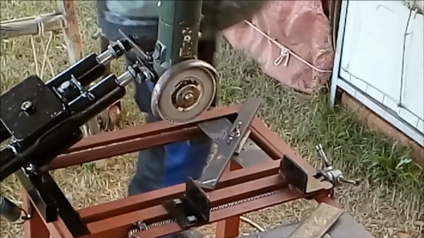

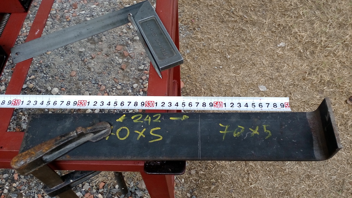

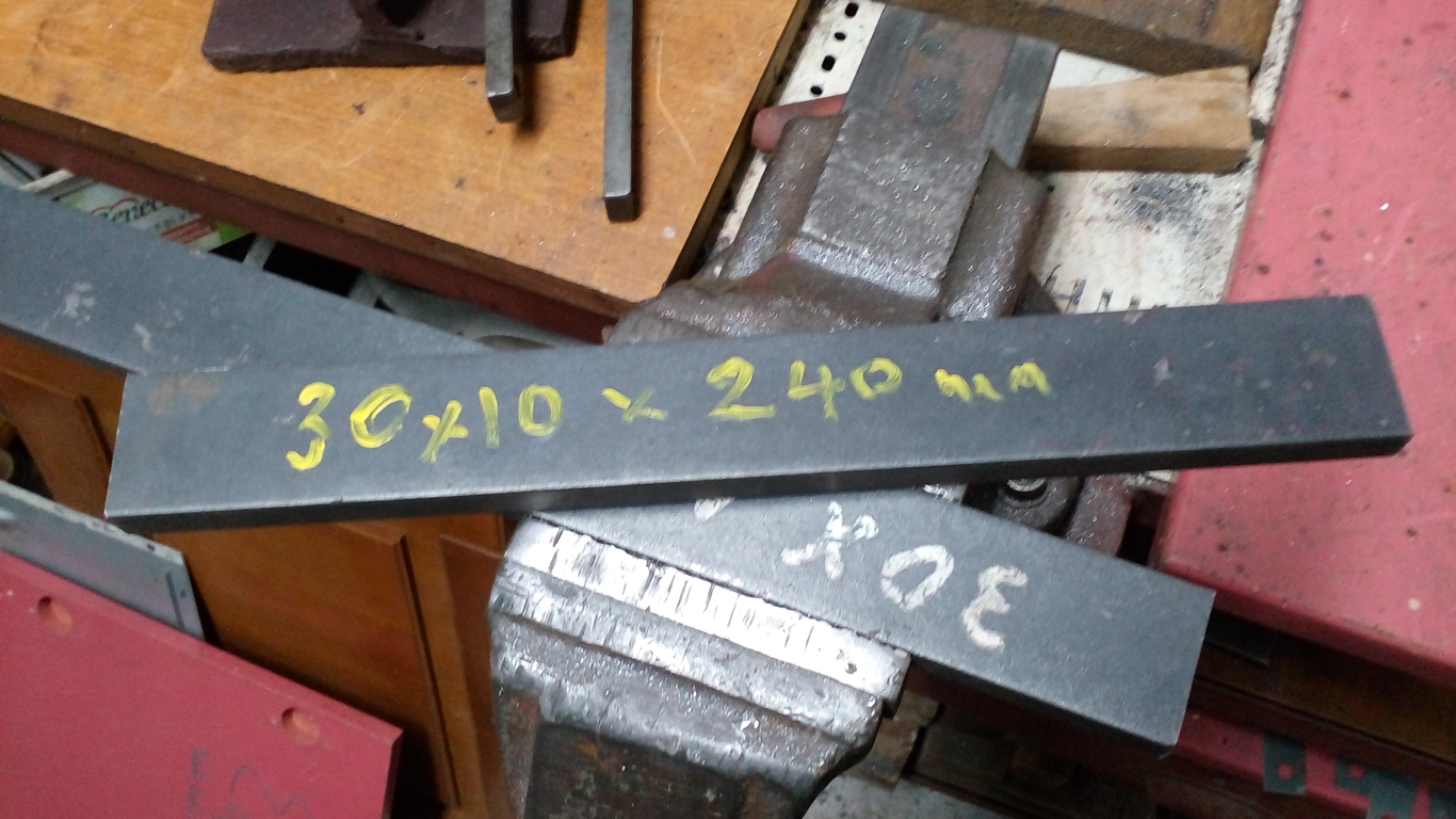

Part4
Different cuts (straight cuts 0° and bevel cuts 45°) with different materials from 3mm to 10mm thick as well as tube 20x40x2mm.
https://youtu.be/N_M8BZLDTd4
