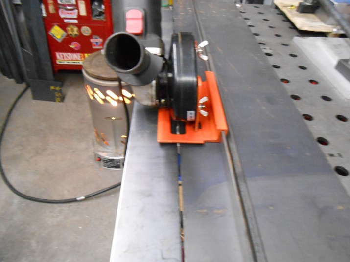

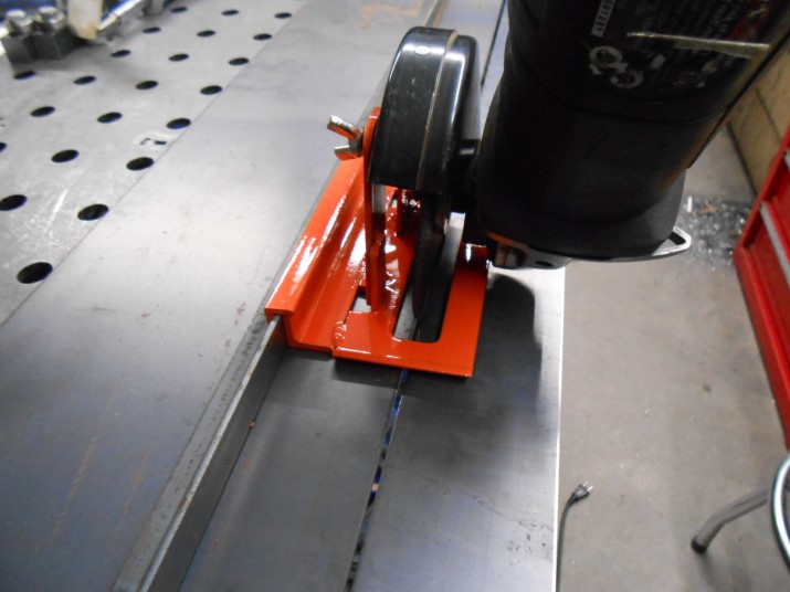

Angle grinder straight edge cutting guide

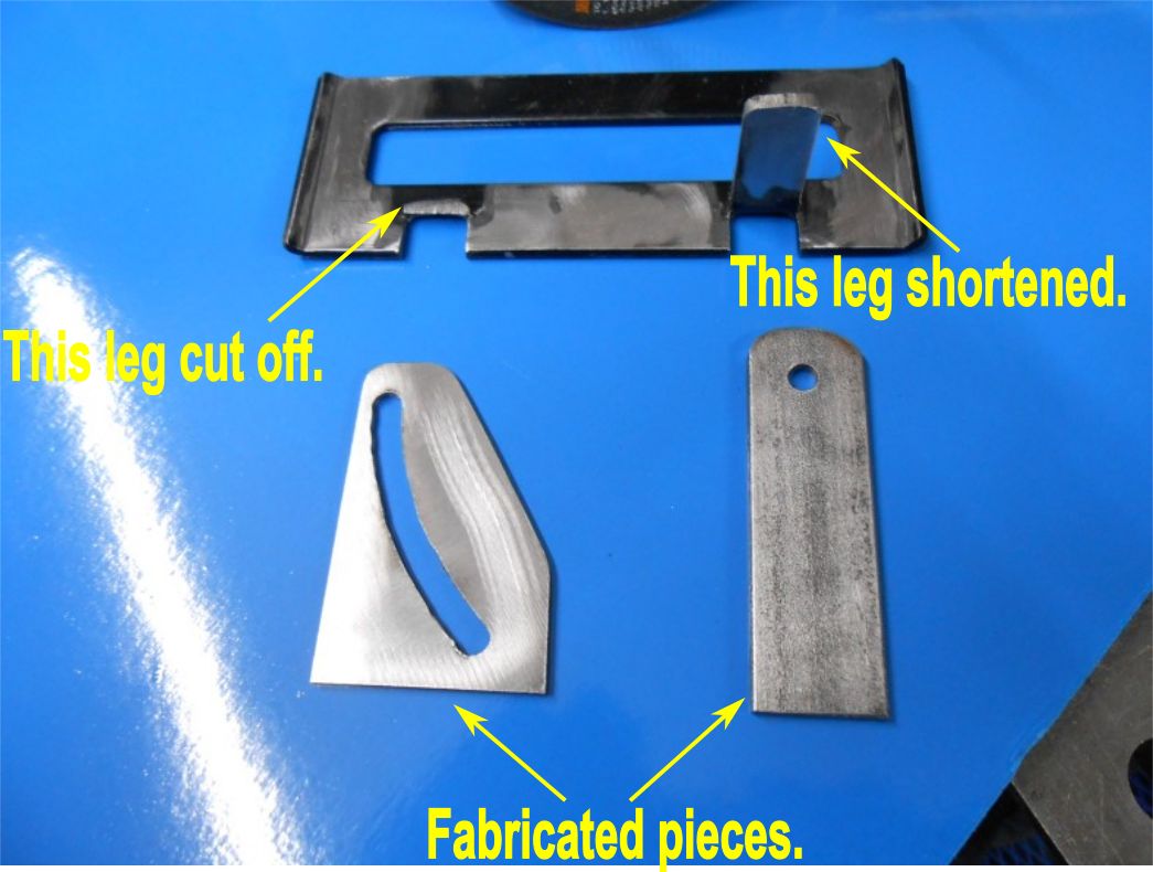

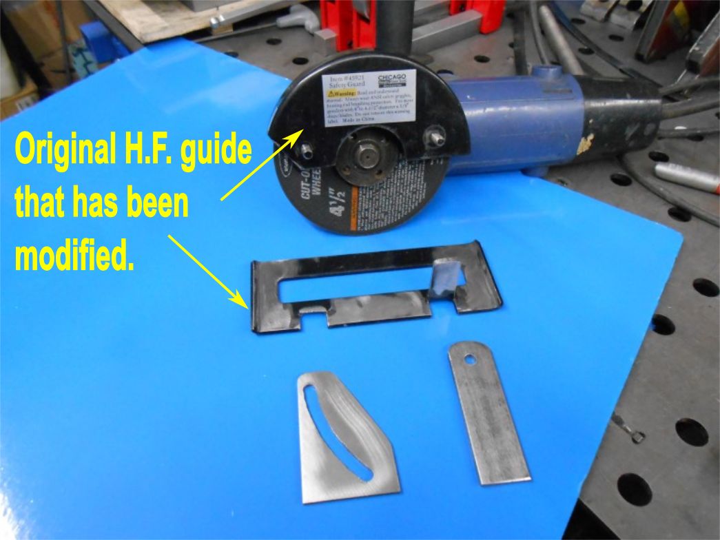

Today's project is an angle grinder straight edge guide that starts off as a modified store bought angle grinder guard. (Harbor Freight angle grinder safety guard 61680)

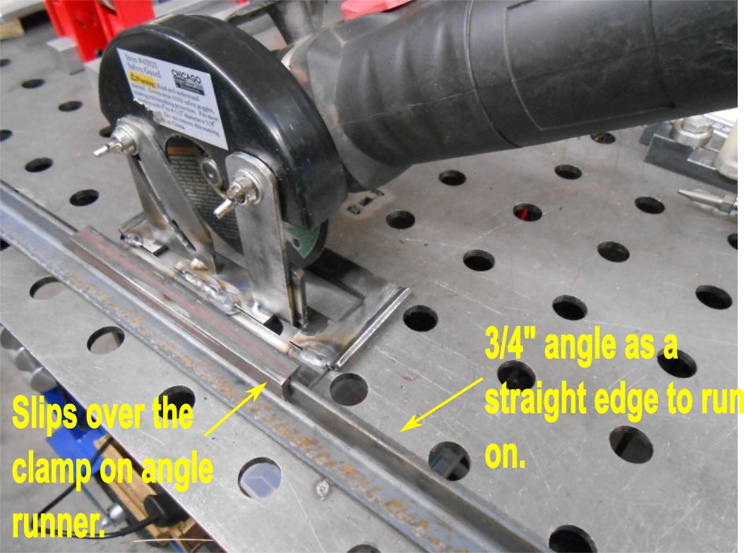

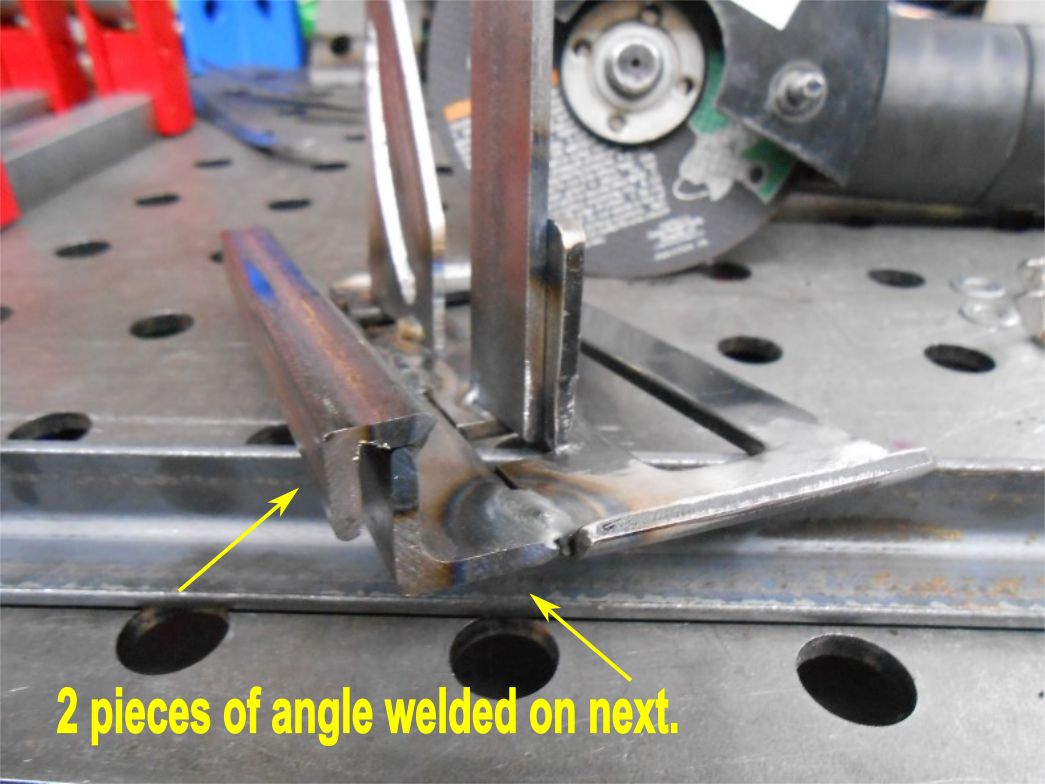

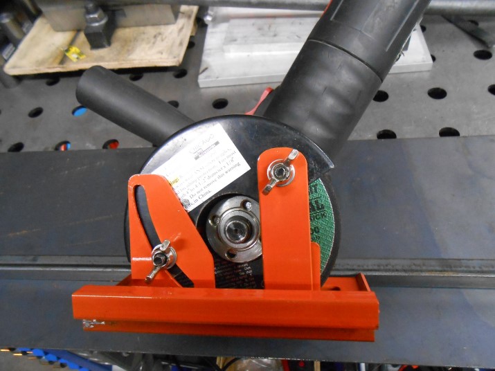

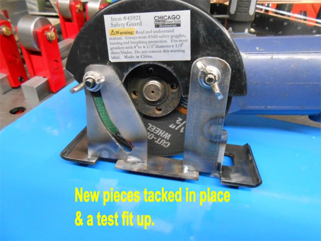

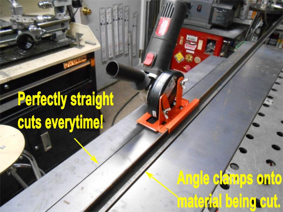

I've had that guard for a few years and never used it because it tended to wander away from the straight edge during cutting. To solve that problem, I modified it as shown. I also improved the cutter depth adjustment so it's much easier to use for gradual depth cuts in thick material.

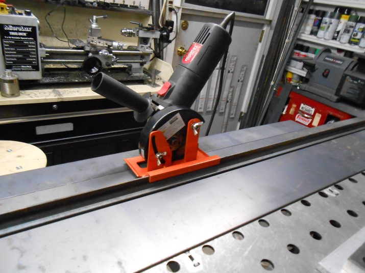

Now you just clamp the 3/4 angle iron guide to the material and the "new and improved" guard rides along making a perfect cut every time. (thick material can be gradually cut in small increments safely) Say good-bye to that dreded wander! ;)
Black angle grinder shown is a Harbor Freight 4.3 amp angle grinder 69645.
