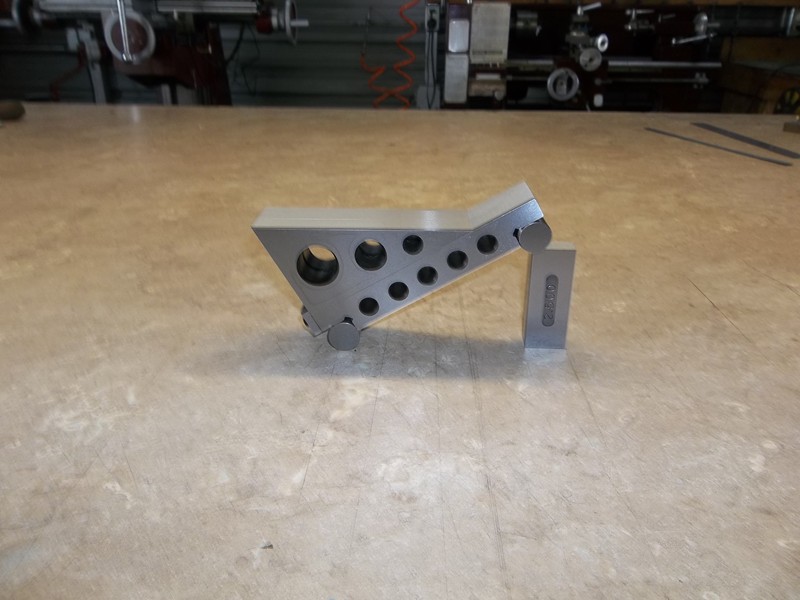

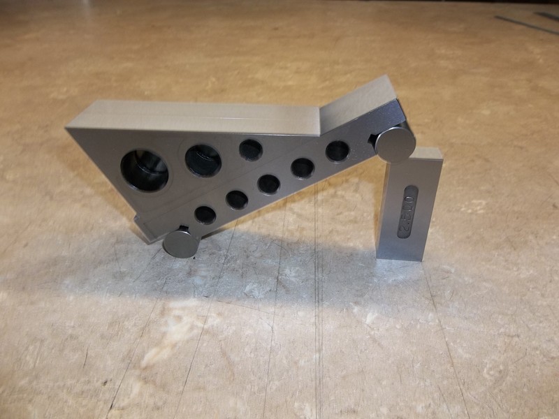

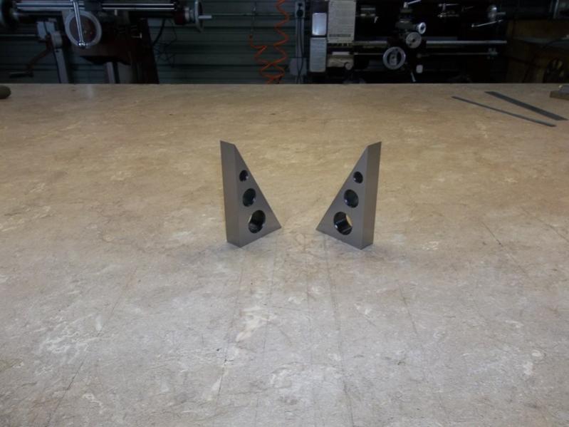

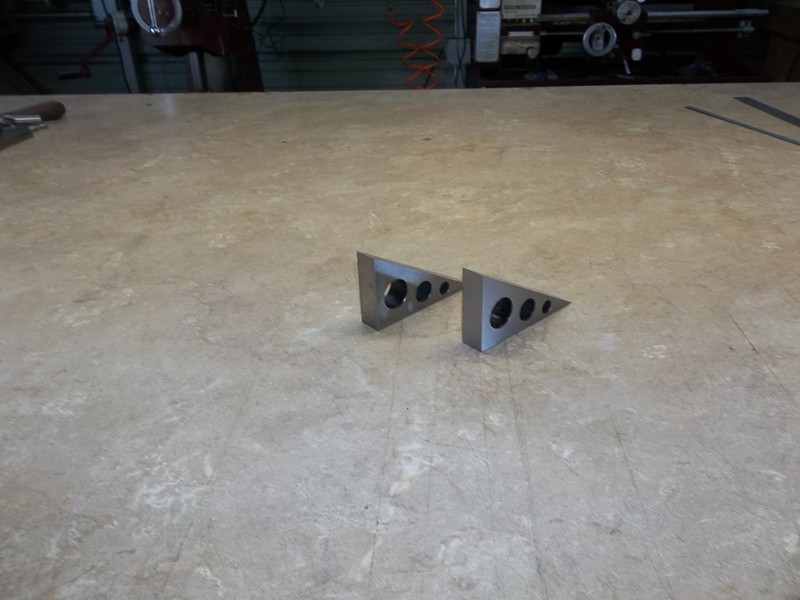

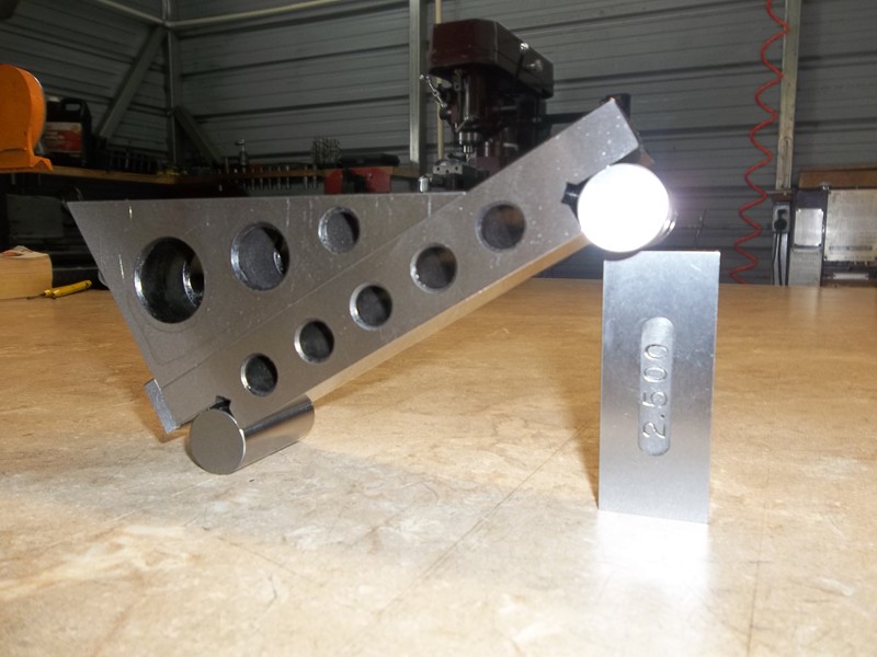

    I have some thin angle plates but they are sometimes a little wibbly wobbly if you know what I mean, So I decided to make some quiet a bit thicker for a little more stability.
    They were made from 0-1 Tool Steel, they measure appr..750" X 2.500" X 4.250" hardened and matched ground to within .00015", that's as accurate as my cylinder square is.
    I ground the 30Deg angle on a 5" sine bar which I made, ( It's posted on Homemade Tools.net as well )
    I made the 2.5000" gauge block to set the sine bar from O-1 Tool Steel. ( hardened and very very carefully ground )
    I'm going to eventually make another pair of plates that's 45-45-90 Degrees ( Same Steel )
    Below are some photos
    Thanks for looking
    And Happy Machining
    Doug
    Click hear for a free set of these plans http://www.homemadetools.net/forum/f...B0-plans-46232

    Above photo shows the plates Sitting on the sine bar

    A little closer yet
