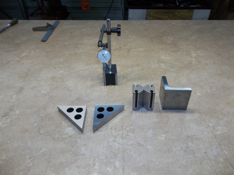

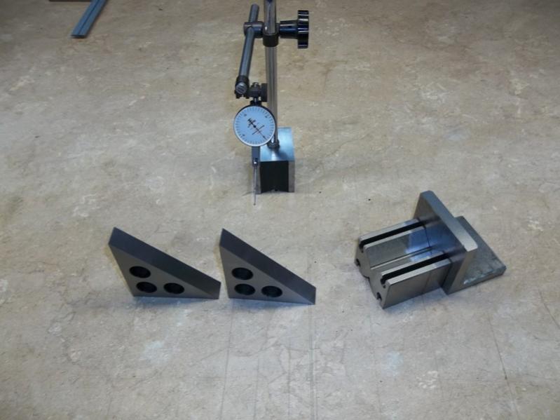

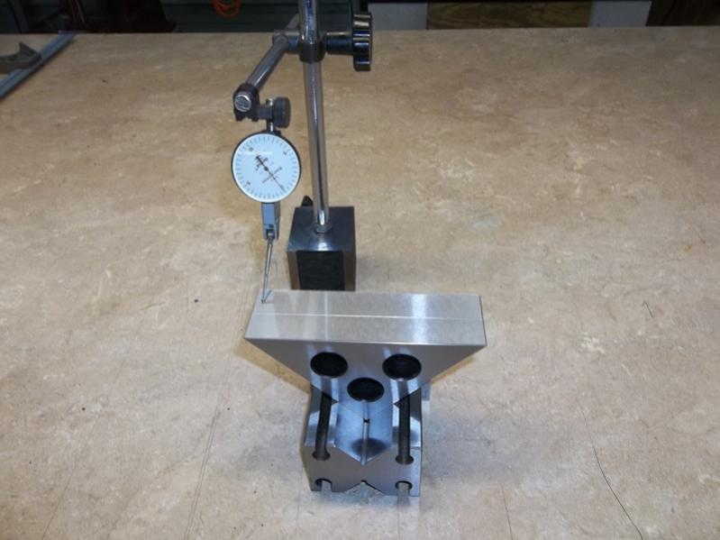

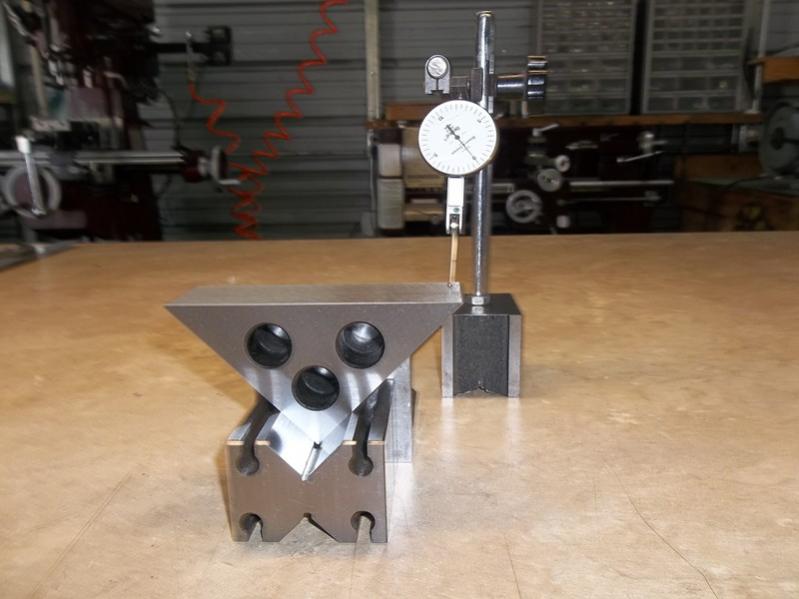

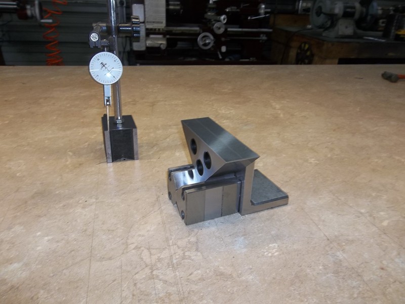

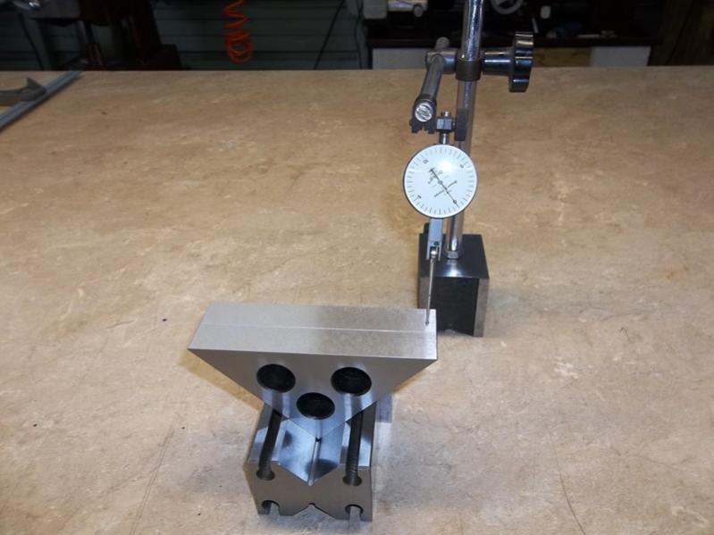

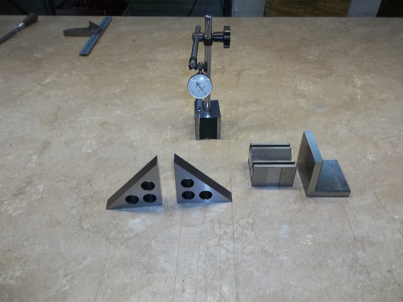

    My recent post was a pair of 30-60-90 degree angle plates, I had mentioned in that post I was going to make a couple of matched 45-45-90 plates as well, So I did
    There made fro 0-1 tool steel hardened an matched ground, there ground within .0002" all over. The plates measure appr. .750" X 3.560" X 3.560"
    Below are some photos
    As always Thanks For Looking
    And Happy Machining
    Doug
    Click here for a free set of these plans http://www.homemadetools.net/forum/f...B0-plans-46232
