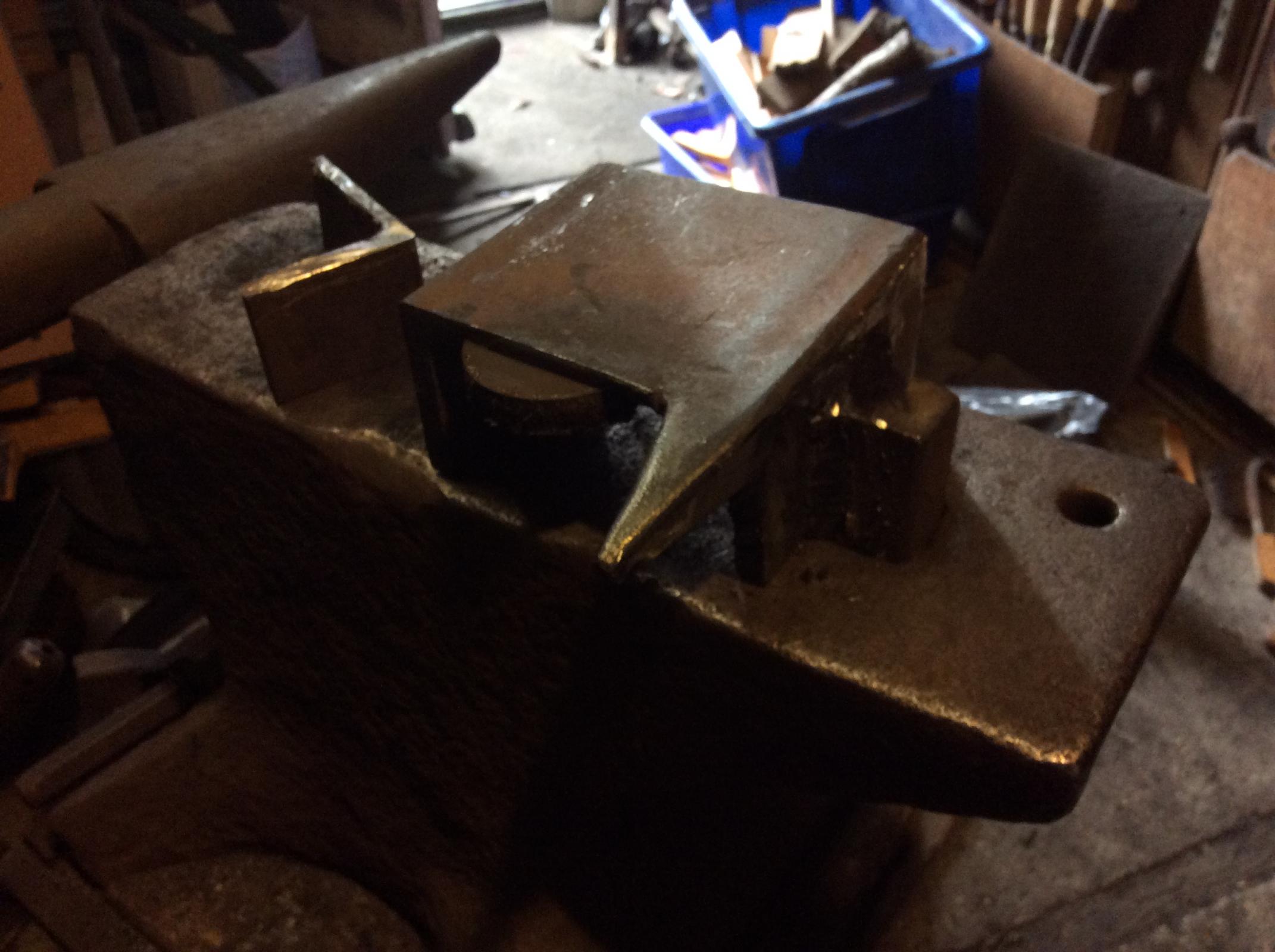

I modified this bridge after seeing a proper one on Pinterest.
Attachment 37973
Mine is made from U channel and yesterday I cut part of it off and forged a bick on it.
This morning I re-welded the stake to the side.

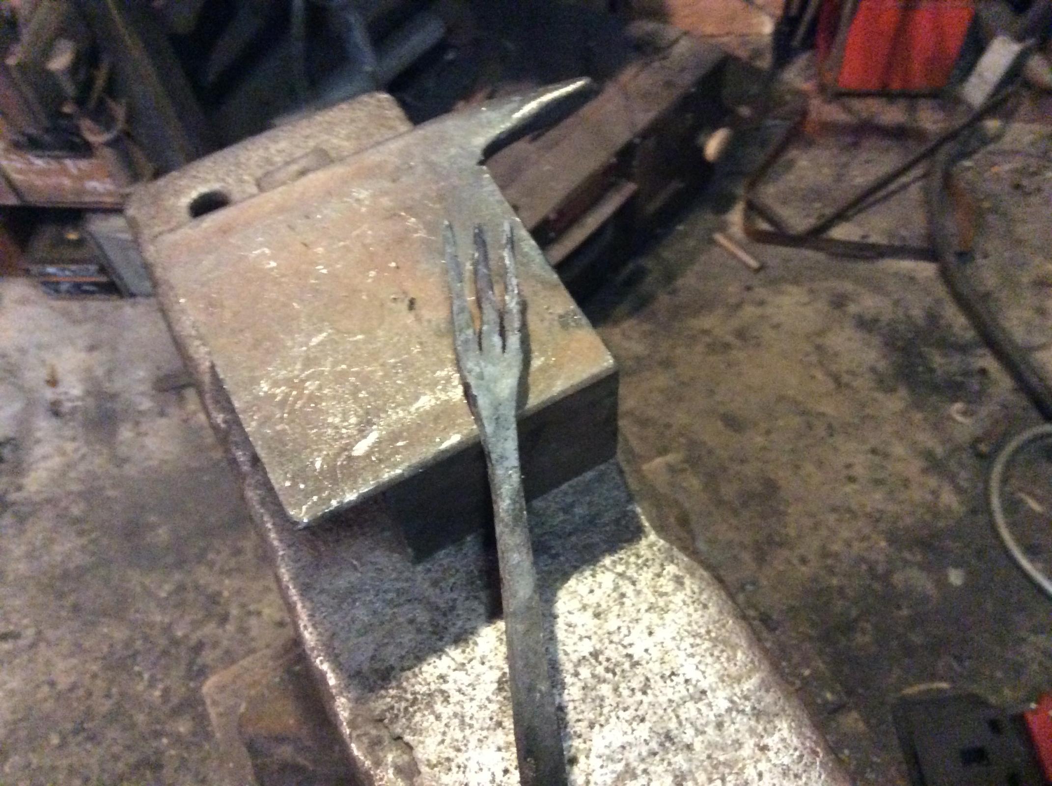

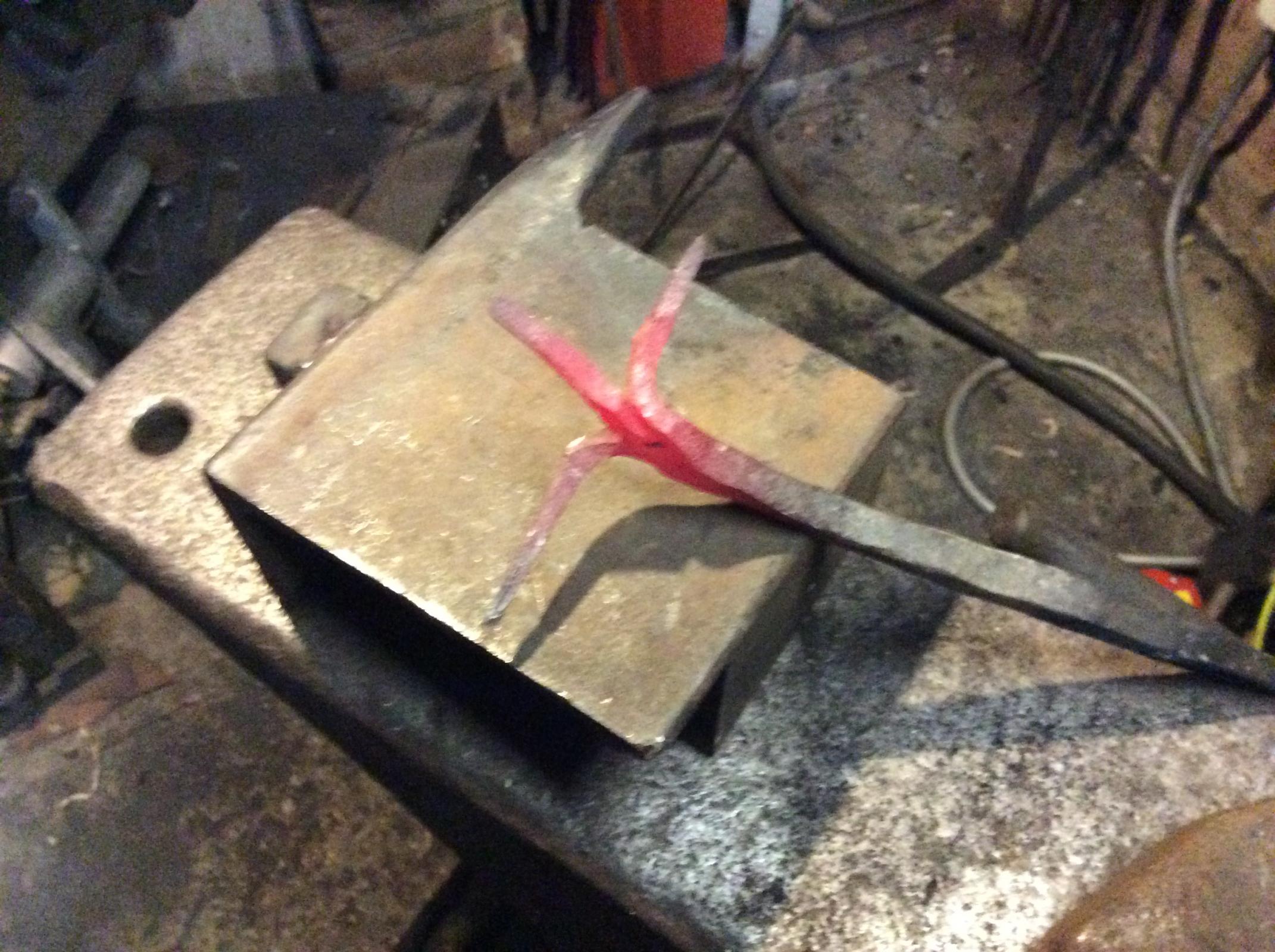

Then I used it to finish forging a fork.(This is a bit left over from the pivoting jaw tongs q.v.)
Attachment 37974
If there are any cutlers reading this, look away now!
Attachment 37975
How many must a Sheffield cutler forge in an hour?

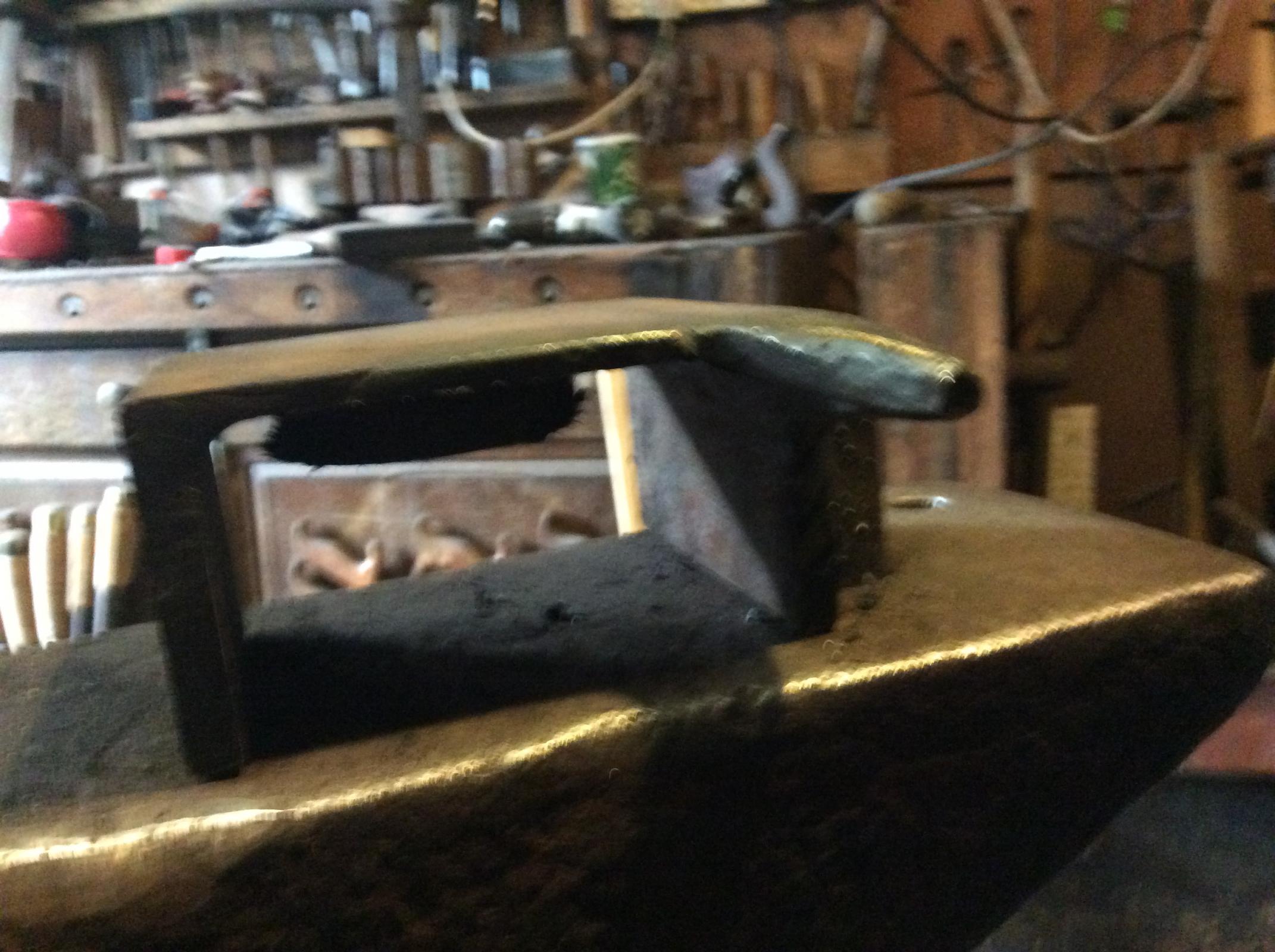

To the left of the fork, the bridge has a cut out, with a bevel below. I thought that this might help if making penny scrolls.
My son wants unusual utensils for his food photography, so this is quite unusual. Whenever I make something with three prongs, it looks as though it would be used by witches, or cannibals.
This accessory is quite discordant on the anvil, and I looked for an old soldering mat to suppress the noise. I didn’t find it,but a magnet helps. (See 2nd picture)
