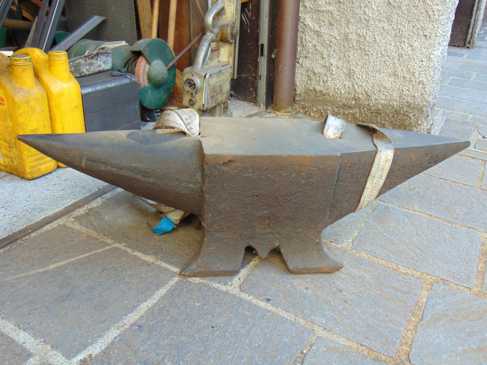

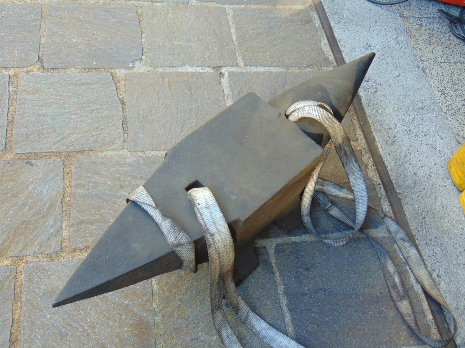

    Hi all
    I found today this anvil, about 150kg. I have to clean from dirt and maybe wash with gasoline?
    I'm thinking about where to put it, I got no space now, and a wood belted stock could be not practical to move.
    My idea is to build a sort of minitable , maybe useful to collect grinders and other tools. 50x50mm tubular, with central column and retractables wheels, what do you think about?

    The best way I know of is to strap the Anvil down to a very large block of wood. That is the way I have seen it done. You need to deaden the vibrations of the striking hammer blows to take best use of the the Anvil and its density. You could build a pipe stand with 3 to 4 inch diameter x 1/4 inch thick pipe walls for legs and a 1/2 inch plate of steel. As long you would fill the legs with concrete that may deaden the vibration some. Depending on the hight use 2 to 3 inch pipe to build the cross members to keep the legs from collapsing side to side.

    I would stick with timber. I use a tree trunk on retractable wheels. Avoid putting on a bench with other tools because of vibration and differing tool height needs. Have fun.

    Maybe a damping material like wood or urethane it's the right choice! It can be also good the idea of a tree trunk with retractable wheels, maybe a steel belt with 3 wheels attached on threaded rods... I have to find a good wood!

    You can do both, a steel base and thick wood platform to anchor the anvil to. I agree with Nick about filling the base legs with something, concrete, sand, steel shot, lead, the heavier the better to keep it stationary. I would not have wheels that stay down, as you will find yourself chasing the anvil around your shop. Try 2 wheels and a removable handle on the other side, lift wheels touch, you move and set it back down no rolling around.

    I tend away from the mini-table. Even when the anvil flat is above other equipment, once parts curve a table top will interfere. Dampening [more correctly eliminating] vibration and resonance is going to benefit by avoiding incomplete metallic contact with the anvil itself. If using a tube pedestal, I'll respectfully offer rammed sand instead of cement, as the latter will absorb moisture, harden and shrink away from the walls. I think the strapping we see anvils anchored to trunks with is likely iron, tightly stretched to bind not just retain. Compressing leather, high hysteresis rubber [tire sidewall], or epoxy compound between anvil and strap seems logical. Run lag screws in an acute angle to strap after forming them, generating a lot of tension in the strap. You have a mill; maybe cut 2 pair of wedges to drive under anvil feet. Because you certainly will need to move it occasionally, non-swivel casters are a great idea, mounted to contact when the whole rig is tilted back. The anvil or removable length of pipe will make a good handle if wheels are perpendicular to the length of it.
