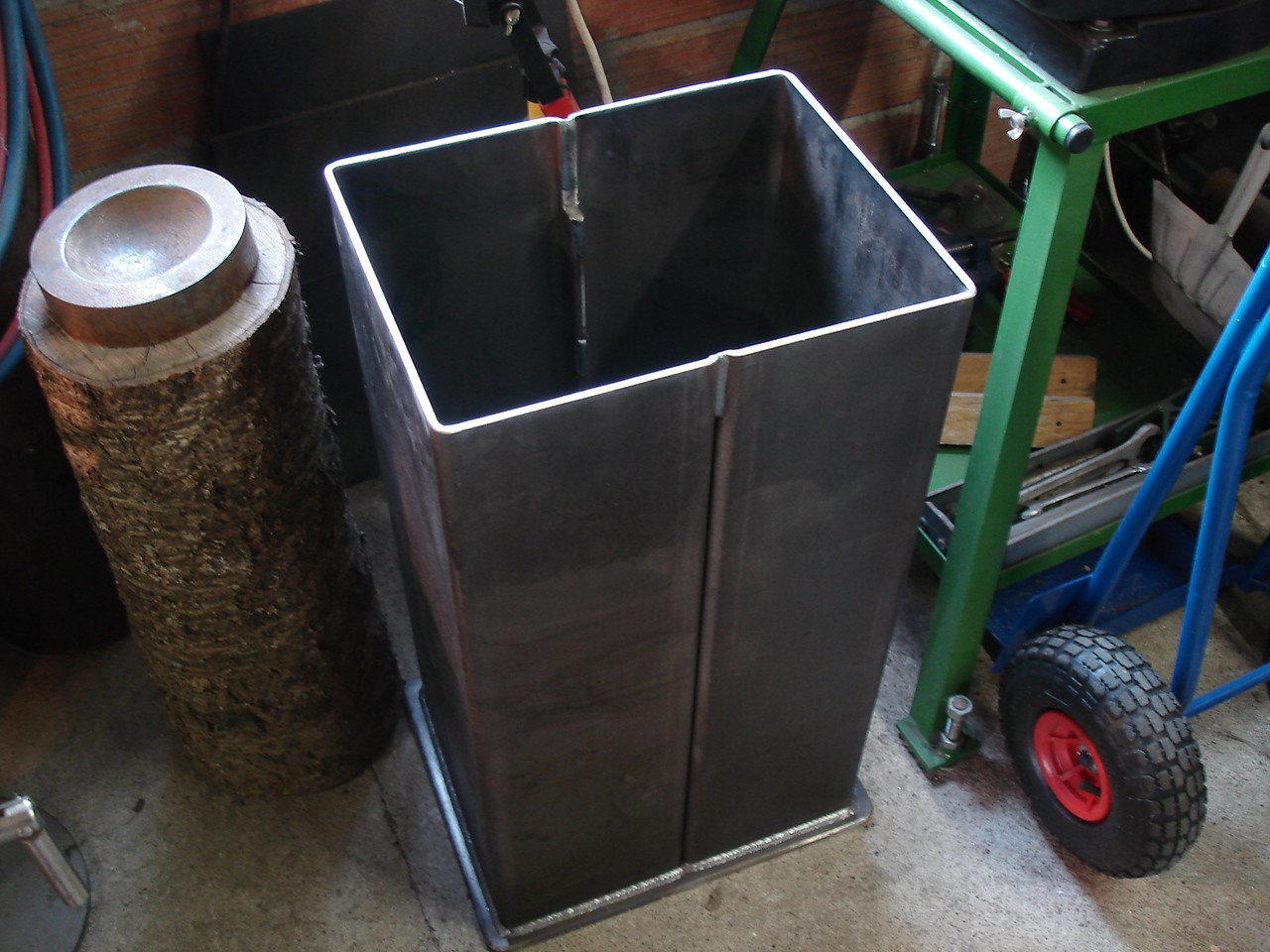

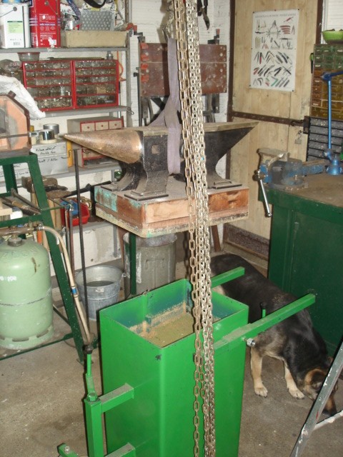

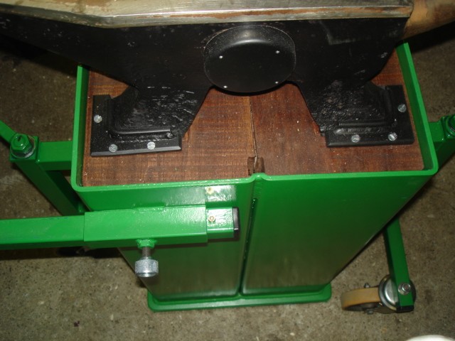

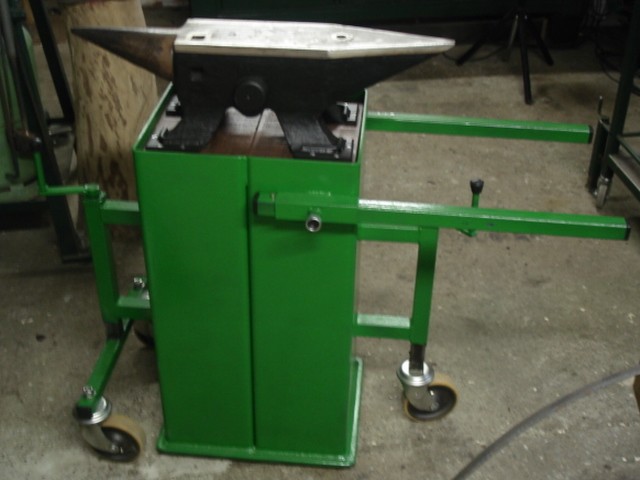

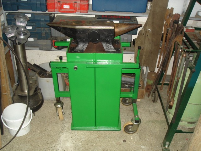

Hello..
Attachment 12691
Attachment 12692
Attachment 12693
Attachment 12694
Attachment 12695
some pictures....the support is filled with sand to reduce noise
