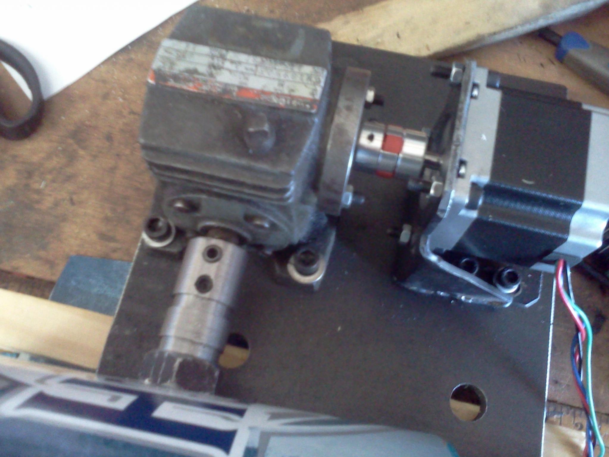

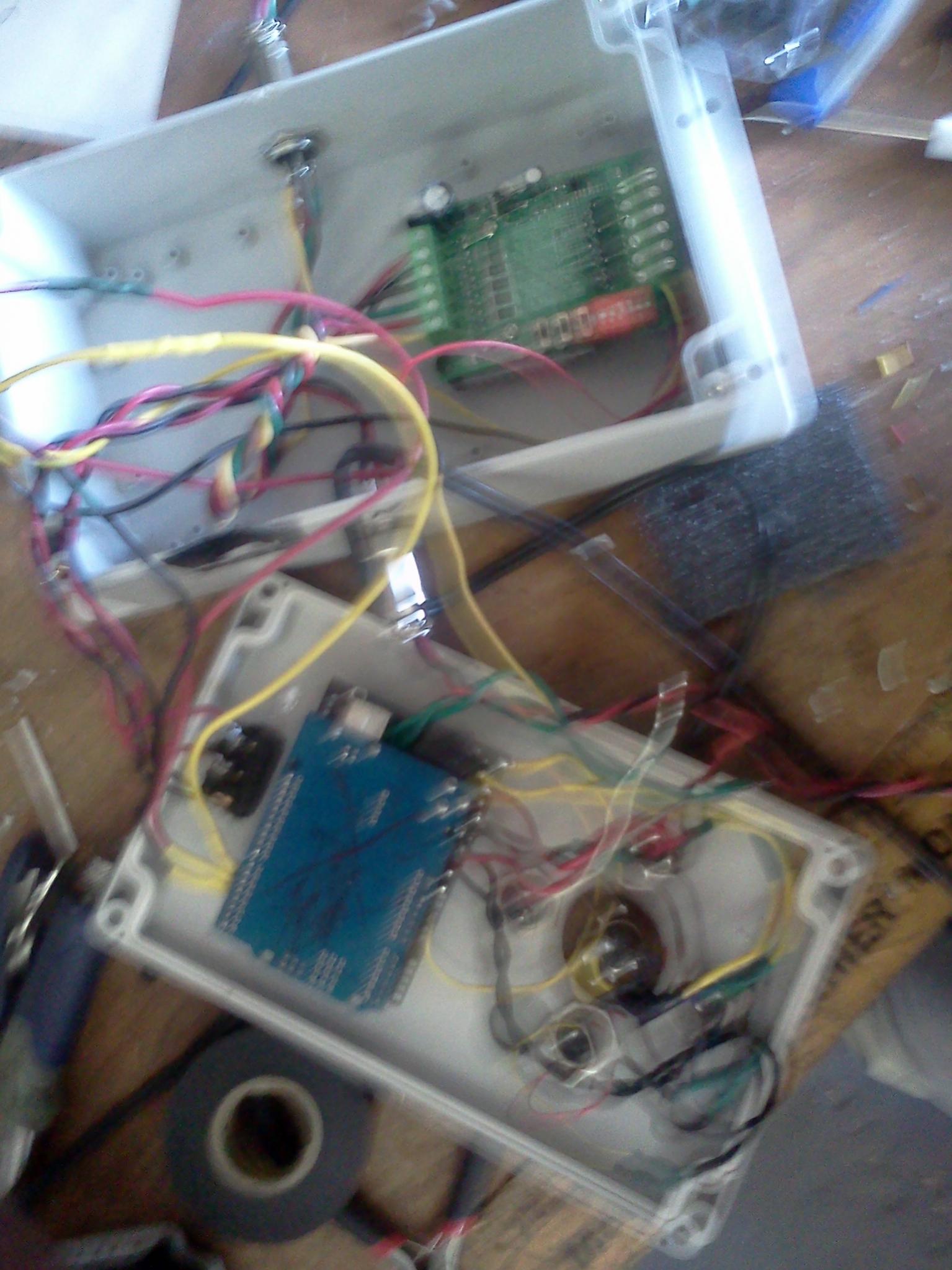

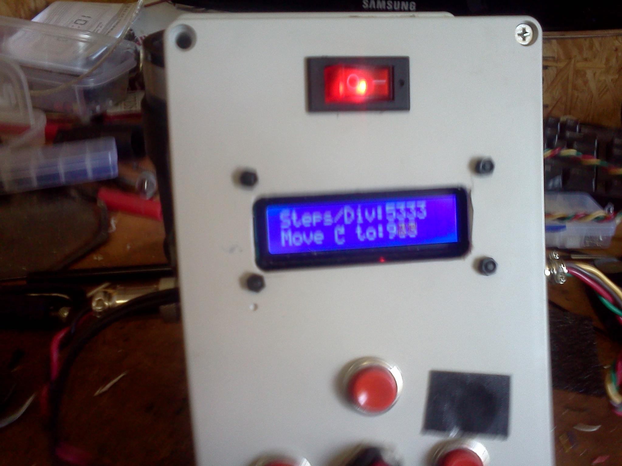

    A year ago I had zero electronics knowledge,I have since built a cnc plasma/router and this indexer. This indexer was pretty simple my biggest challenge was soldering the lead outs for the buttons I have a tremor in my hands making intricate work difficult. Here are some links to sources I used in building the indexer.
    Snailworks Electronic Index Build Log ;https://www.youtube.com/channel/UCNC...zLfyMQmp31DnjA [myfordboy you tube channel]; https://www.youtube.com/channel/UCDG...y8IScMqHHTy9Gg [arduino programming electronics academy] I took their short intro course to get a basic knowledge of how to program. I used Gary Limings' sketch[program] to run it. Don't be intimidated you will enjoy the process. You can email me with any questions. jensen.neil52@gmail.com

    Not an option,had to solder to pin on back of led. the rest of the soldering not too bad just had to time my shakes lol.

    I hope you will post when you are done. I set up on the mill today and going to cut some AL in the AM to see how accurate it is.
