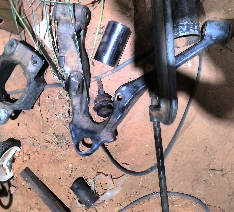

To replace the lower ball joints I needed some special tools and had to make a unique set up to press them out

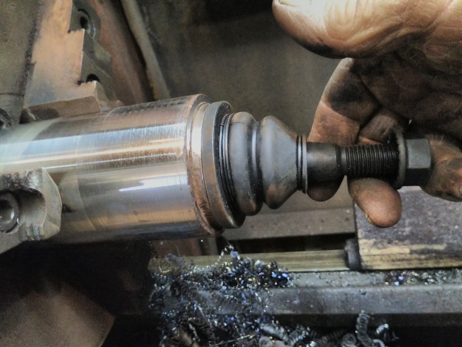

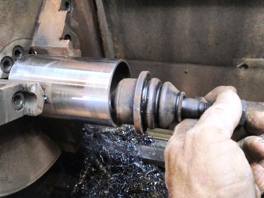

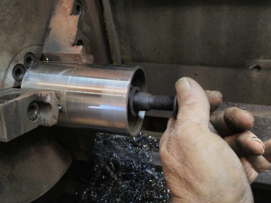

I started out by cutting the coupling from a piece of 2 3/8" oil field tubing
Attachment 45362

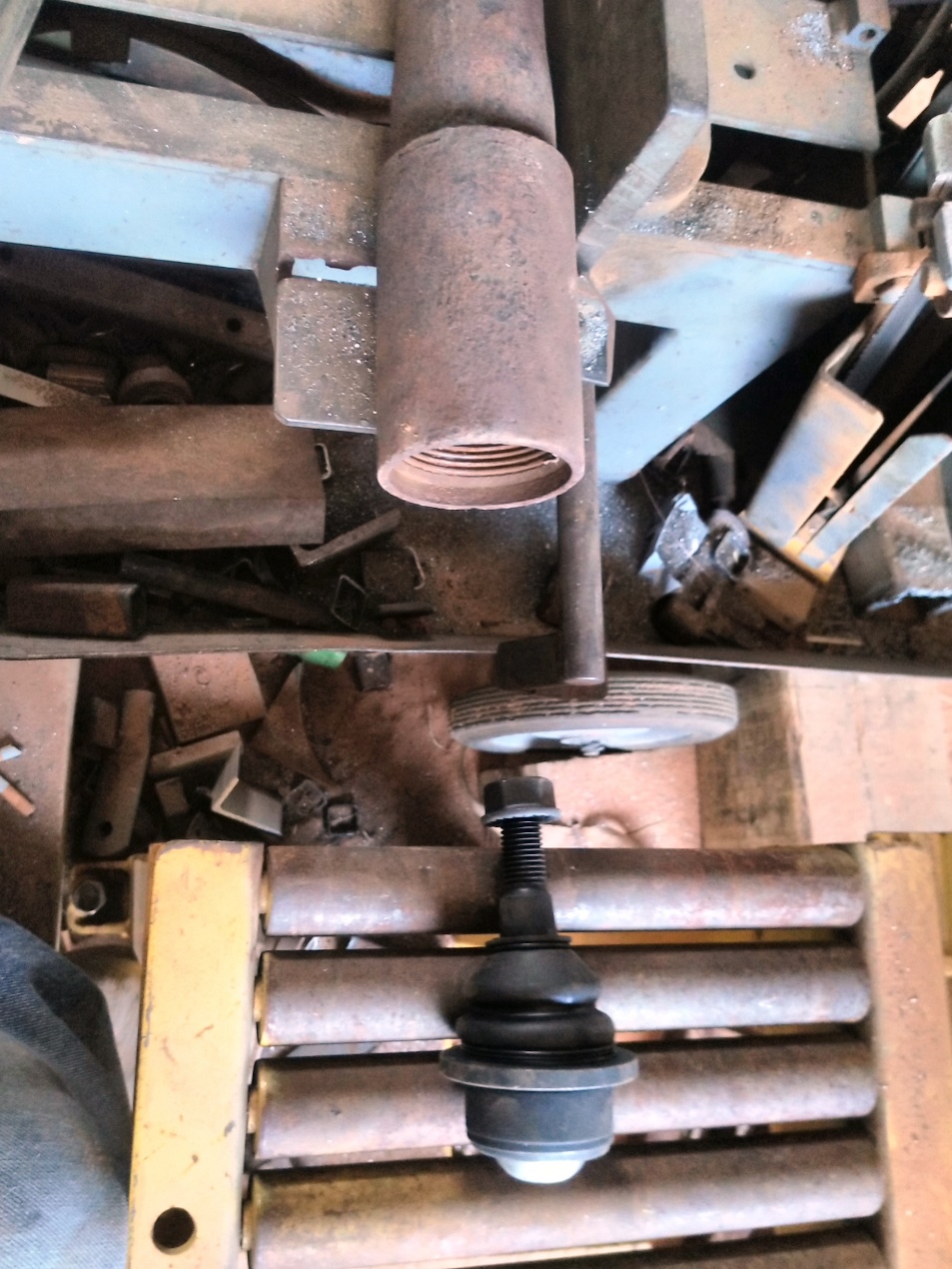

Then machined the threads out of 1 end to fit over the flange of the ball joint.
Attachment 45363
Attachment 45364

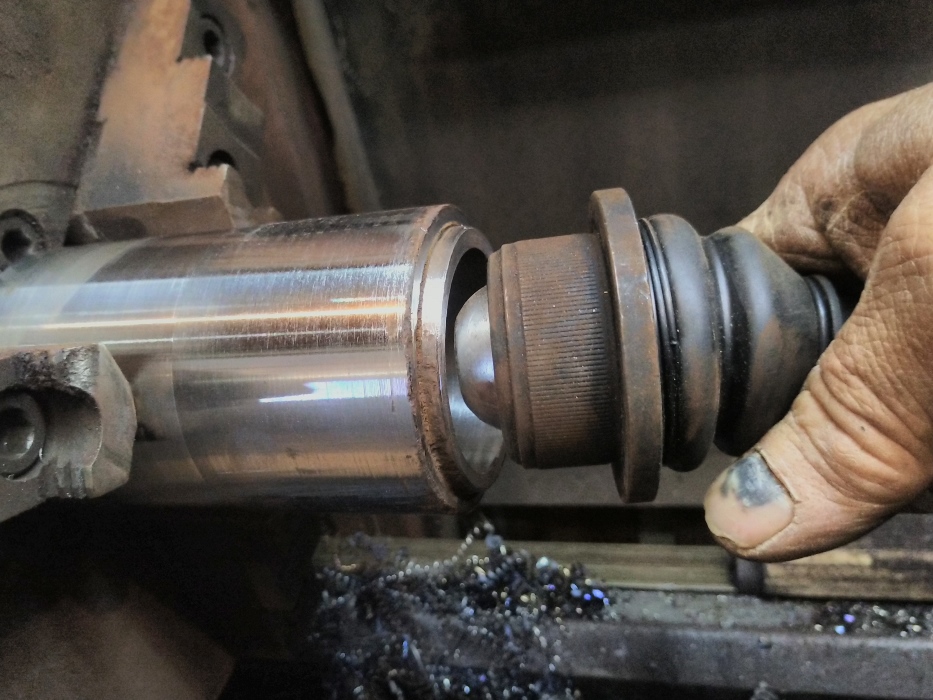

Then machined the Id of the tubing stub to fit over the od rubber boot this is also the same diameter as the boss that presses into the control arm
Attachment 45365
Attachment 45366

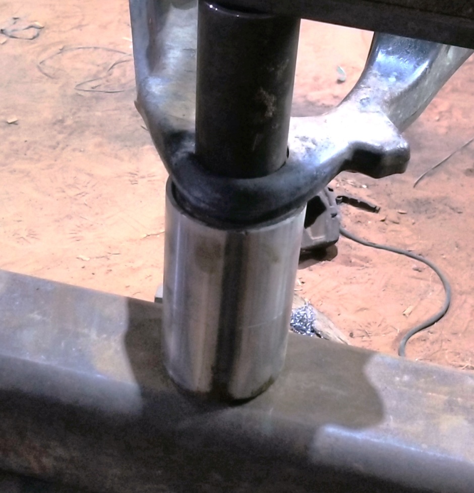

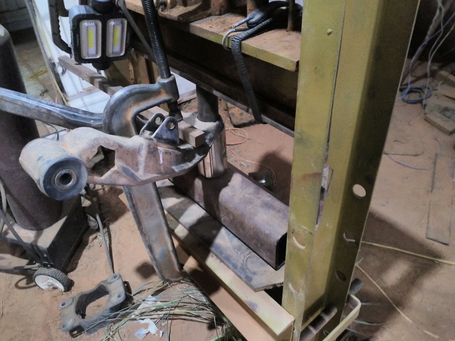

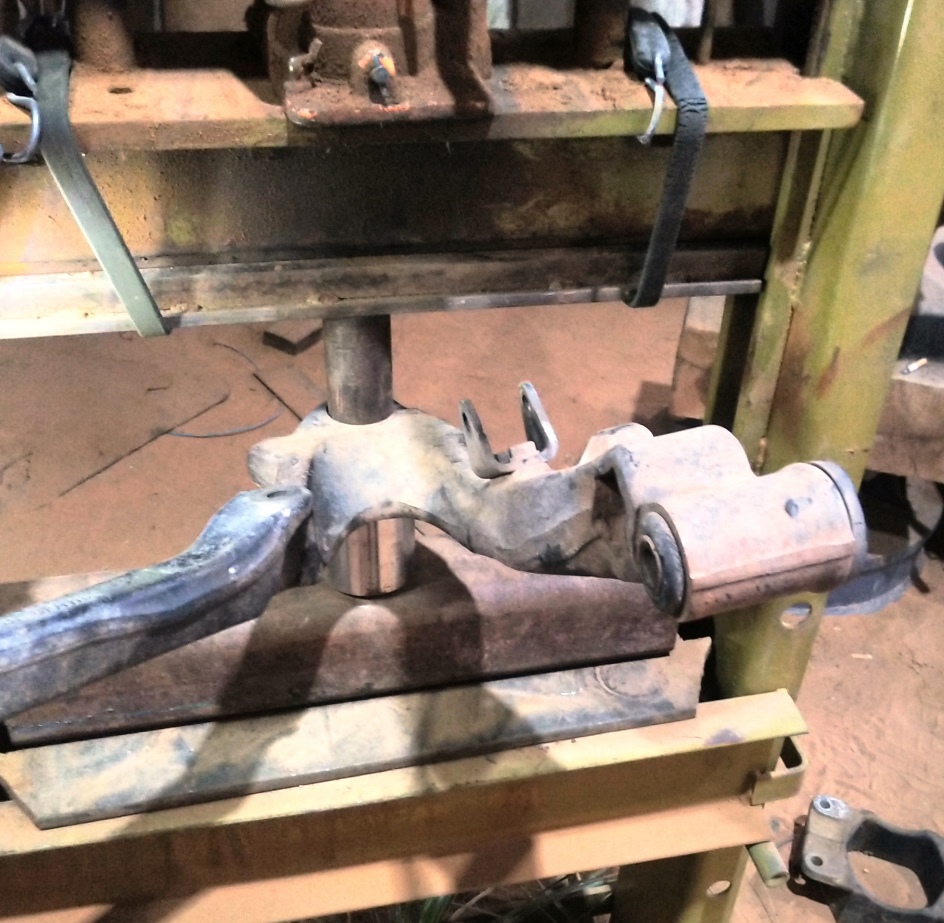

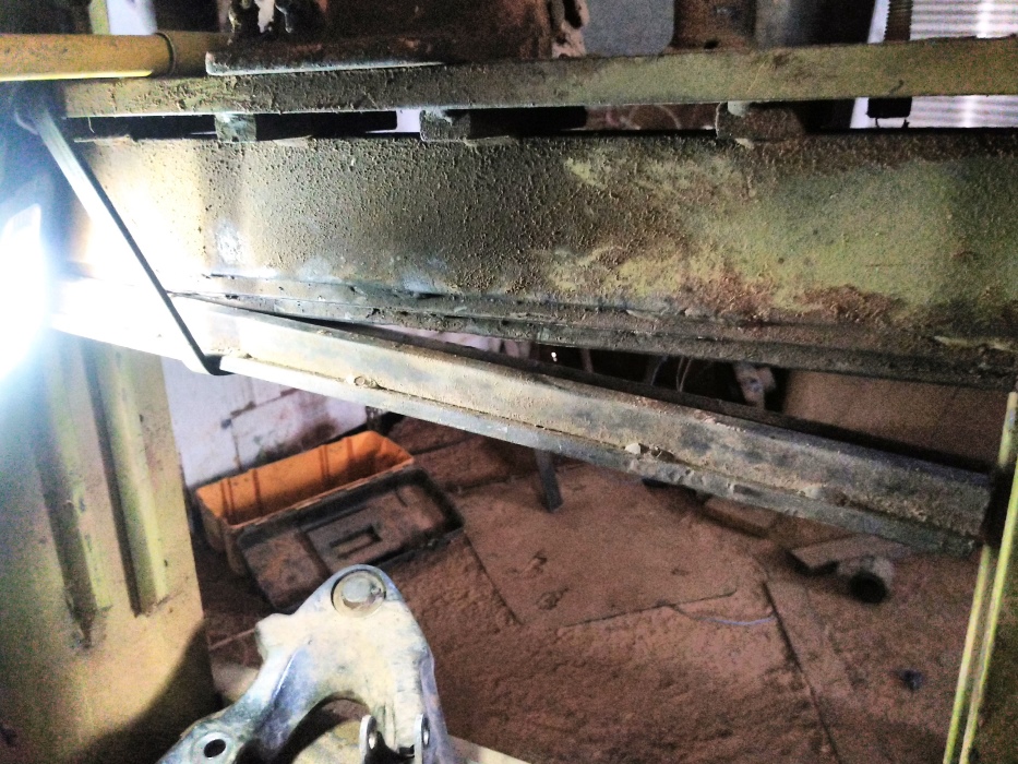

Next comes the set up. since I have a metal break punch permanently mounted to my shop press I suspended the bottom die under the punch with rubber tarp straps so I would have a flat pressing surface
Attachment 45367
After getting everything aligned up and ready to press the ball joint out
Attachment 45368

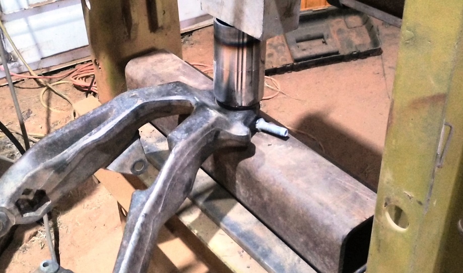

I noticed that the arm did not have a flat surface around half of the ball joint flange
Attachment 45369
I needed a way to keep the arm from cocking up on one side to do this I used my 16" heavy duty C clamp to hold it down
Attachment 45370
Maxed out the 8 ton hydraulic jack added just a little heat and this is the position everything wound up when the ball joint slipped out of the control arm
Attachment 45371
pressing the new joint in place only required the tool and a simple 1/2" cylindrical spacer under the arm
