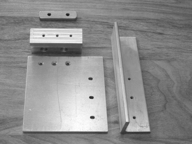

I found a piece of 1.5 x 1.25 aluminum bar about 4.5 inches long, a piece of 5.5 x 6 x ¼ aluminum plate and a piece of 2 x 2 x ¼ aluminum angle.

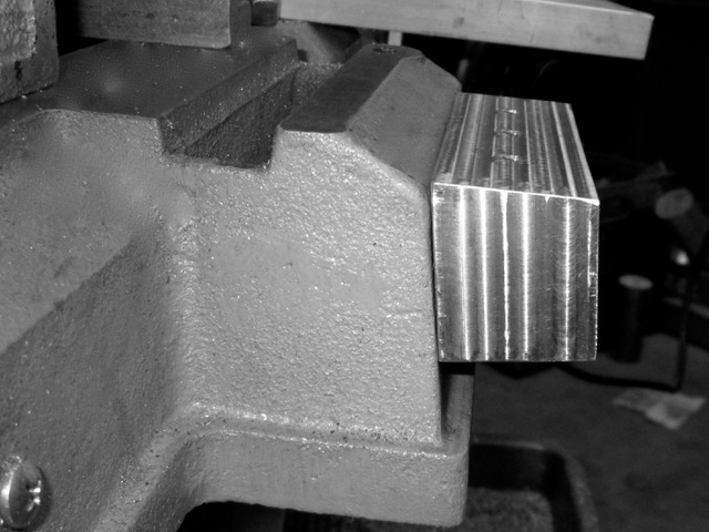

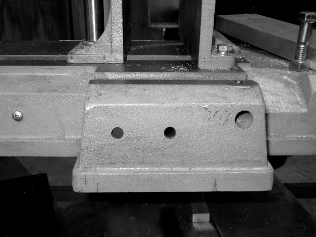

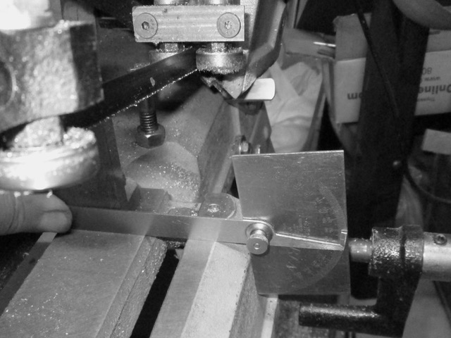

My saw has a small ground area on the out feed side of the blade. The first thing I did was to measure the angle between the ground surface and the unground casting.
Attachment 34907

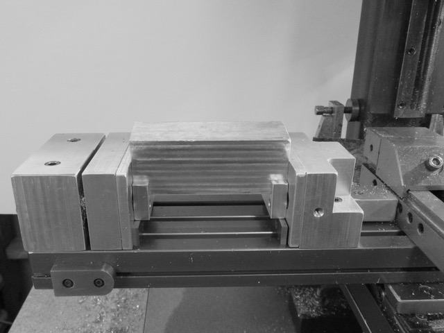

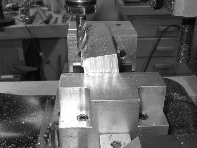

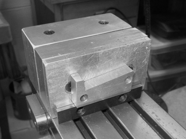

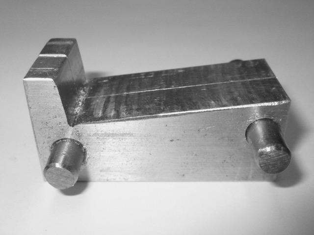

Then I made a pair of angle bars to that angle, and cut the top surface of the 1.5 x 1.25 bar to match that angle. (See link below.)
Attachment 34908
Attachment 34909
Attachment 34910
Attachment 34911

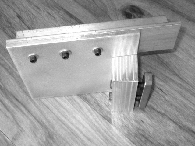

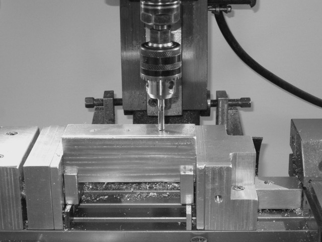

I used the angle bars again when I drilled and tapped the holes for the table.
Attachment 34912
I used small slots to mount the angle iron (aluminum) to the new table so I could make any adjustments to align it with the fixed vise jaw.
Attachment 34913
Attachment 34914

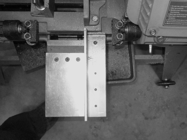

To align everything up, I clamped a bar in the saw vice, then clamped the out feed table to the bar.
Attachment 34915
Once I was satisfied everything was in alignment, I used a transfer punch to carry the holes from my new base to the cast iron of the saw.
Attachment 34916
Attachment 34917
Attachment 34918

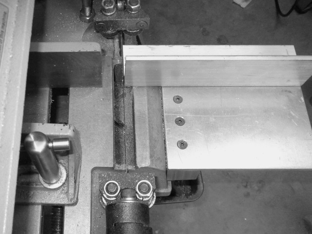

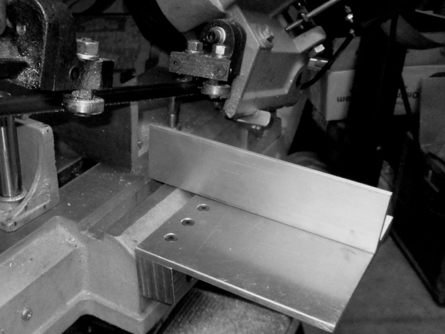

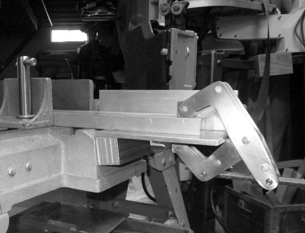

One thing I did not anticipate was to provide access to the set screw for the built in cut off gauge. I rarely use it, but I thought I should still drill an access hole. This is visible on the next picture.
The new out feed table precludes me using the factory stop block for anything less than 7 inches from the blade, but it will work if I need it for longer pieces. I am considering a stop block to fit on the fixed jaw extension, but most of my work is one off pieces, so I haven’t done that yet.
With everything mounted and aligned, the final step was to cut the aluminum angle to length. This close fit seems fine now, but it may become an issue when I install a new blade or if the current blade gets knocked out of alignment. It would be an easy task to file it back a bit.
Attachment 34919
Attachment 34920
