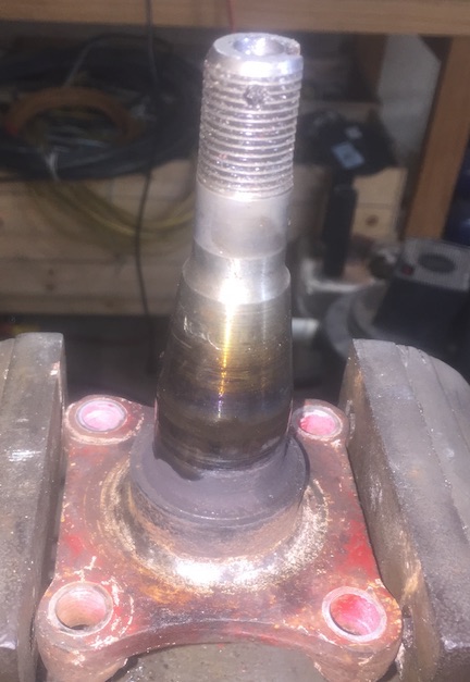

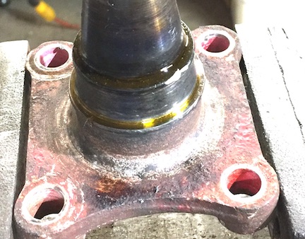

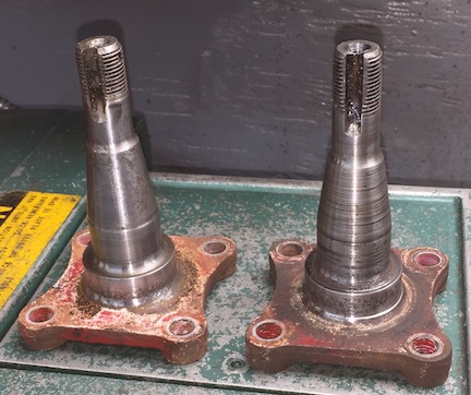

    I had a bearing failure on a trailer which which damaged the hub (Trailer Wheel Hub Repair)
    and left the cone stuck on the spindle.
Name:	01 stuck brg.jpg

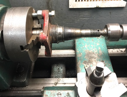

    I had an idea I might be able to cut the cone off with a carbide insert.
    Not a good idea, but, you live and learn.
Name:	02 attempted cut off.jpg
    My bearing puller does not have enough reach for this job. Even if it did reach,
    I am not confident it would be able to grip the rounded edges of the cone.
    I do not have a bearing splitter. Every time think I might really need
    to get one, I find another solution.

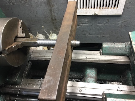

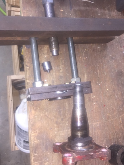

    I still have the main bar of a puller I made almost 60 years ago in high school.
    The screw and fingers have long been converted into something else. I do not
    even remember what. I have been using the heavy steel bar with the magnetic
    base for my Dial Indicator
Name:	03 main bar.jpg

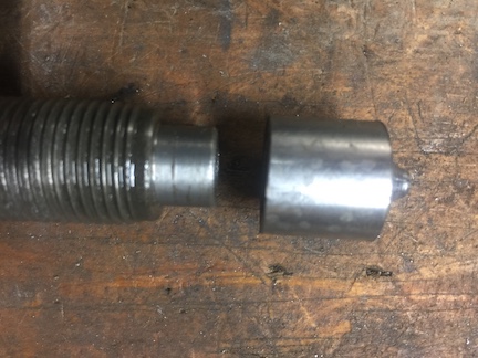

    I tuned a new 3/4-16 screw from some 7/8 hex bar. This one turned out better
    than the one made from 1” square in high school. The new one also has a removable
    end cap to protect the screw threads and whatever shaft it is using on.
Name:	04 new screw.JPG
Name:	05 puller screw and cup.jpg

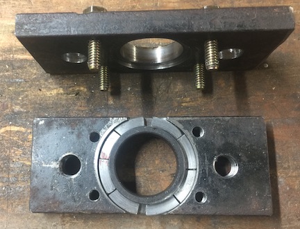

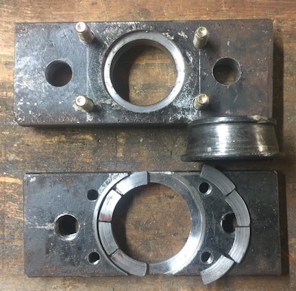

    To grip the bearing cone a base plate is bored to just slip over the cone. A recess cut in
    the plate allows retaining segments to slip under the bearing lip and prevents them from
    being pushed out. The large hole in the base makes it too weak to apply much force without
    bending. A top plate is bored to just fit over the spindle and drilled to bolt to the base.
Name:	06 puller parts.jpg

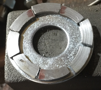

    The retaining segments were made from a washer. It was first bored just large enough
    to allow my 3 jaw chuck to hold it internally to turned the OD to fit the base groove and
    faced to proper thickness to fit snug under the cone lip. Then held on the OD to bore
    the ID to fit snug under the cone lip. That ring was then segmented on the bandsaw.
Name:	07 segments from  washer.png
    The base fits over the cone. Shown here after being removed
    from the spindle for clarity
Name:	08 segments and base.jpg

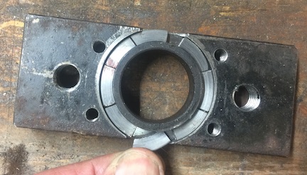

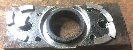

    The retaining segments slide into slots on the side of the
    base and fit snug under the cone lip.
Name:	10 sements inplace.jpg

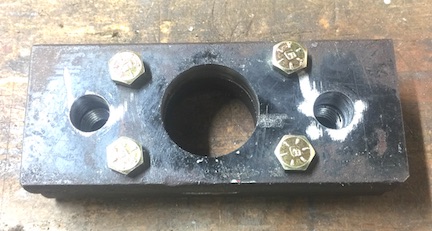

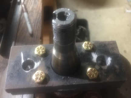

    The top reinforcing plate bolts over the base. The holes were match drilled.
    The base is tapped for both the small bolts and the large pulling bolts.
Name:	11 puller plates together.jpg

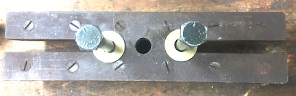

    In use the puller bolts are threaded into the base until nuts tighten down onto
    the reinforcing plate. This makes the plate assembly more rigid to reduce the
    bending force at the center where the plates are the weakest.
Name:	12 puller assembly.jpg

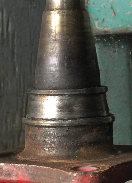

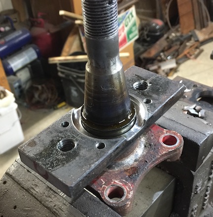

    The spindle had been soaking with some PB blaster
Name:	13 Stuck bearing.jpg
    The base plate over the cone.
Name:	14 base on BRG.jpg
    After sliding the segment into the slot, the reinforcing plate is bolted on.

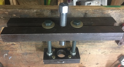

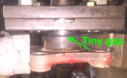

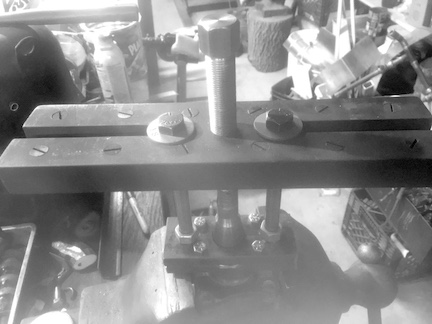

    The puller bolted in place ready for the pull.
Name:	16 Puller ready.JPG
    It took a bit to torque, but eventually I heard a POP sound. You can never
    be sure at first what made that sound. Peeking under showed a tiny gap forming.
Name:	17 puller on spindle.jpg
    After the initial pop, it was not difficult to pull it off the rest of the way.
Name:	18 BRG removed.jpg
    The puller and parts
Name:	19 spindle bearing removed.jpg
    The cleaned up spindles. Waiting for speedi-sleeves for the seal surfaces.
Name:	20 spindles.jpg
