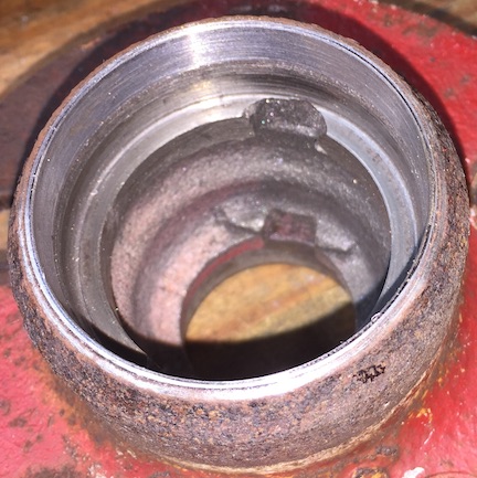

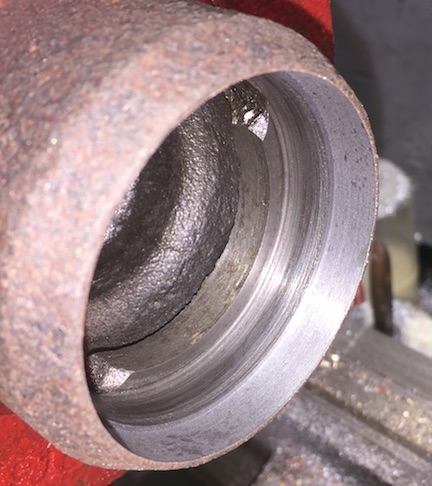

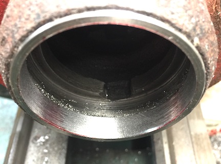

    To begin the repair it I bored the damaged area, where the seal fits.

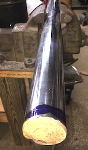

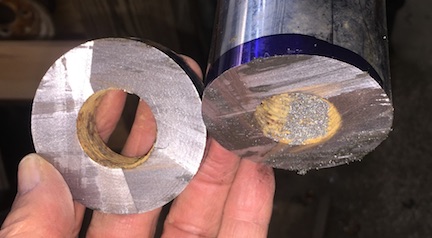

    I have had a broken rod from a hydraulic cylinder around the
    shop for over 40 years. Too nice a piece of steel to sell for scrap.

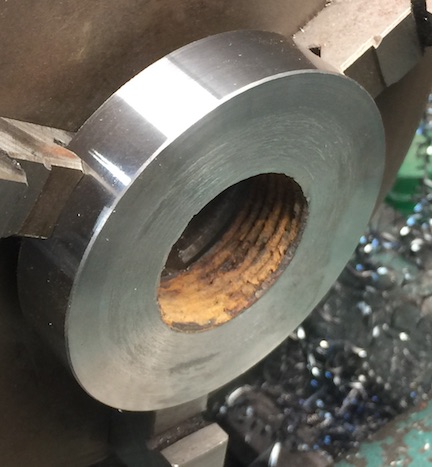

    The seal end already had a hole so I took a slice off that end.

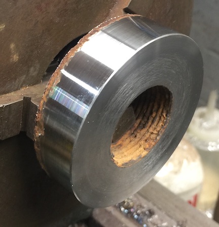

    Face first side

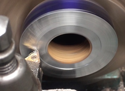

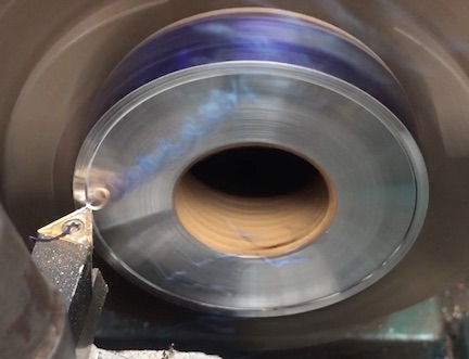

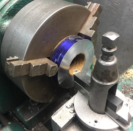

    I have recently begun using carbide more often. It was a necessity for this steel.
    When facing, the relation of cutting speed to surface finish became very evident.
    Notice the matte finish and the cool chip in this frame from a video
    As surface speed increased as diameter increased,
    the chips turned blue and surface finish like a mirror.

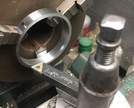

    Holding the part inside the bore to turn the OD to 0.004 under the
    hub bore and and begin to cut the thickness.

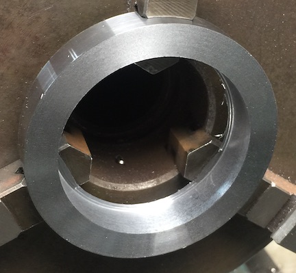

    Then holding on the OD, began boring the ID.
    As boring progressed I realized that jaw pressure might
    distort the bushing.
    The finished wall thickness will only be about 0.050”.
    Each cut made me more concerned about distortion. I stopped
    when the wall thickness got close to 0.150”

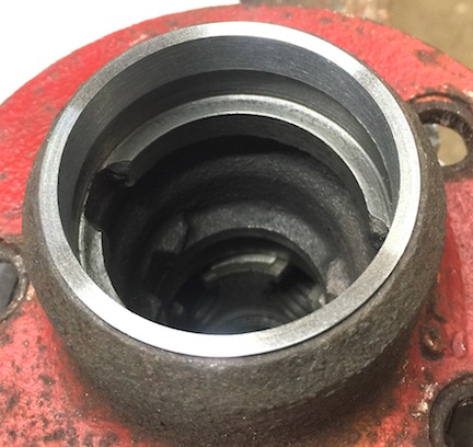

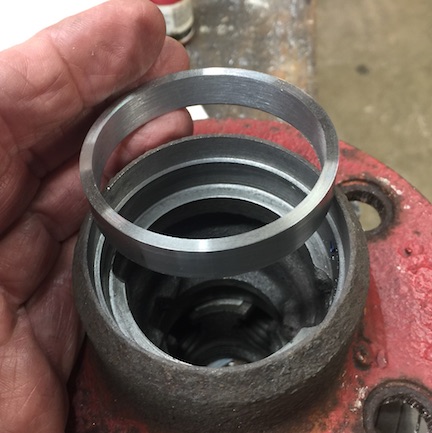

    Ready to install
    Test Fit

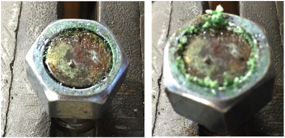

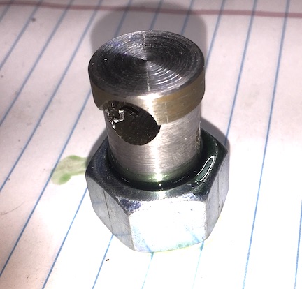

    I made a test by drilling the threads out of a nut and using the
    680 to “glue” it to a smooth piece of steel.

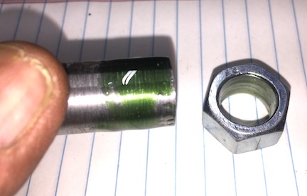

    After curing a couple of days I broke them apart, holding the shaft in the
    Vise and using a toque wrench. Beginning at 25 pound-foot, increasing
    by 5 pounds until it failed. It held100 pound foot. 105 pound foot broke the bond.
    I have no data, but that seems like a good enough bond to hold the bushing.

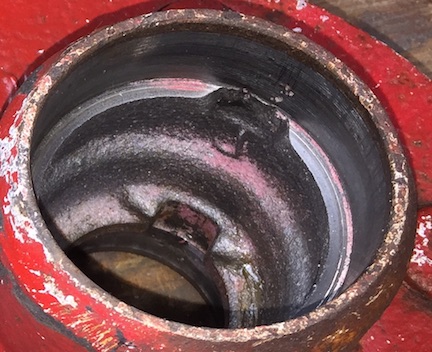

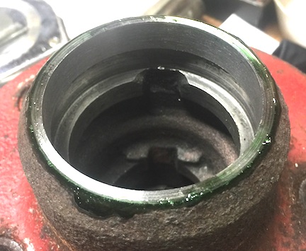

    I used LocTite 680 bearing retainer to install the bushing in the hub.
    Then let it cure for a couple of days.

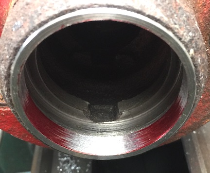

    I took light boring cuts of 0.005 (.0025 DOC) to avoid
    heating the LocTite too much. It became apparent during the
    first pass that the chuck had distorted the bushing.
    The skipping cuts could be easily heard, 3 times,
    equally around the bore. Before making the second pass I put
    layout die in the bore which clearly showed the 3 jaw locations.
    The 3rd pass almost eliminated the distortion.
    The bushed hub with its un-damaged brother. You can see,
    the transition between new and original but I cannot feel it
