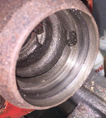

On the good hub, the bearing and seal, press fit into a common bore.

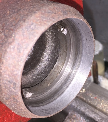

The hub that failed, rubbed against the back of the spindle and ground away the seal
and part of the hub. There is no material remaining to hold a new seal in place.

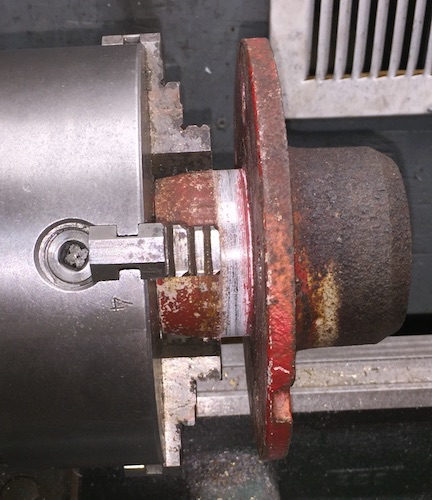

I centered the hub and prepared to bore the damage away to begin repair. I cleaned up
that machined section of the hub to center it. Then checked and dialed in final center using
the backside bearing bore

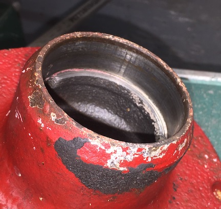

The damage was limited to the bore affecting the seal. The bearing cup protected that part
of the hub from damage. I was able to clean up the seal area, by boring about 0.132" oversize
Name:	04 bored.jpg
My plan is to make a steel bushing, install it then bore it to match the existing bore.
As I prepare to make the bushing, I see two options.
1) Do I make the bushing OD oversize then heat the hub, freeze the bushing, then press
them together, letting them shrink and expand, to lock them together?
IF yes, the bore is about 2 3/8", how much interference?
OR.
2) Do I make the bushing a little under size and JB Weld it into the bore?
I am leaning toward the JB Weld as quick and easy.
