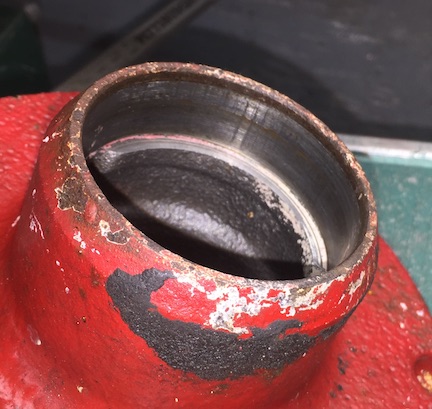

On the good hub, the bearing and seal, press fit into a common bore.
Attachment 49966

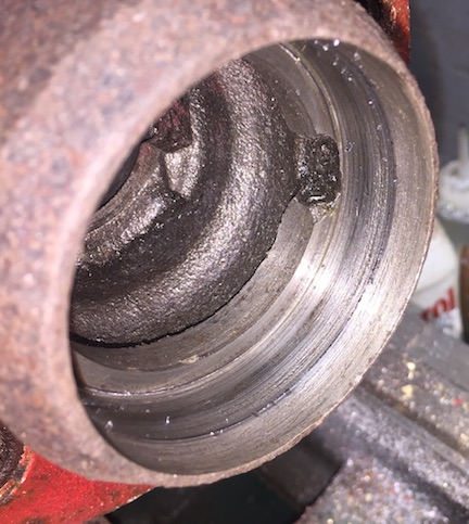

The hub that failed, rubbed against the back of the spindle and ground away the seal
and part of the hub. There is no material remaining to hold a new seal in place.
Attachment 49965

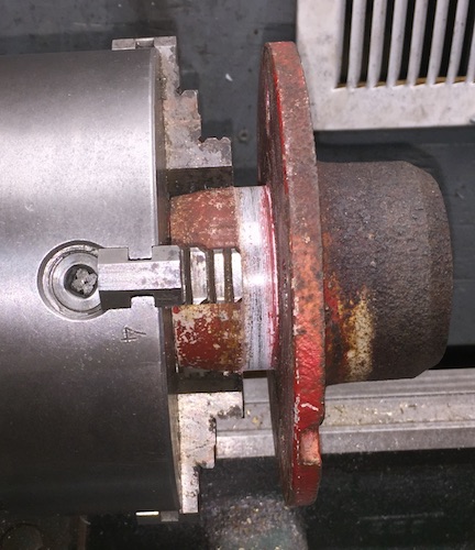

I centered the hub and prepared to bore the damage away to begin repair. I cleaned up
that machined section of the hub to center it. Then checked and dialed in final center using
the backside bearing bore
Attachment 49967

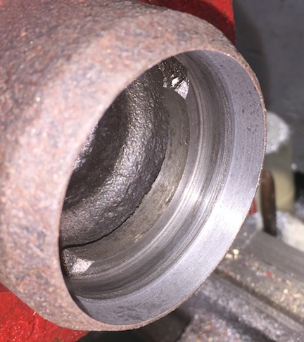

The damage was limited to the bore affecting the seal. The bearing cup protected that part
of the hub from damage. I was able to clean up the seal area, by boring about 0.132" oversize
Attachment 49968
