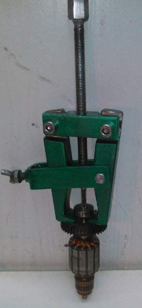

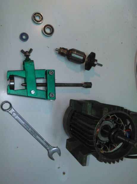

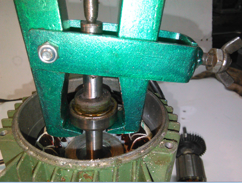

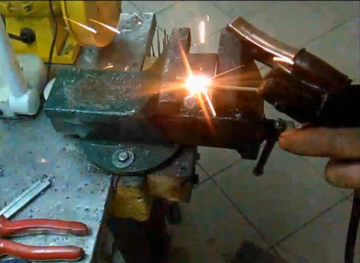

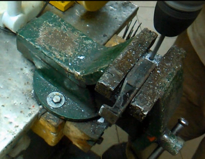

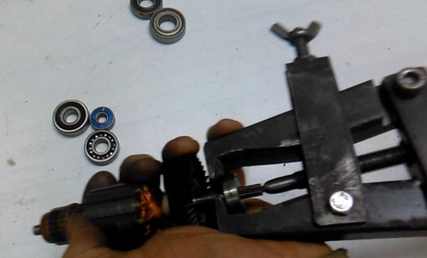

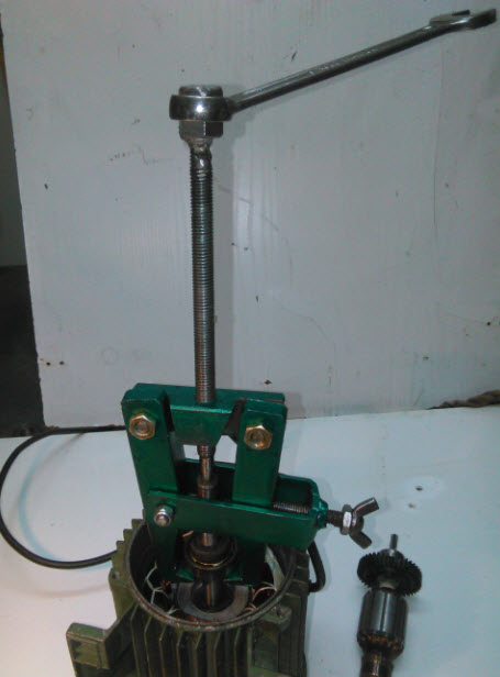

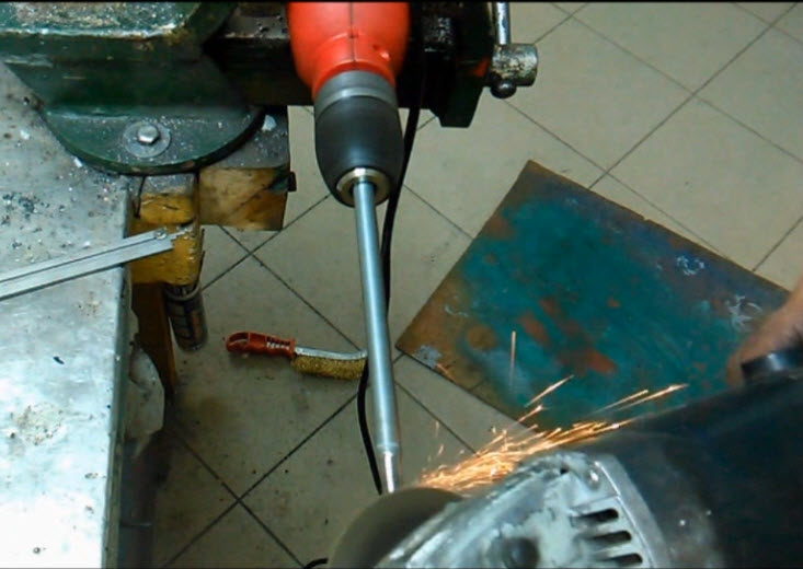

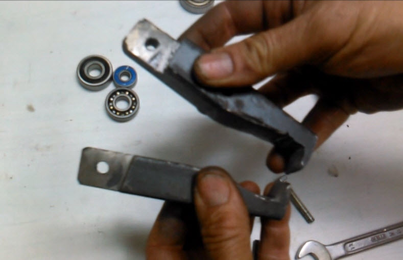

    BEARING PULLER HOMEMADE
    An easy and very useful construction we must have in our laboratory. The tools we need are a drill ,an angle grinder and a welding machine. I have also used the special tool to cut thread. You can pull bearings from electric motor armature from 1.5 to 8 cm (diameter). This tool is more strong and more heavy than them you can find in the market.
    YOU CAN WATCH THE CONSTRUCTION AND THE USE HERE:
