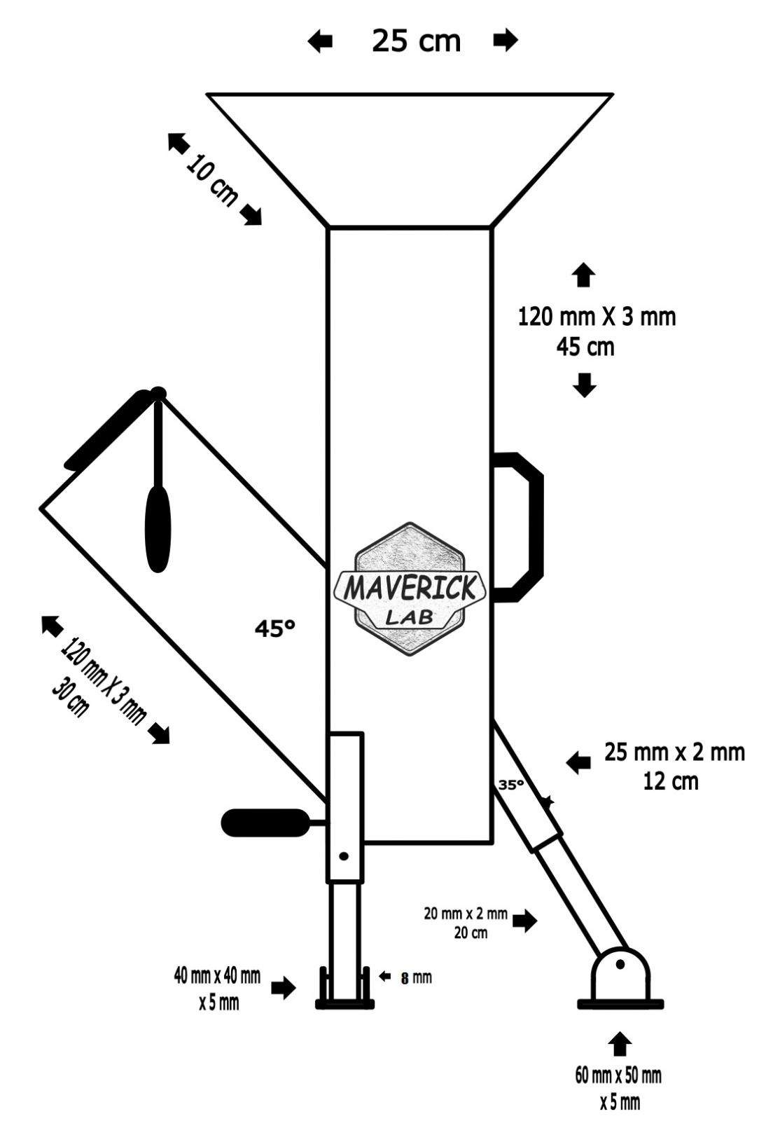

    Quote Originally Posted by PowerMk View Post
    This stove have 600,000+ views ! Its Amazing!
    I made a plan of my stove to thank you for your support.
