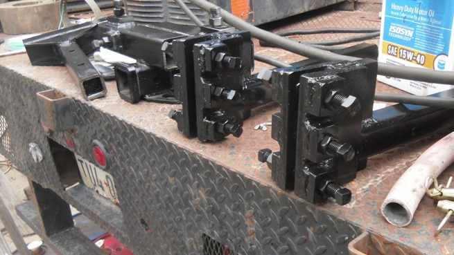

    THere have been times when I have been asked to go somewhere and drive or tow a vehicle like a truck home for someone
    I have a fold away tow-bar stowed in my daily driver so if the vehicle has a receiver hitch all I need to do is hook up and go. but more often than not htere is no hitch or a way to attach a 2" ball on the rear of the truck. So I made this for those times

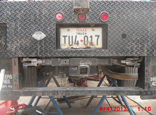

    As you can see it merly bolts to the bare frame of almost any truck large or small.

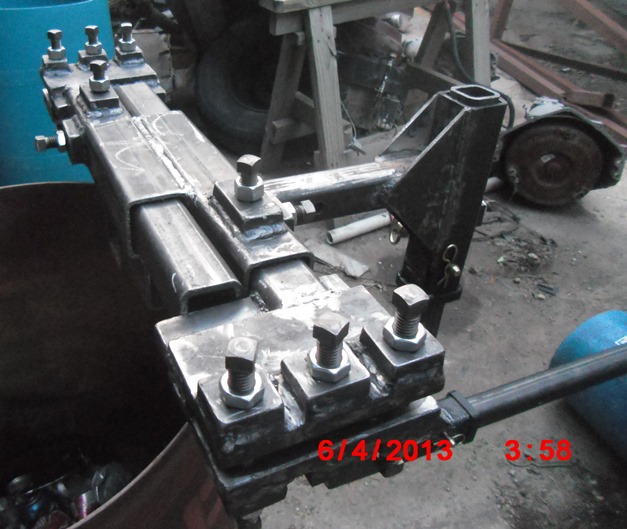

    I also made many parts for it so I could configure it to adapt to almost all situations.

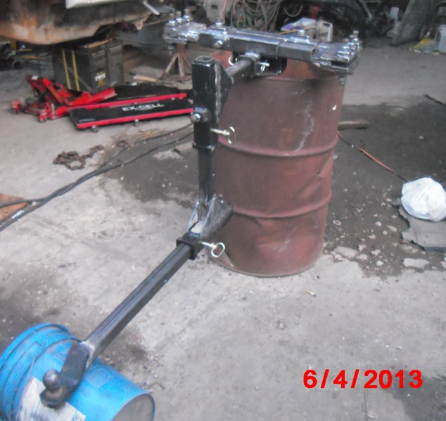

    this shows the bolts and locking nuts

    I hadn't given much thought to making plans for this item. A couple of reasons behind this is #1 since I would not be the one fabricating it I would not be able to guarantee it would be constructed to meet DOT transport safety requirements. Nor do I manufacture them for sale due to the exorbitant product liability ins costs. or the cost involved to have it certified for sale to the public as a towing device.
    All I can say is that the guy who borrowed it from me nearly 5 years ago still has it and uses it a lot he has probably used it behind 100s of truck to tow his go home vehicle for well over a couple 100,000 miles.
    No the square head bolts do not have points to them they were flat ended and some of them were cupped> the biggest downside to the bolts being used to clamp to a vehicle's frame is it will damage the paint or coating on a new vehicle, but if tightened properly it won't ever slip.
