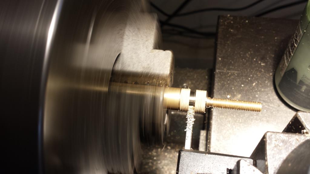

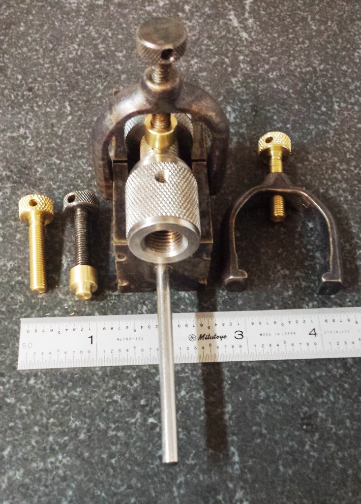

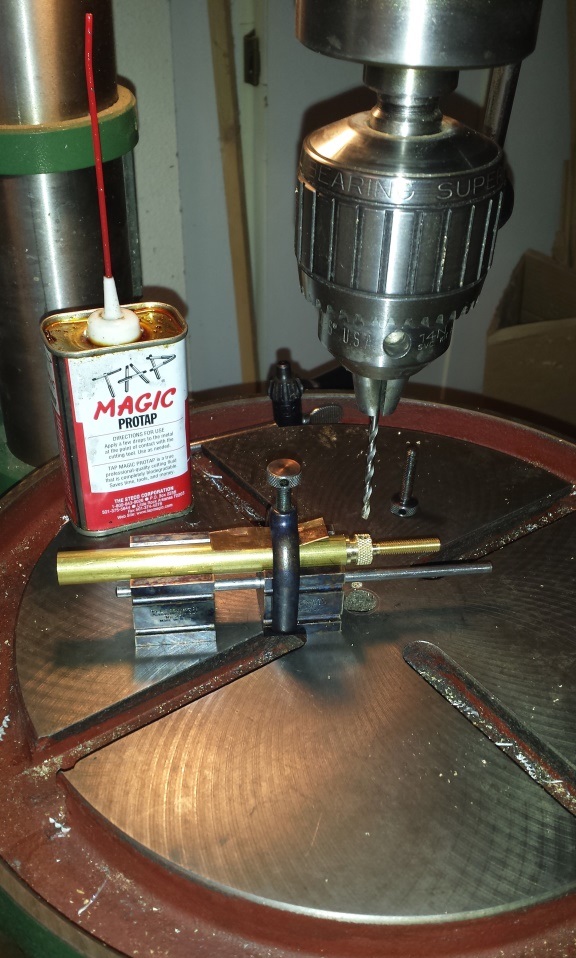

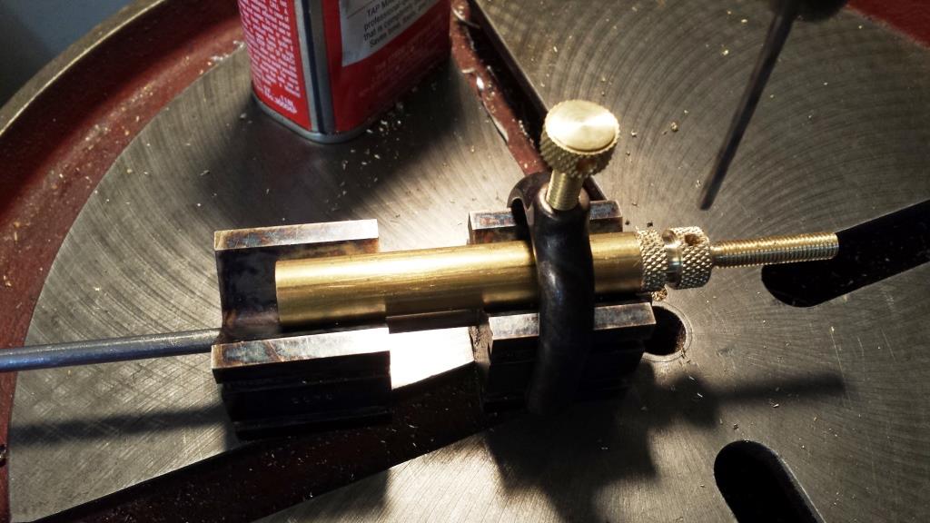

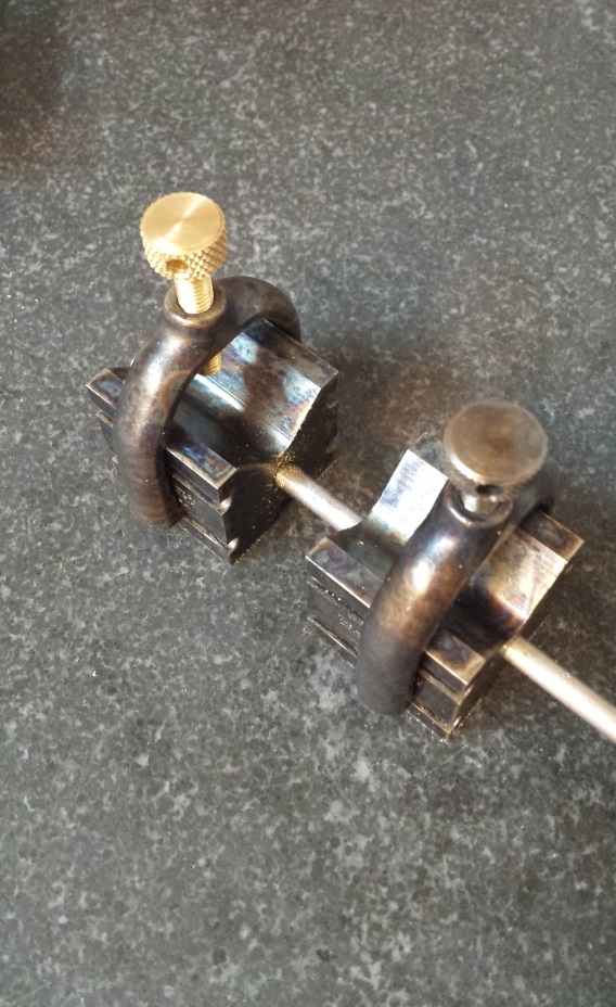

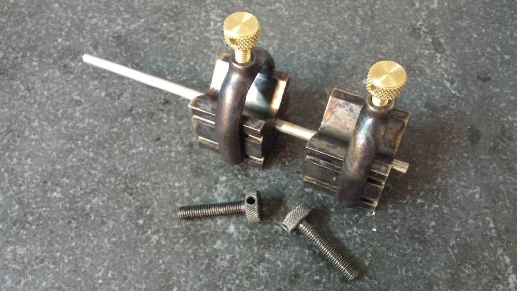

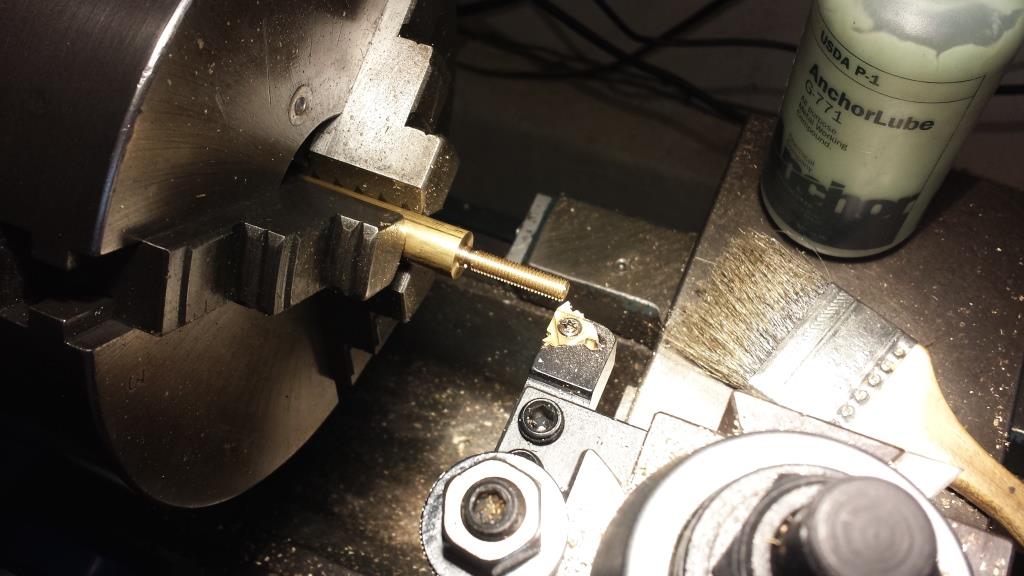

    I have a two sets of the twin pairs of Starrett 271C V-Blocks. I find that many times I am adding a copper shim to protect the parts clamped in the V-blocks. I decided to make a new set of brass clamping screws as an alternative to the copper shims. The V-Block sets were purchase new in 1970 and each block has a beautiful mottled-brown finish from the color casehardening process. I don't think Starrett uses this type of casehardening technique on the current 271C V-Blocks.
    Each set of V-blocks comes with a forged steel clamping yoke threaded for screws with a 0.223” major diameter and 28 TPI (the 3-wire method of measuring calculates a major diameter of 0.224”). I think the current V-Block versions use screws threaded 0.187-32. The brass clamping screws are made from 0.500” dia. C360 brass and single point threaded and knurled on the 12” swing lathe.

    Nice work Paul. That patina is beautiful and hopefully your brass will catch up with it over time.
    Would have thought a standard 1/4-28 would have worked but obviously they chose something slightly under although the machinery's hand book says the min. maj. diameter could be as low as .2392 for a class 1A...not so good for a V-block hold down. The oddest threads I ever worked with are the grip screws for a 1911 which are .1500-50 UNS-2A THD which screw into a threaded bushing with .2360-60 UNS-2A THD into the frame.

    The old Starrett tools seem to have odd screw sizes and probably just because they can. I was going to use a standard 1/4-28 die to make the clamp screw threads but I doubled checked with my electronic caliper to make sure. At first, I thought my caliper had reset its zero point when finally I realized Starrett had an odd screw size. Of course Bozo came to visit me when I made the second threaded part on the lathe. I machined the major diameter at 0.233" instead of 0.223 by misreading the digital mic and then single point threaded the part only to find the thread wouldn't fit. I learned to never release the lathe clutch or gear settings until you can check the threads. I was able to turn it down to the correct diameter and finish the thread without any problems.

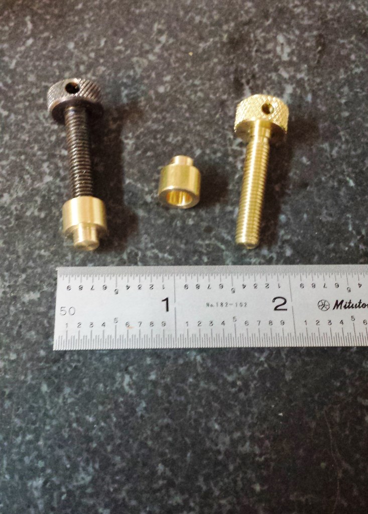

    I saw a neat protective brass cap to a V-block clamping screw while watching the YouTube video by Suburban Tool Inc about their jig grinder. The brass cap just slips over the tip of the steel clamping screw and is a much easier solution to my version using a brass replacement to the clamping screw. I made a pair of the protective brass caps and like how these work. Each cap is 0.375" long with a 0.375" diameter, bored to fit the steel clamping screw diameter and turned down with smaller diameter end for clamping.

    How are they held in place? I wouldn't want to have them falling off the screw.
    Another approach is to drill the end of the screw and drive a short piece of brass rod into the hole.

    Personally I like the all brass screws, Classy!
    I've used both methods depending on the application. The cap type can be threaded and use loctite, but that would be tough because of the odd thread and shallow inside threading. I have also turned the end of the screw down to form a shank and make my cap to fit slightly under the OD of the thread then used 680 to hold it on...that way it will come out of what it is screwed into. Did that on my drill press quill slot screw to fit the key way better and ride smooth.
    The Pin type is easy too and can make a top hat design that is just under the OD of the thread. I made a Delrin one for the tail stock screw on my mini to extend the taper break loose...it was a press fit and stays in fine because I over-sized the pin skosh and press it in...compressing the Delrin.
