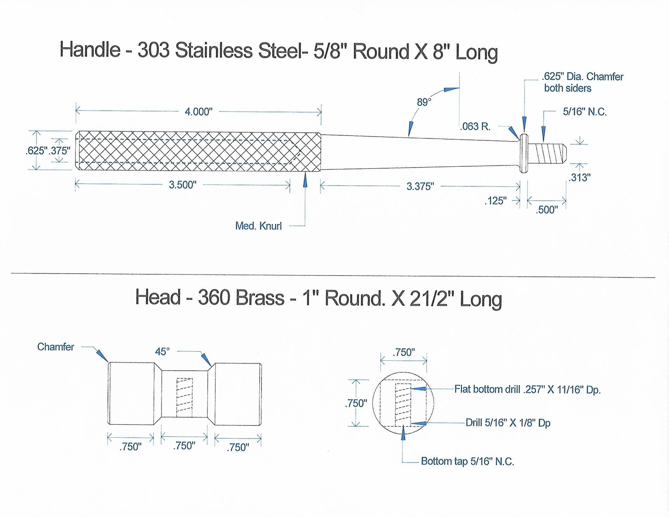

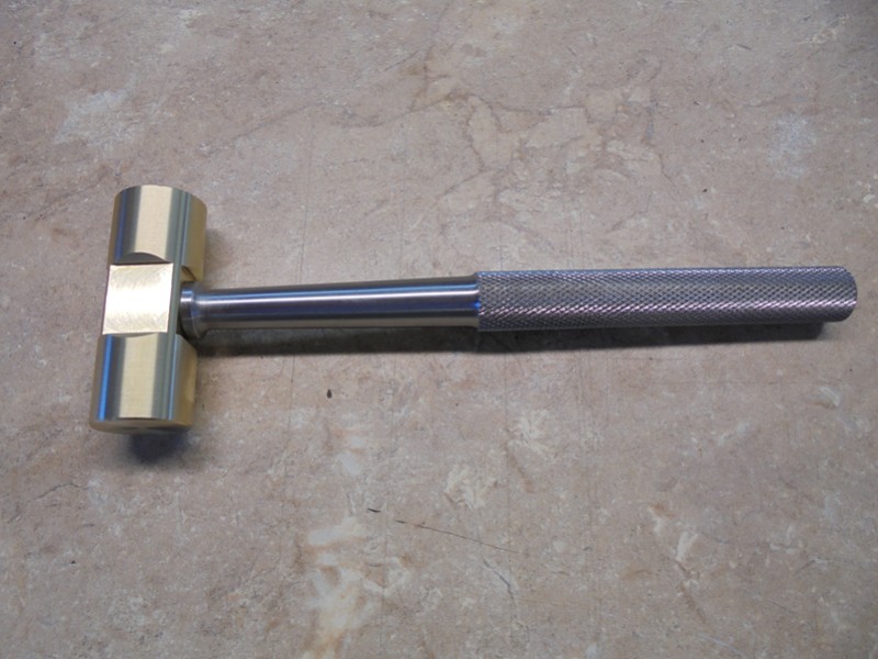

I made this little hammer for adjusting work in the lathe chuck, seating parts in the mill vise Etc. It's just an all around light tapping hammer for whatever, I have for a long time just used a 1" diameter piece of brass about 3" long with no handle just to bump something lightly, So I decided to make something a little more appropriate.
The head weighs 6oz. and made from 1" diameter 360 round brass, the handle is made from 5/8" diameter 303 stainless steel round with a medium knurl, the knurled end of the handle is drilled 3/8" diameter X 3.5" deep, this balanced the hammer very good, the handle screws into the head with a drop of Loctite, different heads could be made of lead, plastic, copper, Etc.
Below you will find some photos and a cad drawing of the completed hammer
as always, thanks for looking and happy machining
Doug

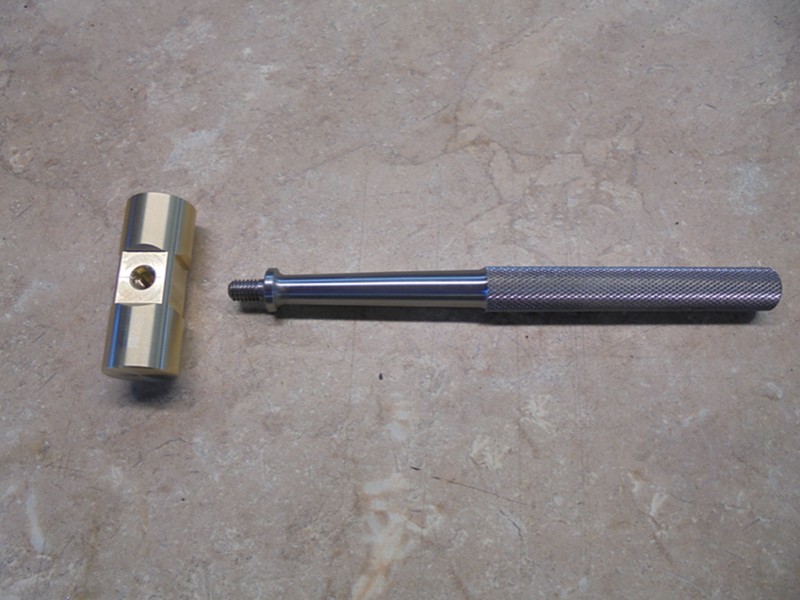

Attachment 16254
Parts of the hammer
Attachment 16255
Assembled

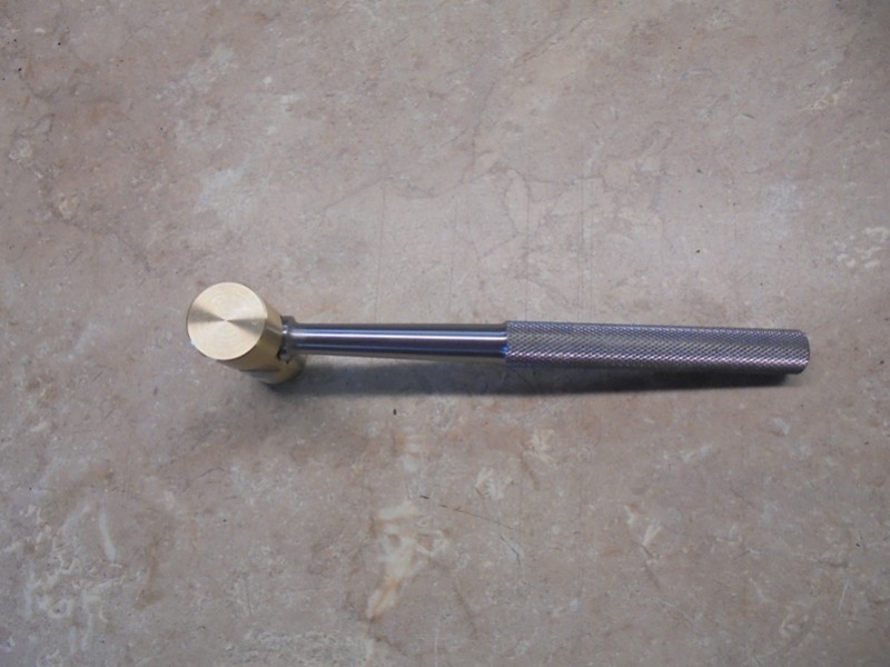

Attachment 16256
Different view

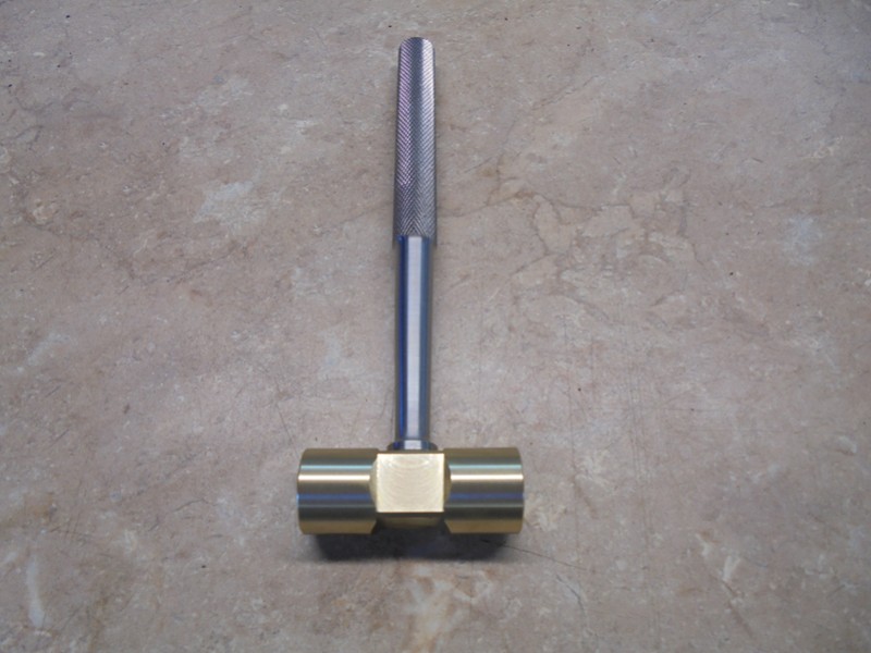

Attachment 16257
Another view
Attachment 16258
Cad drawing
