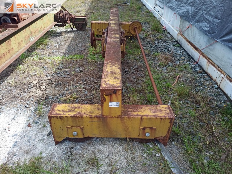

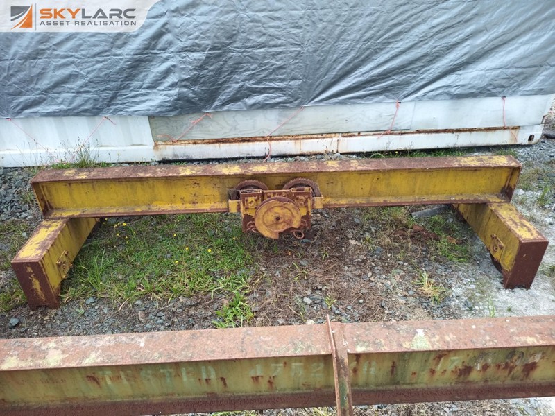

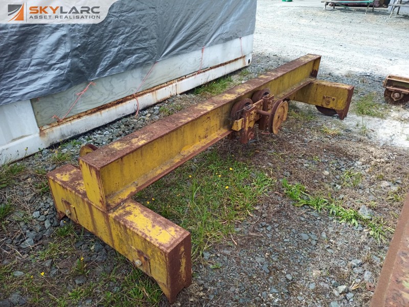

    I am not kind to myself, having an enormous amount to do just having a major cleanup and then I make an impulse buy of more potentially useful stuff.
    I spotted this on a local auction site and told a friend about it for a workshop he is building to house his excavator and tractors and he then forgot about it. Came down to the last two minutes and I threw a bid on then the war started. I have a very limited budget but calculated that I could eat porridge for a few weeks and pad the dogs steak with rice on the side so came up with a figure, bid and turned the computer off.
    Got busy but when I checked a few days later found I'd won. In U.S. Dollars $100.06
    It had been sitting in a yard for a couple of years and the trolley was seized up so I painted some Emertan rust converter around and next day followed it with some home-brew penetrating fluid. Came back a couple of hours later and less than 10 minutes with a bar had the trolley rolling freely by hand, made my day.
    The penetrating fluid I mix up is 1:1:1 Kerosene: ATF: Diesel and as I was at the end of a bottle of semi-synthetic two-stroke oil I added some of that too, I think there is a noticeable difference. I'll have to tu-tu with it a bit but thinking that I'll keep the 1:1:1 ratio with the ATF,Diesel,and 2-stroke oil and up the Kerosene to 1.5 or 2 parts.
    Although I would love to erect some rails and use it as a bridge crane over what is left of my driveway I am thinking converting it to a gantry crane would be quicker and cheaper as there ain't a lot of A45 crane rail going cheap at the local scrapyard.
    Length is 2940 mm, width 1000, height 640 mm.

    Looks good, now the work begins. If'n it was mine, I'd consider removing the end cross pieces, rotate them 90°, weld them back on to widen the unit.

    ! Terrific deal. With limited headroom, a bridge is less than ideal.
    I have eyes out for 5t span of about 30', with figuratively same general concept. If a gantry IS possible it will link heavier equipment, which are all in a line. They're wired by drop cords and connectors, no other impediments. The rail could be V-grooved wheels running on inverted angle iron to minimize trip hazard. Like most, a hand chain fall is preferred to electric, though I'd hang two for manipulating.

    Katy, The end pieces are fabricated box section and wider would not be better where I live due to lack of space. Under the span is the same as the shed door and I could drive under it.
    Toolmaker51, to reduce cost I am leaning towards a gantry. Thinking of bolting some uprights to the ends of the end truck and a friend has given me a 3T trolley so I can hang two hoists.
    Now the search begins for some reasonably priced steel. Have to keep an eye on the auctions.
