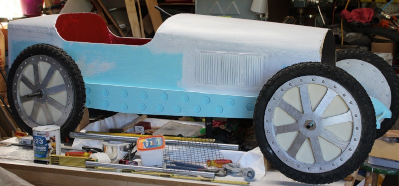

This video is the sixth part of a series and completes the body construction. The sheet metal part of the body was fabricated and installed, the wheels were fitted into position with the proper sized spacers. The steering wheel was fabricated. The seat portion of the body was completed, and the back rest was fabricated and upholstered with foam and vinyl “leatherette.” Next week’s video (Part 7) should complete the project with all the finishing touches, prior to the pedal car going to the WHRL auction.
I purchased plans to build a 1920’s scaled down replica of a Bugatti, open wheel, grand prix race car, in the form of a kid’s pedal car. I’m building and donating the pedal car to the Woman’s Health Resource, Library ( https://www.whrl.org ) for their annual fund-raising auction on July 28th, 2018, during the local Milbridge Days (Milbridge, Maine) celebration. The auction will be held at “The Seaworthy Center” on Main Street in Milbridge.
This is not my own design, and I purchased the plans. If there is sufficient interest in pedal car plans, let me know, and perhaps I’ll work on a couple of new model designs – in which case, I’ll post them in pdf form for free on my web site.
