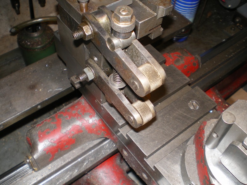

Bump straight knurling tool
After making a scissor knurling tool, I become intersted in making a straight knurling tool since it:
> is greath when you need transmit torque between a steel shaft and a plastic wheel.;
> it can bring me more choices when making stuff;
> I can "save" a interference mount part infortunatelly made too loose.
https://farm5.staticflickr.com/4632/...3555b1299f.jpg
I took a 1/2" square and milled the wheel slot
https://farm5.staticflickr.com/4629/...fc32761bc6.jpg https://farm5.staticflickr.com/4615/...3b70c5a39c.jpg
Turned the 1/4" pin from a 1045 bar. Here you can see there a section slighty bigger for interference fit
https://farm5.staticflickr.com/4763/...db80b31cd3.jpg
Pin was heated red hot and quenched in water.
https://farm5.staticflickr.com/4671/...fd12cbddb6.jpg
After welding the side tab and cross drilling the 1/4" hole, I pressed the pin
https://farm5.staticflickr.com/4661/...0e966de989.jpg
Test run. I've made a fine (0,8mm) and a coarse (1,25mm) wheel.
https://farm5.staticflickr.com/4622/...fd17840f3e.jpg https://farm5.staticflickr.com/4612/...f60221a901.jpg
My knurl set
https://farm5.staticflickr.com/4718/...67dd62bbf0.jpg
now waiting rain give a break for paint the tool...
