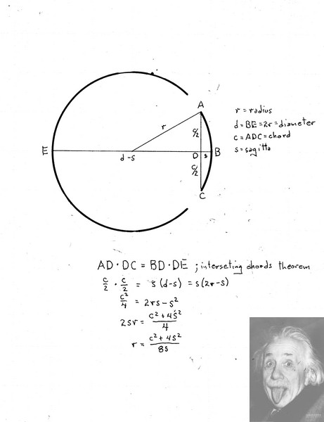

    In geometry there is a little known theorem called the Intersecting Chords Theorem. It states that, if two chords intersect inside a circle, the product of the two sections of one chord is equal to the product of the two lengths of the other chord.
    The utility of the Intersecting Chords Theorem isn't immediately obvious. This example problem demonstrates at least one use...
    In the accompanying diagram, you're given only the partial arc of a circle ABC and must find the radius of the circle and the center on which it is drawn. The procedure for doing this is:
    Draw the chord ADC.
    Construct the perpendicular bisector, BDE, of the chord ADC. The diagram shows it extended to the opposite side of the circle (point E) but this point is not yet determined so, in practice, the bisector would be extended past it. No matter, the location of point E will be known once the radius is calculated and the complete circle is reconstructed. Remember that the perpendicular bisector of ANY chord passes through the center of the circle; that fact will be used later.
    We now have two intersecting chords - ADC and BDE - so we can apply the Intersecting Chords Theorem. The algebra to do this is shown on the diagram. An equation for the radius is found that depends only on the lengths of the chord, ADC, and the sagitta, BD, both of which can be measured from the arc directly.
    Once the radius length is calculated using the derived expression, an arc of that length swung from point A, B or C, will intersect the bisector at the center of the circle.

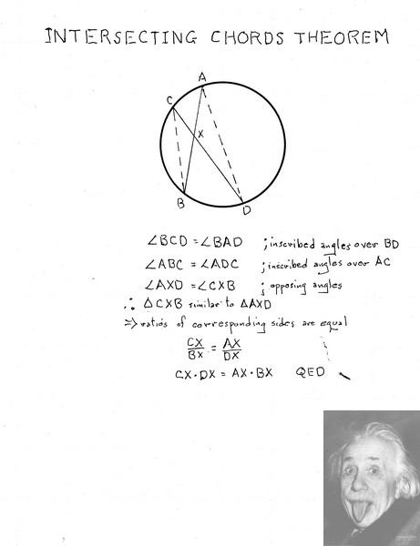

    Attached is a proof of the Intersecting Chords Theorem.
    This proof makes use of some features of geometry not necessarily known to the average reader. At the risk of boring our more mathematically adept readers, I'll provide some explanations...
    Two sorts of angles can be constructed in a circle. A central angle has its vertex at the center of the circle. An inscribed angle has its vertex on the circumference of a circle.
    Two inscribed angles that subtend the same span on the circumference are equal.
    An inscribed angle that subtends the same span as a central angle has a measure half of that of the central angle.
    Both of these can be proved but, for the work here they are assumed true. (I don't want to get into an endless sequence of proofs that extend all the way back to geometric postulates/axioms (self-evident features accepted as true without proof).
    Two triangles are congruent if their corresponding sides are equal in length, and their corresponding angles are equal in measure. To prove congruence you need to prove three corresponding items of the triangles are equal and at least one of those items must be a side.
    Two triangles are similar if and only if corresponding angles have the same measure. If two triangles are similar, their corresponding sides will be proportional. An example might help here... All 30-60-90 triangles are similar but, in general, not congruent (unless they have an equal side). However, the ratio of the short side to the hypotenuse in all of them will be 0.5, the sine of 30 degrees.
