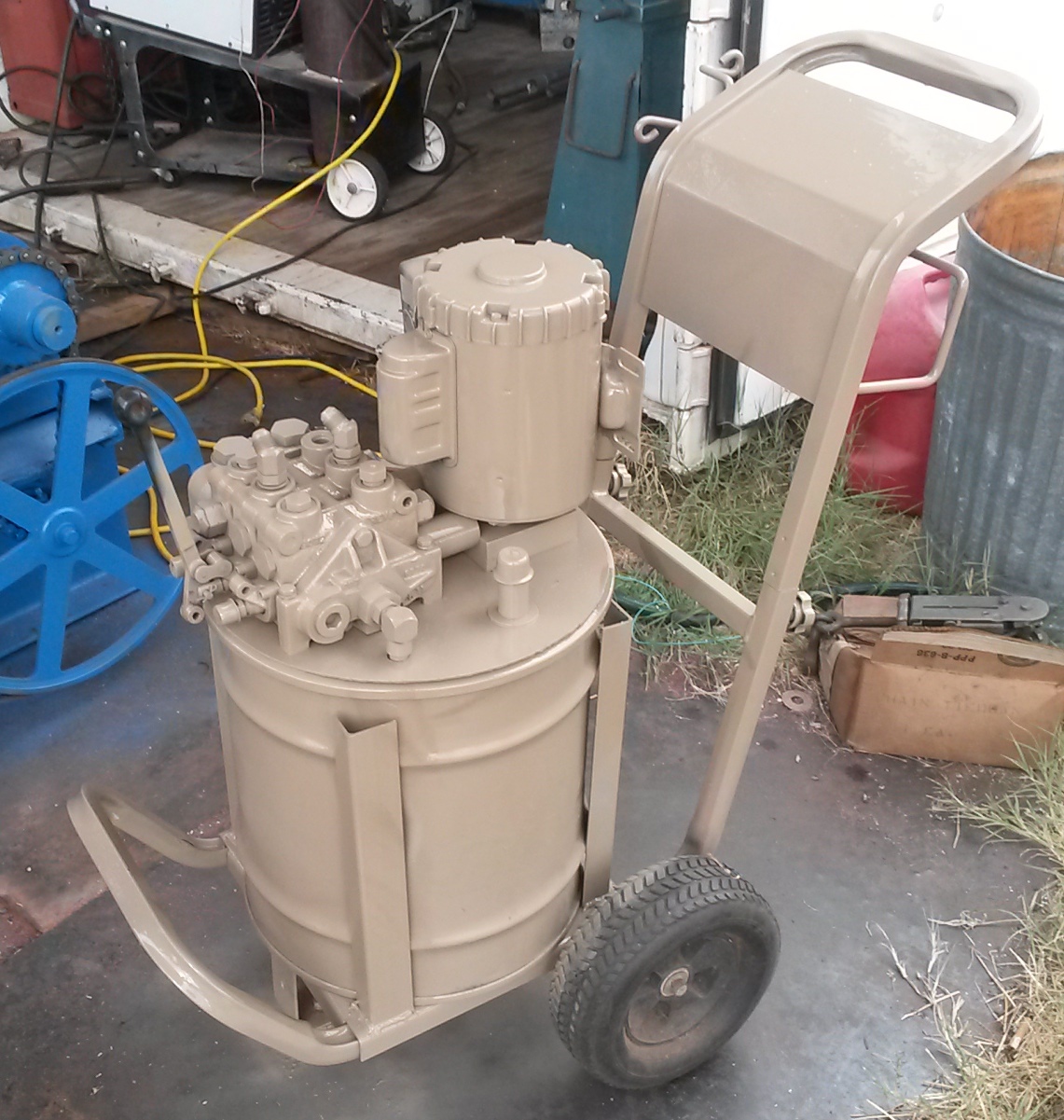

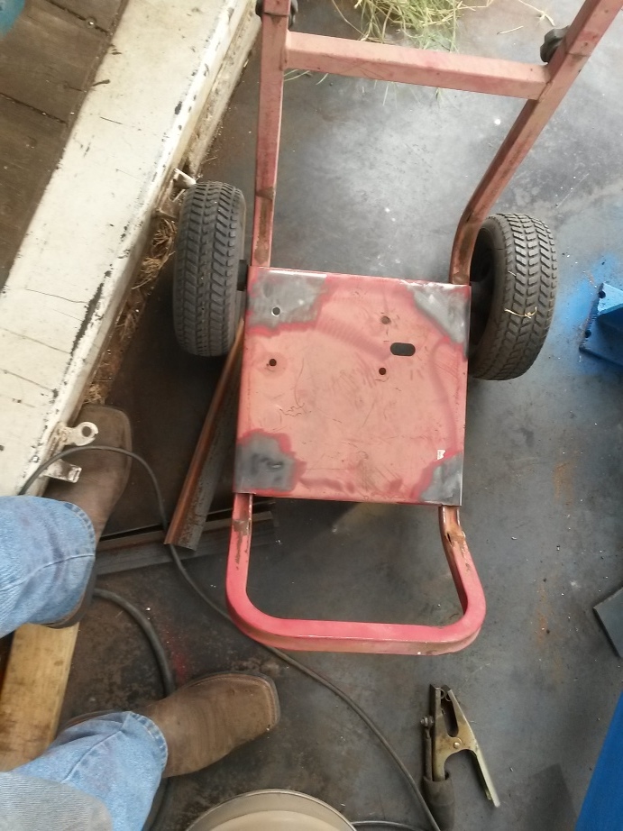

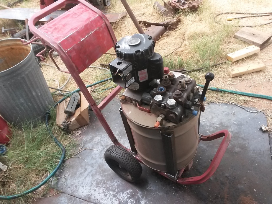

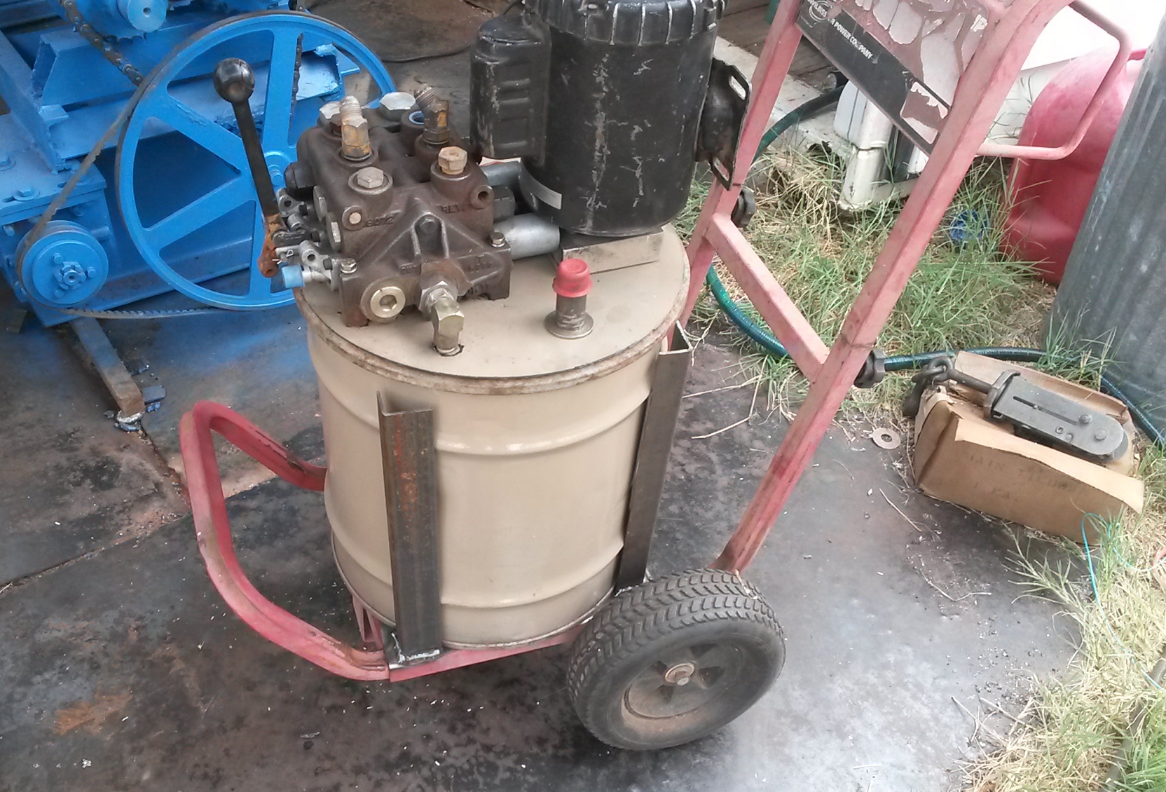

While digging around in 1 of my sheds I uncovered an old Pressure washer cart
This gave me the idea to mount my power unit on it because the size looked to be perfect

More info on the power unit?
I like to get a look under the hood.

It started out as a power unit that hung from the post of your average 10 to 15 ton 4 post automotive truck lift with a 6 to 8 gallon plastic tank only I had installed it on a elevator that I made for some close friends up on Vashon Island WA. after nearly 20 years of use the coupling between the pump and the motor went bad rather than take a chance on finding a machine shop willing to make a new coupling we replaced the whole thing with a new unit. So I brought the old one home with me tossed it in my someday pile
