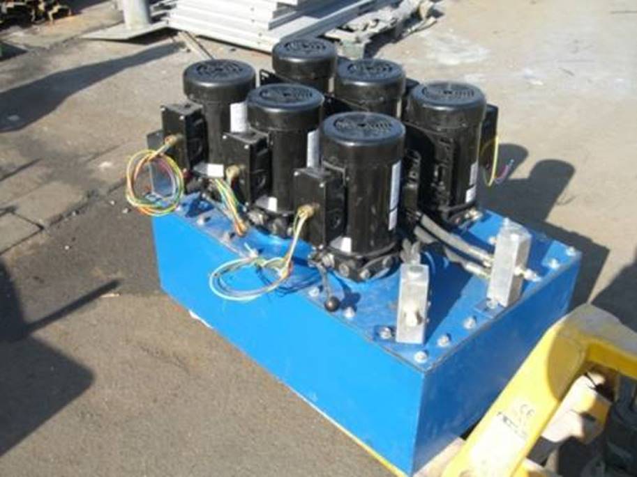

    As I mentioned I doubted that seals would be part of the problem in using a PW pump as a hydraulic pump. because as you pointed out Viton seals are used in applications all across the spectrum. any rubber seals would be a durometer of 80 or better Ceramic seals have been used in some Sunstrand piston pumps for years Rexroth Vickers Parker Charlyn all have and do use ceramics in various models of their pumps and motors.
    the Cavitation issue is easily solved by having the reservoir above the pump with an oversized feed line. or a simple low pressure rotary vane, centrifugal or gear pump as a charge pump to feed the piston pump. even a salvaged power steering pump from automotive would work well for this.
    Building a water jet system using a PW pump could most certainly be done with pressure intensifiers I would think the productive output would be severely limited due to the large volume loss for increasing pressures from a modest 2-4000 PSi up to the 20,000 to 100,000 PSi normally found in water jet systems but again doable by paralleling 2 or more Pw pumps in a system using back pressure checks to prevent reverse flow between the pumps.
    here is a 6 pump power unit I made out of individual 3 Hp pumps
    I've used these pumps to make power units ranging from a singular stand alone unit all the way to having as many as 10 pump motor assemblies mounted on a single tank. The advantages of doing this was rather than having a single 30 HP motor pulling a 20 gallon pump when only 2 gallons were required or wanted for flow instead of having a variable displacement pump with an out flow of 2 GPM being powered by a 30 Hp motor when only 3 Hp was required for the amount of fluid being moved the savings in electricity usage was 10 fold As flow requirements increased or decreased the motors would automatically come on line or drop off line Also greatly reducing the inrush current load. another advantage was if a single pump or motor were to ever go bad the whole system was not shut down it could still be operated at a diminished capacity if need be. Where as if a single large pump motor went down everything was shut down until repairs could be made.

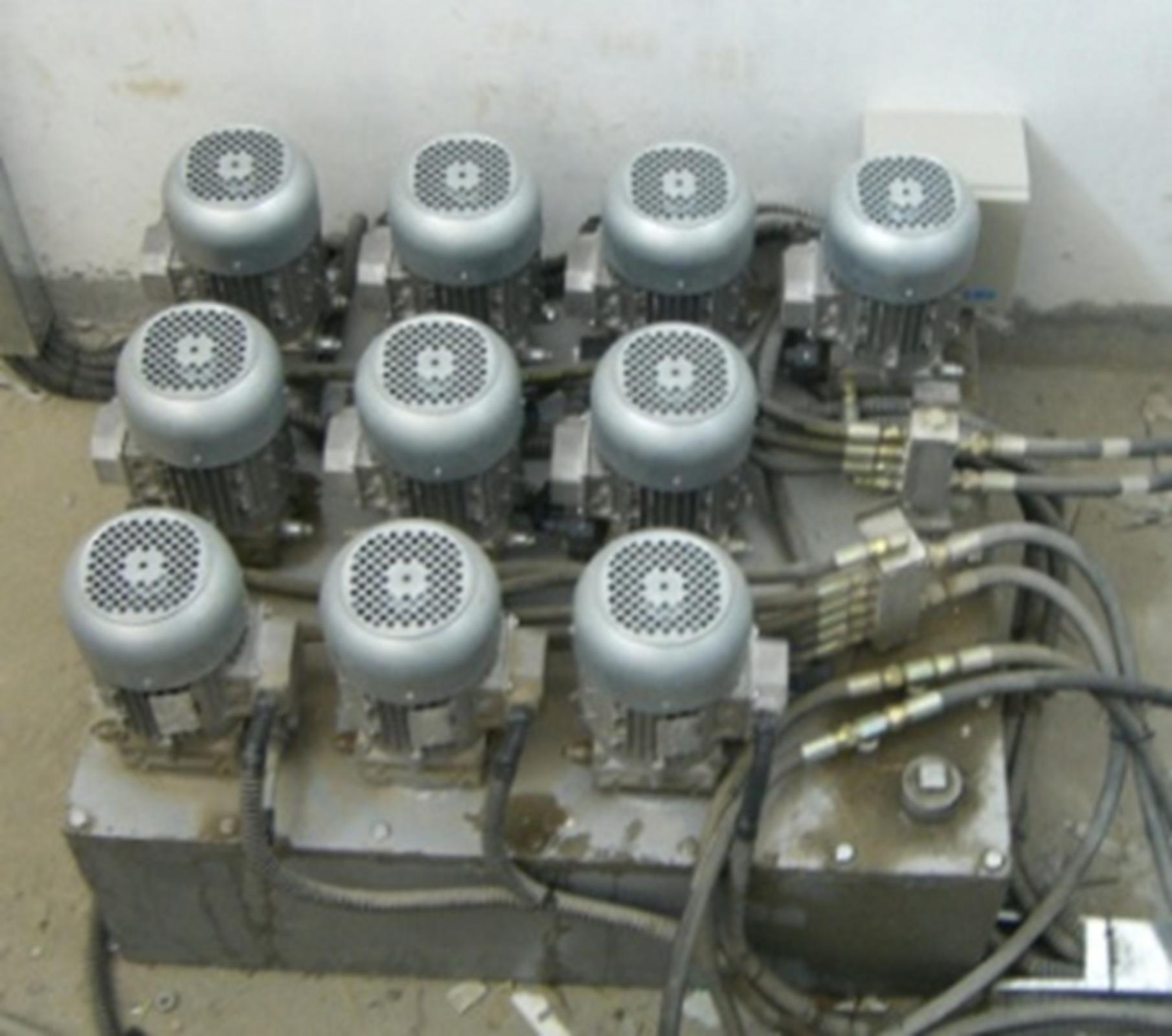

    And here is 1 of my 10 pump power units
    This one was used to power 2 40 ton freight elevators from 1 to all 10 pumps could be used to raise either platform
Name:	10 pump power unit.jpg
    I see some sort of manifold that must collect the outputs from each pump. I assume this has a check valve for each pump, so you can't back drive a pump that is off.
    What sequence method controls the various pumps? That has to be where the major cleverness is, assuming you designed that as well.
    I can't think of this being pressure, that just seems to have too many switches to adjust for cutin and cutout. A demand sensor of some type?
    I hope this is not some intellectual property that prevents you from sharing the operation.
    Well part of it might be considered intellectual property I can't show any actual pictures of the controller that I designed simply because I don't have access to them in a failed hard drive LOL I will tell you a little about it though but first
    your inquiry of the check valves and the distribution manifolds

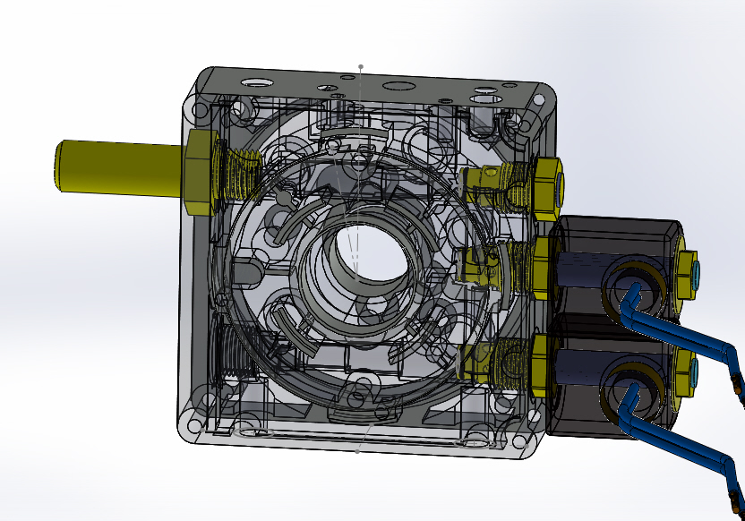

    in each pump assembly I designed additional ports and cavity passages into an existing factory mono block motor/ pump adapter block then traveled to the manufacture in Italy a company by the name of Hydronit through a collaboration between their engineers and me we came up with a block that not only suited my needs but extended the usefulness of their products to be used in a wider field of applications. Their blocks already had cavities for check valves relief valves and 2 way solenoid operated poppet valves what my proposal was to make the cavities in the blocks to accept 4 way poppet valves by doing this it opened up a range which would accept flow restrictor valves duel power outputs differential pressure outputs and many other things such as building a multiple pump arrangement.
    here is a jpeg of the block It would be most difficult for anyone to duplicate this block from this drawing alone since there are many passages and ports in the block
    And yes their block is patented not sure about the changes that I made to them but I should hope they did
    Now for the controller basically since my freight elevators were mainly used for 2 to 4 stops the controller to accelerate and slow the platform amounted to a few limit switches and a friction wheel sequential rotary switch. a series of relays and solenoid valves already in the pumps
    the operator or person at the door would push the call button a pump would start the platform began to move then that pump would go to full volume the 2nd pump would start with the fluid being briefly diverted a valve would close this would show a brief acceleration the 2nd solenoid would allow that one to go to full volume and the process would be repeated until as many pumps that were dedicated to the unit would all be on line as the platform reached the level going up the pumps would sequentially fall off until full stop. for going down it was a little different as the same valves in the pumps were used but the flow returned through the flow restrictor valves the pumps were not running. there were velocity check valves which would lock down the whole thing in the event of a broken hose. these were located in those manifolds you mentioned this was done to allow the platform to still be raised or lowered even if you removed a hose leading from 1 or more of the pumps, with a main velocity check made into the cylinders in the event of the hose to the cylinder was to burst or was cut intentionally. This did happen once by a guy who thought he could destroy the left by hacking a hose off with an ax. all he managed to do was get oil all over himself and a nice prison stay. `
