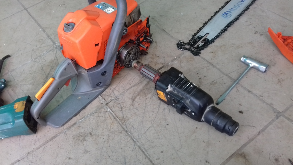

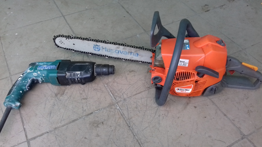

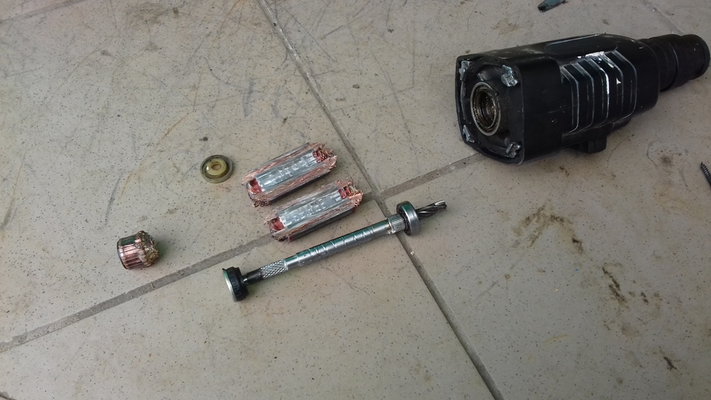

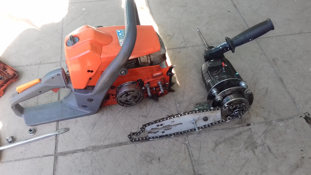

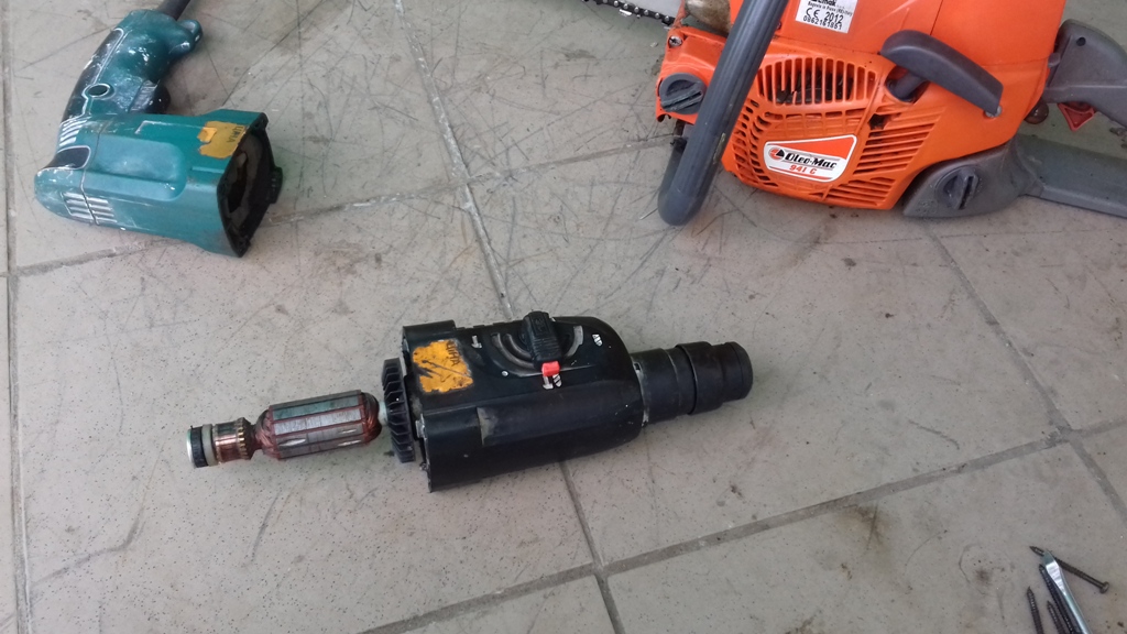

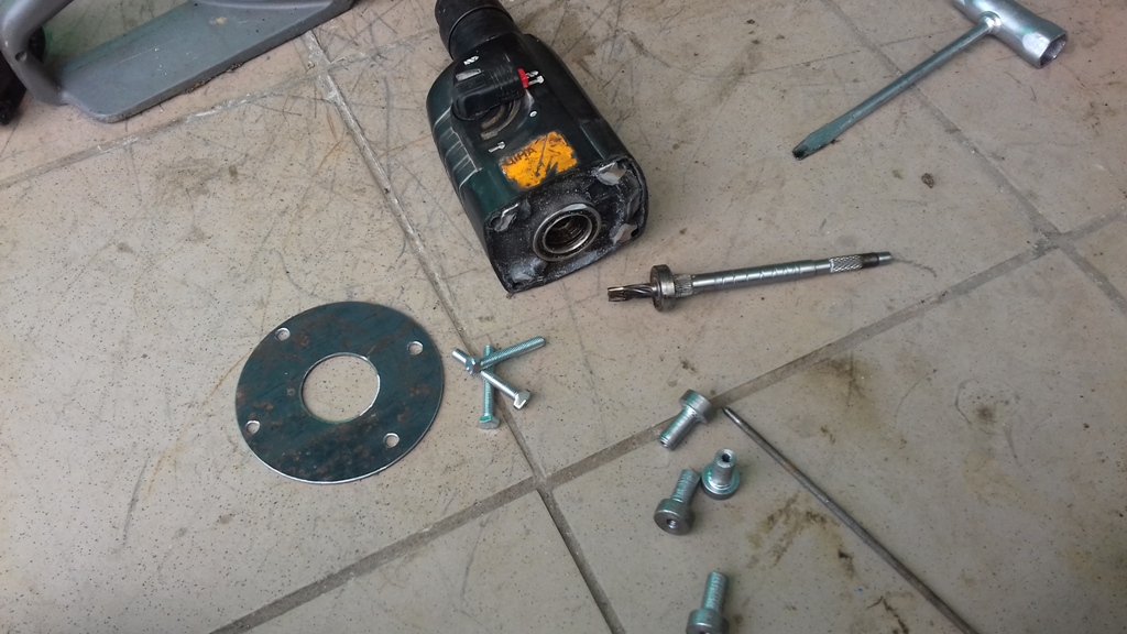

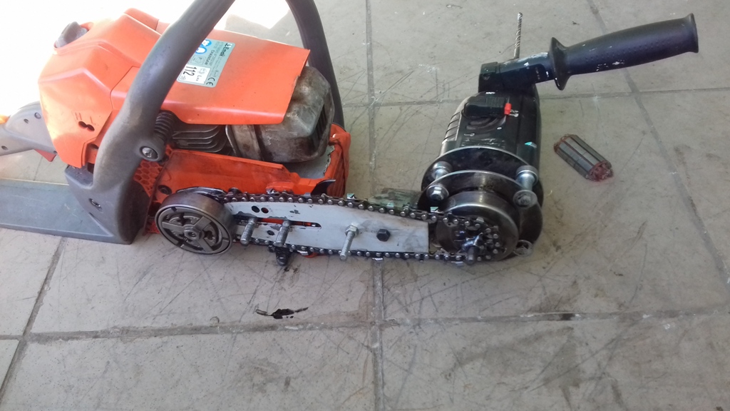

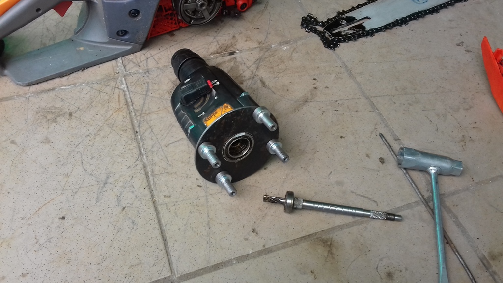

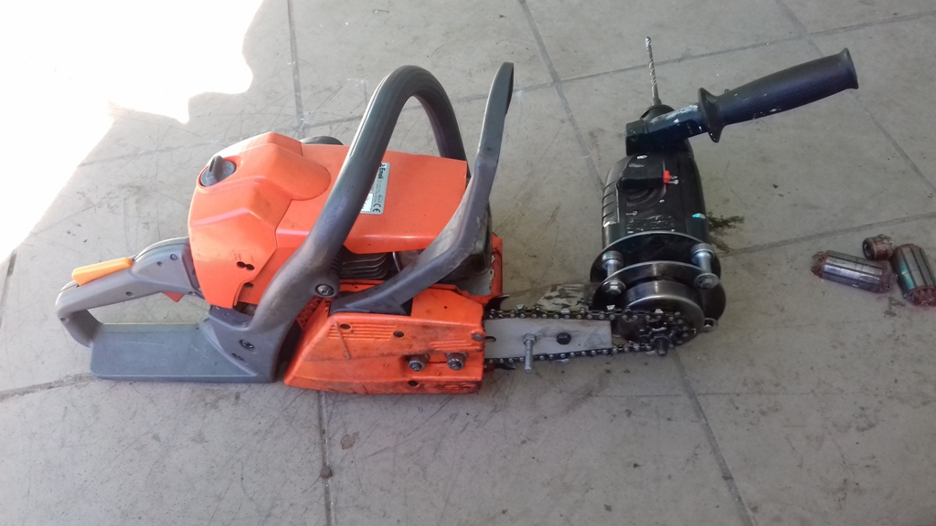

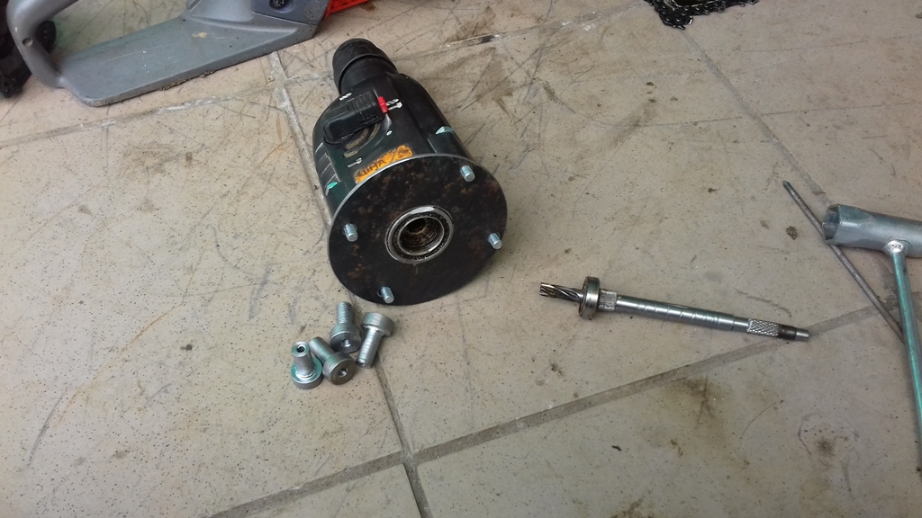

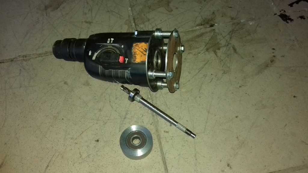

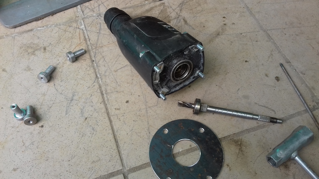

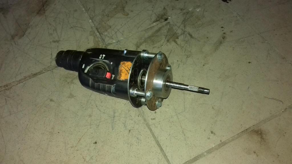

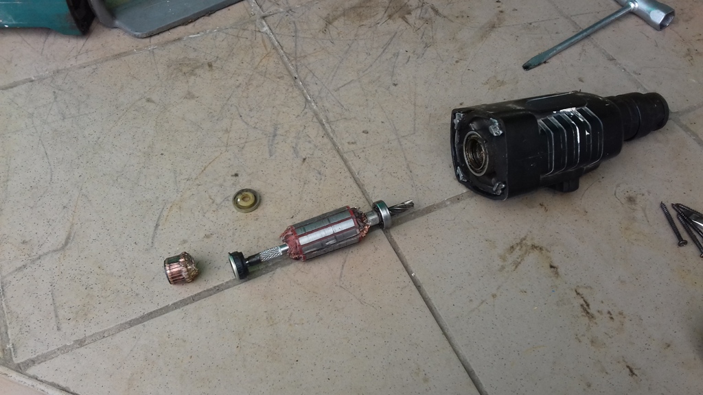

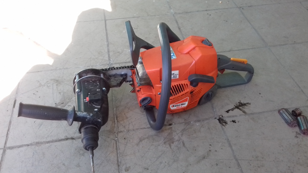

Got not quite what I planned, but despite the shortcomings it works well. I wanted to set the drill equipment right on the engine's cranks, but it turns into the opposite side. Therefore, it was necessary to install through the bus and chain.
