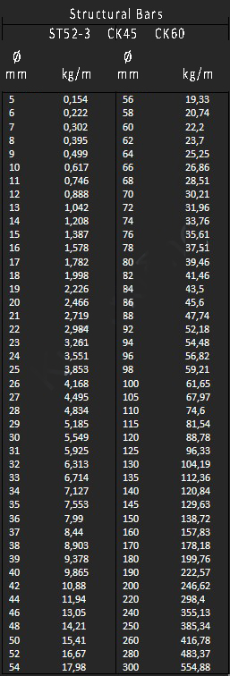

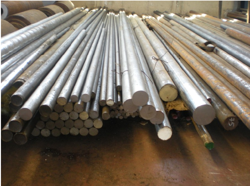

    Quote Originally Posted by kess View Post
    Hi blkadder,
    Glad that you like it.
    I think that the Craftsman’s base is cast iron made.
    If so you need to replace only the column.
    You can order from your local dealer to cut a piece according to the length of your need.
    The cost isn’t too expensive (perhaps about 1.5$/kg).
    You can use the table to calculate the kilograms according to your column’s dia.
    Regards
ID:	25229 Click image for larger version.
    i heared of people using old drillrig pipe or a chromed piston piece from a hydraulic cilinder , the last is pretty smooth tough and hard to bend even when hanging a metric ton off it
