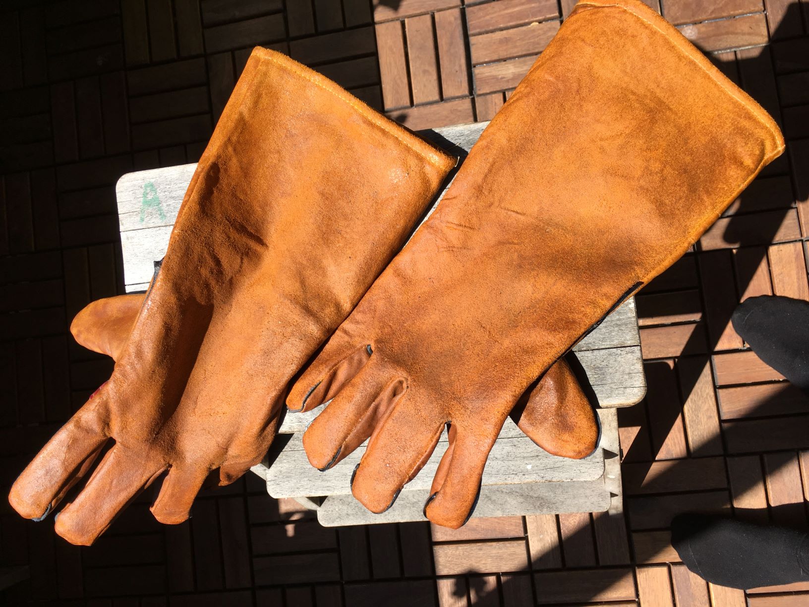

    Whilst having a 30-ish deg C heat wave here in Stockholm, taking a pause from my mini lathe teardown & overhaul,
    I figured it would be great to have my foundry PPE (suede leather gloves, apron, sleeves and boot covers) conditioned and baked.

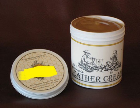

    Thus armed I searched and found a product (with almost a cult following amongst all their satisfied customers),
    a producer (with a homey & small-scale, environmental-friendly rural "Guarantee" to boot).
    Now, this company is not better or worse than average in marketing BS, thus I humbly doodled their "Brand" away.

    "-Awww - Isn't that nice? Swarming bees and Leather Cream Cowboys?" (Whaat? - Did they really name the pic like that?)

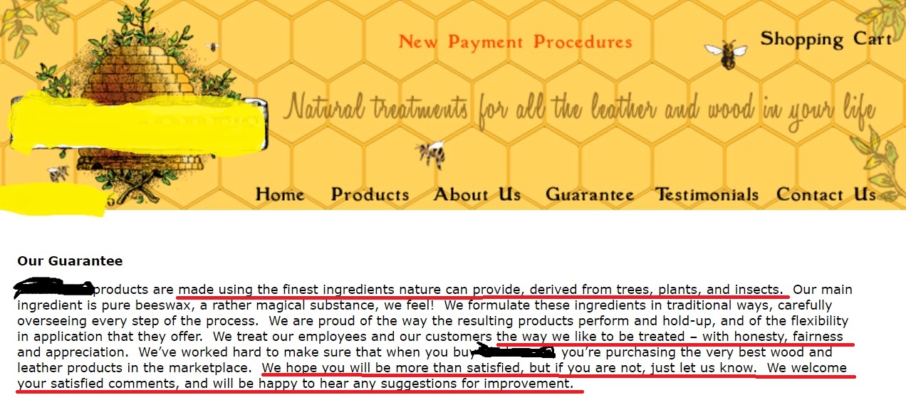

    As if that wasn't really enough, there's more:
Name:	BS Guarantee.jpg
    I took the liberty to underline the sentences of importance above. We'll get back to this. (-See where this is going?)

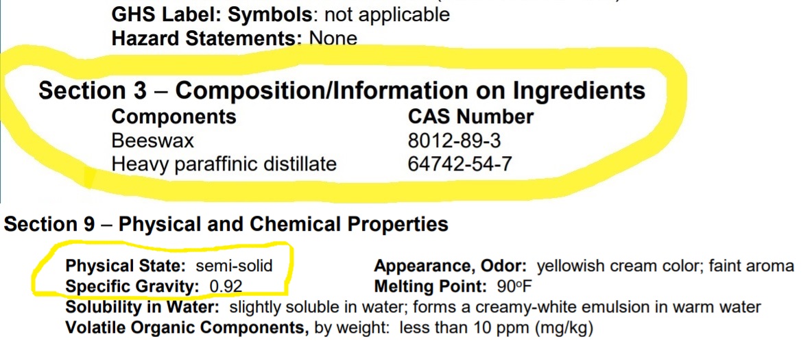

    So- what's my problem with this product and producer, you might ask?
    -Nothing wrong with the product as far as I can see, as you all will notice -
    it's the producers's own statements that pretty soon will get them into trouble, on the arrival of this: (-Uh-oh - here he goes!)
Name:	Leather Cream comp, phys & chem MSDS.jpg
    Right: An ordinary Material Safety data Sheet with only "Beeswax" and "Heavy Paraffinic Destillate" (no proprietary substances)
    as "the finest ingredients nature can provide, derived from trees, plants and insects".
    Below: its density value, from which the proportions would be derived, as long as you know the density of the constituents.
    This math I kindly omitted in the following, when finally making this wonderful, natural product!
    Critical approach and a search engine made the following detour before the long-awaited conclusion:
    1) Search for CAS # at the regulatory agency's database, regarding any deviations from mfg's statements or MSDS.
    2) Do a global search for what product that'll provide the cheapest and largest content of "CAS # 64742-54-7".
    I did - and I surely found an easily and cheaply obtainable product: Auto Trans Fluid. 100% of above.
    So to make ATF, you start with ordinary, fossil crude oil, which sorta IS from "plants, trees, insects" when you think about it.
    Well, that isn't what the mfg sez - and when I asked about it - neither was I answered on their page, nor did I get a reply.
    eBay hasn't even bothered to enter any critical comments to lower their revenues. (-Is this guy a Commie?)
