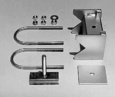

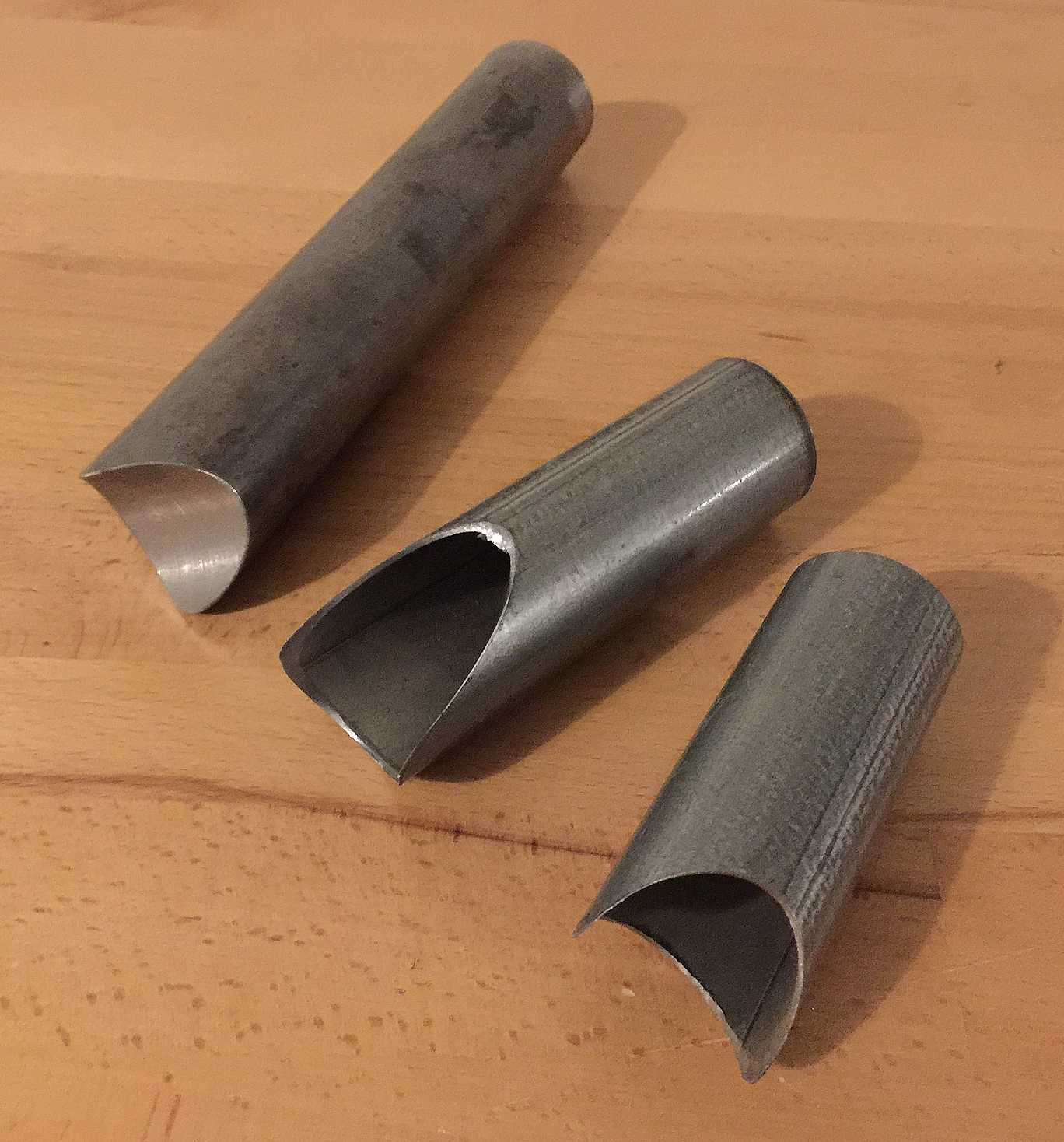

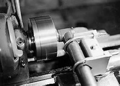

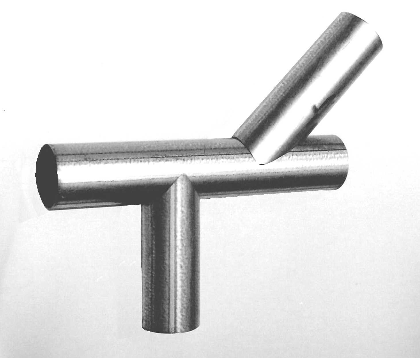

A milling attachment is heavy and cumbersome, and there is always the chance of accidentally dropping it on the ways. I came up with this piece to cut notches in tubing without resorting to a milling attachment.
Chuck up a hex shank hole saw, mount this little attachment, and you are good to go. The longitudinal power feed makes it automatic. It cuts solids like butter as well.
