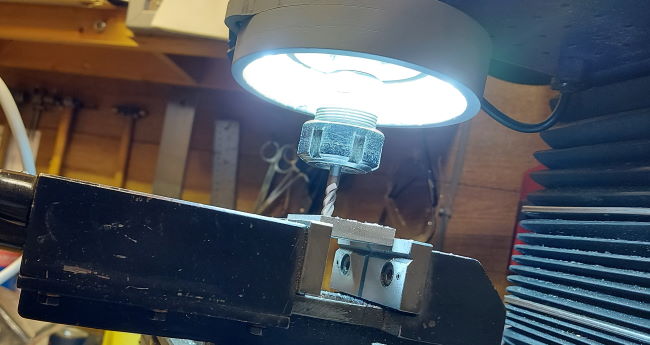

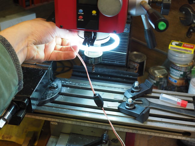

    I bought a 100mm diameter Angel Eye led array - essentially a circular LED array that is normally for aftermarket use around car headlights, normally always on as daylight running lights.

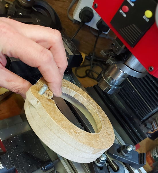

    I then created a simple MDF housing for the light that bolts to the spindle on the same bracket as the magnetic strip for the spindle measurement on a Sieg SX2.7 - more details: Sieg SX2.7 Angel Eyes
    This housing shields your eyes from the side and bounces the light back onto the spindle.
    With the 100mm diameter array it creates a uniform light on the end of any milling bit that is just brilliant. There is no flickering that I have observed to date and it is really cheap. I would like to use this MDF holder as a prototype for an aluminium holder and shade as I could make it thin and very light.

    The one I'm using is approximately 4W and this is quite high for LED lights. It's bright enough that you cannot look at it directly. The test is the difference it makes to the ability to align parts on the table and it really is a transformation.

    Do you get a black spot when the quill is extended? I did when I tried a ring light. I found that lighting from both sides obviated this.

    The light moves with the quill and so doesn't block it. I've tried it with a short 3mm slot drill and it worked a dream, gets even better with longer bits.
    The aluminium foil around the inside of the shade should reflect quite a lot of light and extend the size of the light - the light is very even on the table and on the drill bit
