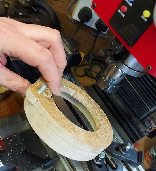

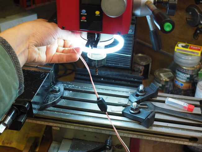

I bought a 100mm diameter Angel Eye led array - essentially a circular LED array that is normally for aftermarket use around car headlights, normally always on as daylight running lights.
Attachment 37903
I then created a simple MDF housing for the light that bolts to the spindle on the same bracket as the magnetic strip for the spindle measurement on a Sieg SX2.7 - more details: Sieg SX2.7 Angel Eyes
Attachment 37904

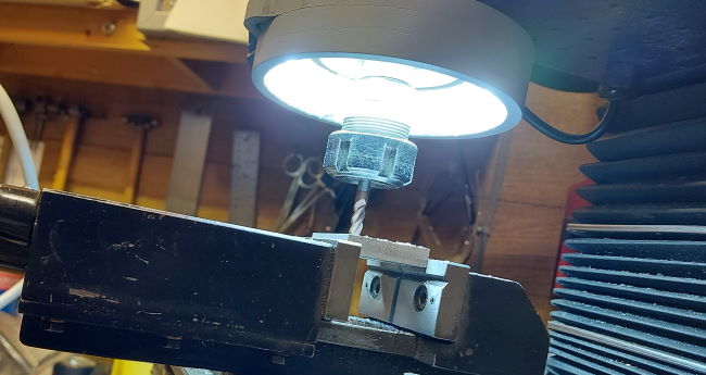

This housing shields your eyes from the side and bounces the light back onto the spindle.
Attachment 37905
With the 100mm diameter array it creates a uniform light on the end of any milling bit that is just brilliant. There is no flickering that I have observed to date and it is really cheap. I would like to use this MDF holder as a prototype for an aluminium holder and shade as I could make it thin and very light.
