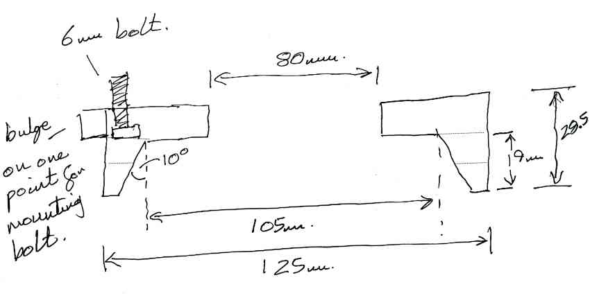

1 Attachment(s)
Just made a simple cross-section with dimensions of this light shade, this is added to the original page on this mill light design.
Attachment 39434
The 10° inner angle and aluminium foil lining the inner surface removes the deadspot - well it works for me
