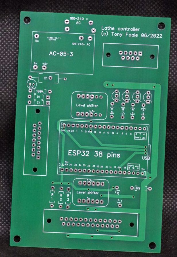

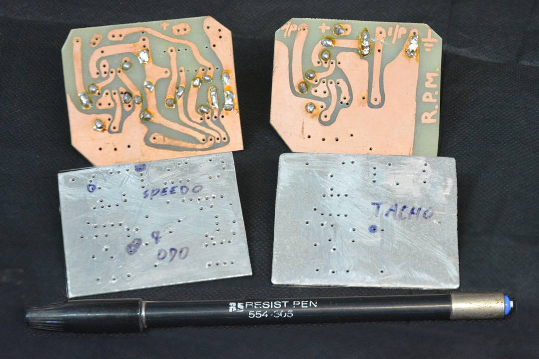

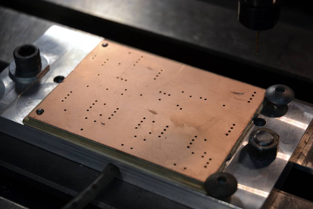

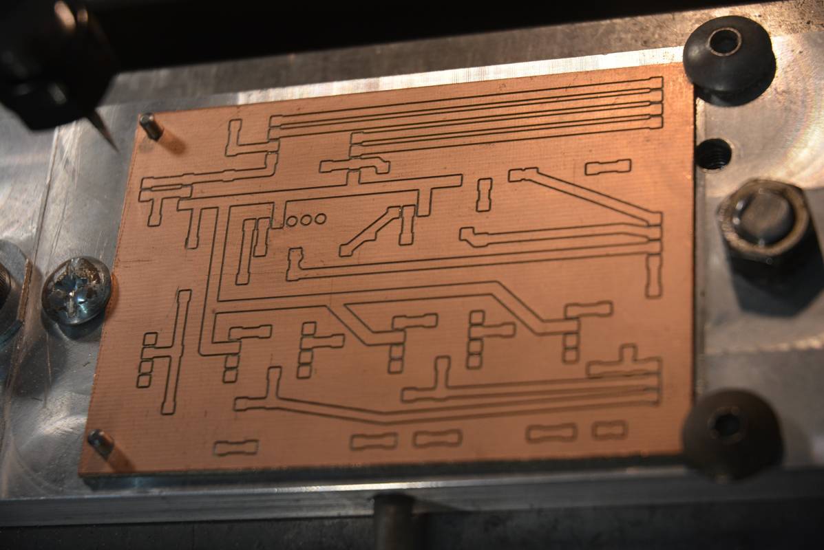

    In the early 1980s I needed to etch a few PCBs and I made simple dedicated drilling guides in aluminium. I would drill the holes first and then use the holes as a guide for hand drawing the traces with a resist pen. Now for simple boards I just use Vero board as a drilling guide but I now do more complex boards by milling.
    Circuit Board Drill Templates-80s_pcbs.jpg Click images for full size
    Circuit Board Drill Templates-donemilling.jpg Circuit Board Drill Templates-perforatingboard..jpg
    Sometimes I still drill first but not always.

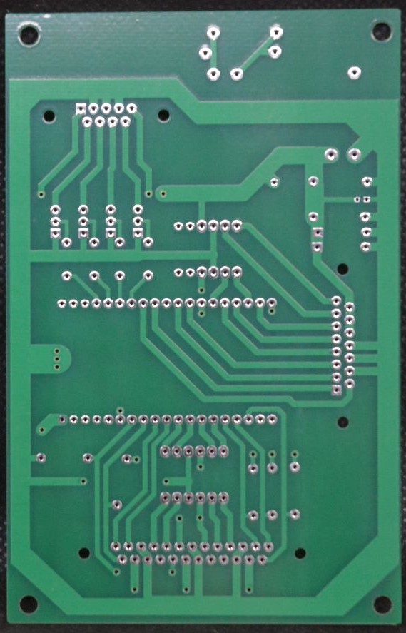

    If I am not in a hurray I now get them made professionally because they are so cheap and on another quality level. Rapid shipping puts the cost too high, which is the reason that I only do this if time is not a factor, but it usually is.
    Circuit Board Drill Templates-realthingfront.jpg Circuit Board Drill Templates-realthingrear.jpg
