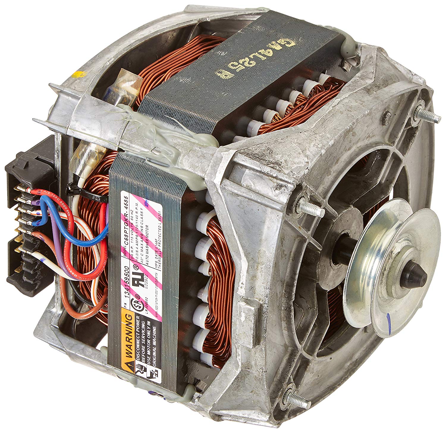

    Just a comment for people running out to get free motors, every appliance motor (larger than a drill or wood router) I've seen here in the USA for a very long time has been a brushless motor of some type. Mostly simple induction motors with a run and maybe start capacitor. More recent ones may be 3 phase with a VFD controller like in my LG washing machine above. Here's a random example of a modern USA washing machine motor.
    https://www.amazon.com/Frigidaire-13.../dp/B00M25OKO8
    Circuits to reuse washing machine motors to drive workshop tools-a1xowj-ofql._sl1500_.jpg

    I think it's like computer power supplies, people see them and figure it's something like I need so I'll just use it. Sometimes it's a reasonable fit, sometimes not. When it's not I've seen people go through a lot of trouble to make it fit.
    Here in the US I haven't seen brushed motors on anything bigger than a circular saw, drill, or vacuum cleaner. Washing machines, refrigerators, pumps all have induction motors of some sort on them. So, if the motor is the speed you can use and you have the right circuit to drive it (probably just capacitors but may need a start timer), go for it.
