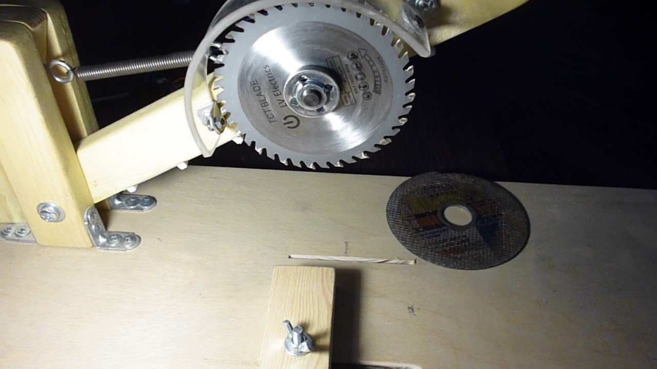

    Today we will try to make with you a self-made cutting circular saw which, I think, any master will not refuse.

    Big flaw in the design! The blade is turning the wrong way! It is throwing the sawdust at the operator & pulling the material being cut away from the back board. It needs to cut the material to be pushing against the backboard/guide.

    Just turn the motor to the other side.
