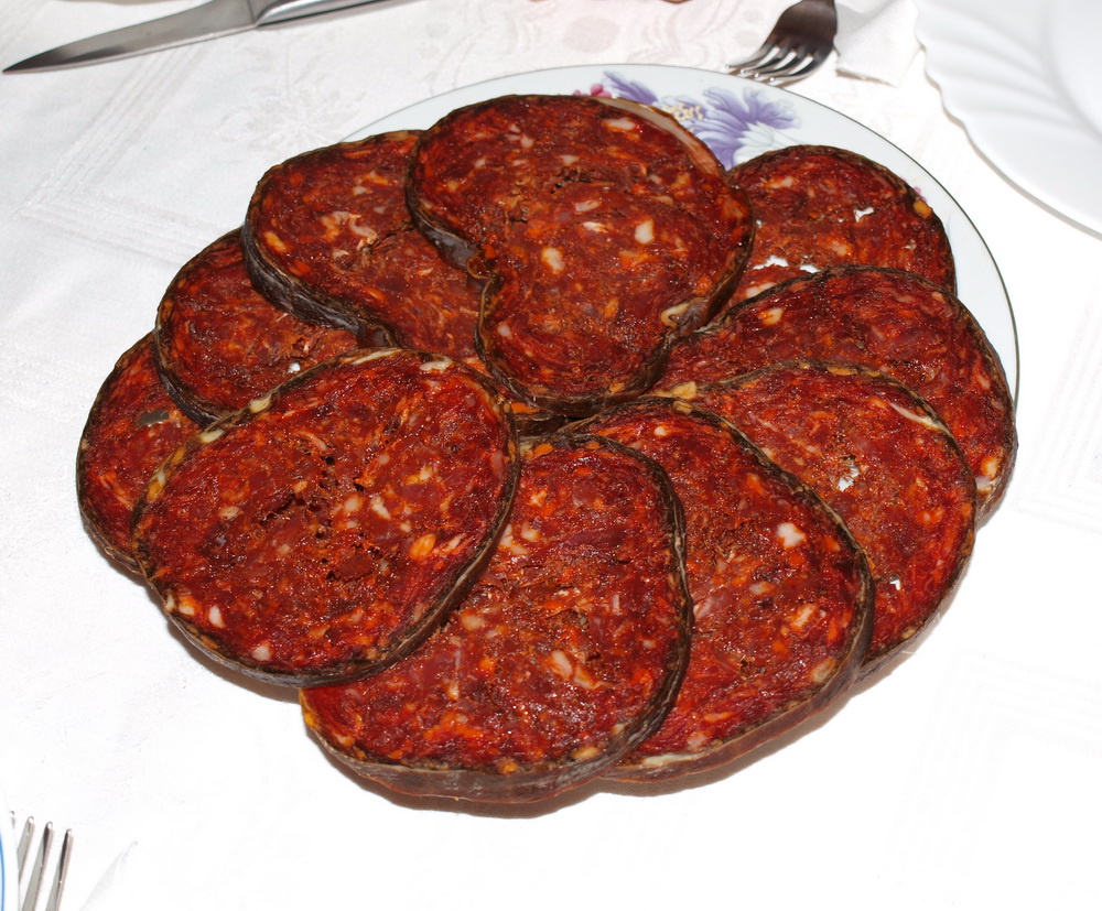

Then we add other things for taste: 2.8% Salt, milled black pepper, hot pepper, chilli, red sweet pepper powder, garlic juice, add sugar someone (just a little). How to know a good quantity? Simply make a small hamburger that you throw on the pan and after the baking you taste it. When this baked hamburger will be little more salty and a little more hotter- the sausages will be the best for you because they will lose it after drying. If you want to have more hotter sausages- you can add more hot chili powder.
Notes from me: (her!)---feather-ruffling time!
We never add so much salt to meat for sausages !!! We add 2.4% of salt. Also he wrote that he cut fat on cubes 15x15x15 mm---- it is too big, giant pieces of fat !!! Disgusting !!! I will never eat sausages with the big pieces of fat !!! The pieces of fat need to be more smaller- max. 3x3x3 mm. We have here special machines for cutting fat on small cubes.
Also we add nitrites salt- small part ... Also we add a big spoon of sugar ... The color of sausages will be red after drying .... If you will not add nitrite salt to meat- the color of sausages will be dark after drying ...
