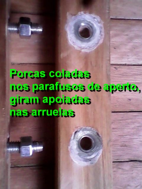

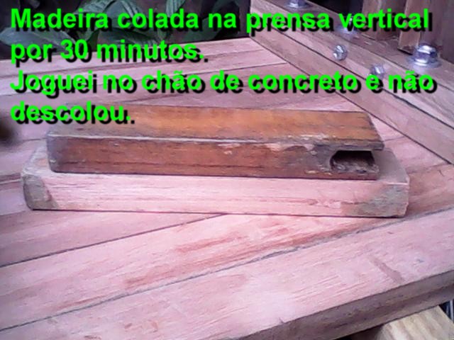

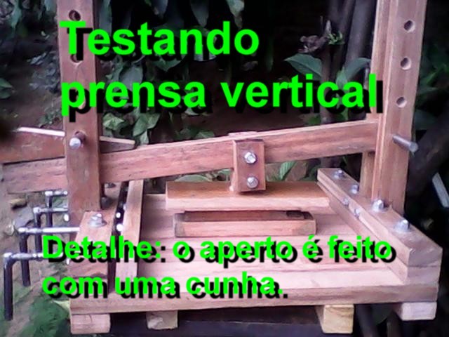

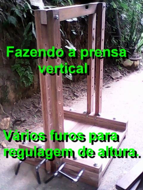

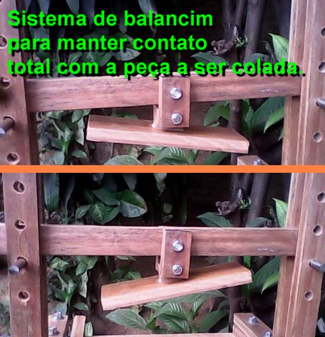

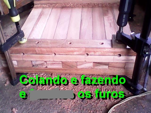

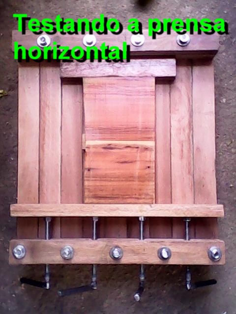

Combo prensa para colagem de madeira, tanto na vertical como na horizontal.Attachment 4431Attachment 4432Attachment 4433Attachment 4434Attachment 4435Attachment 4436Attachment 4437
