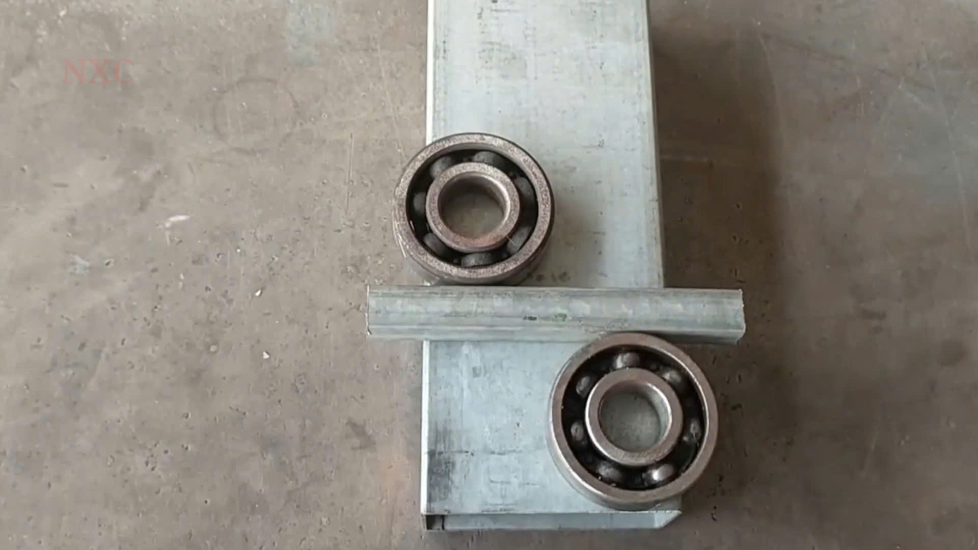

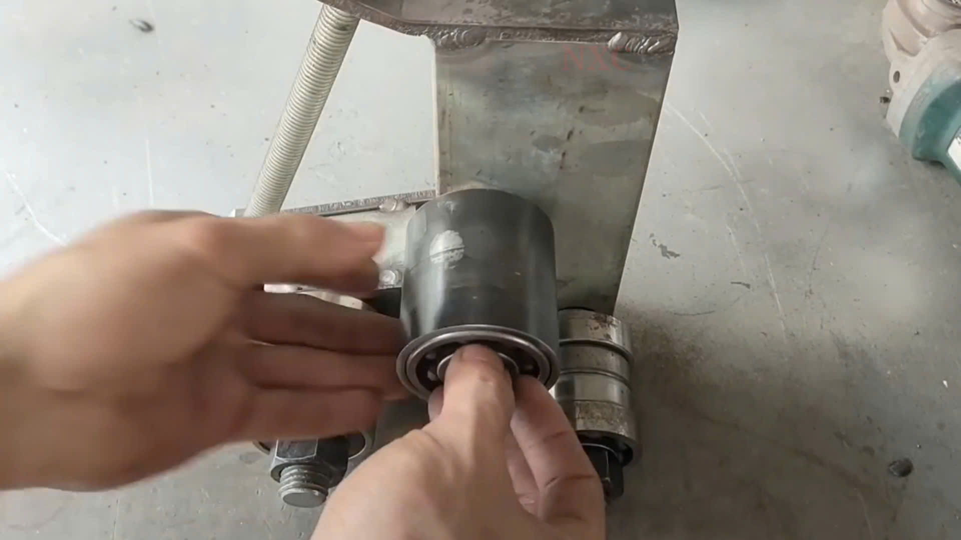

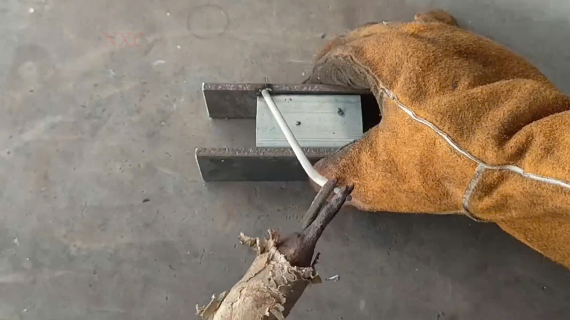

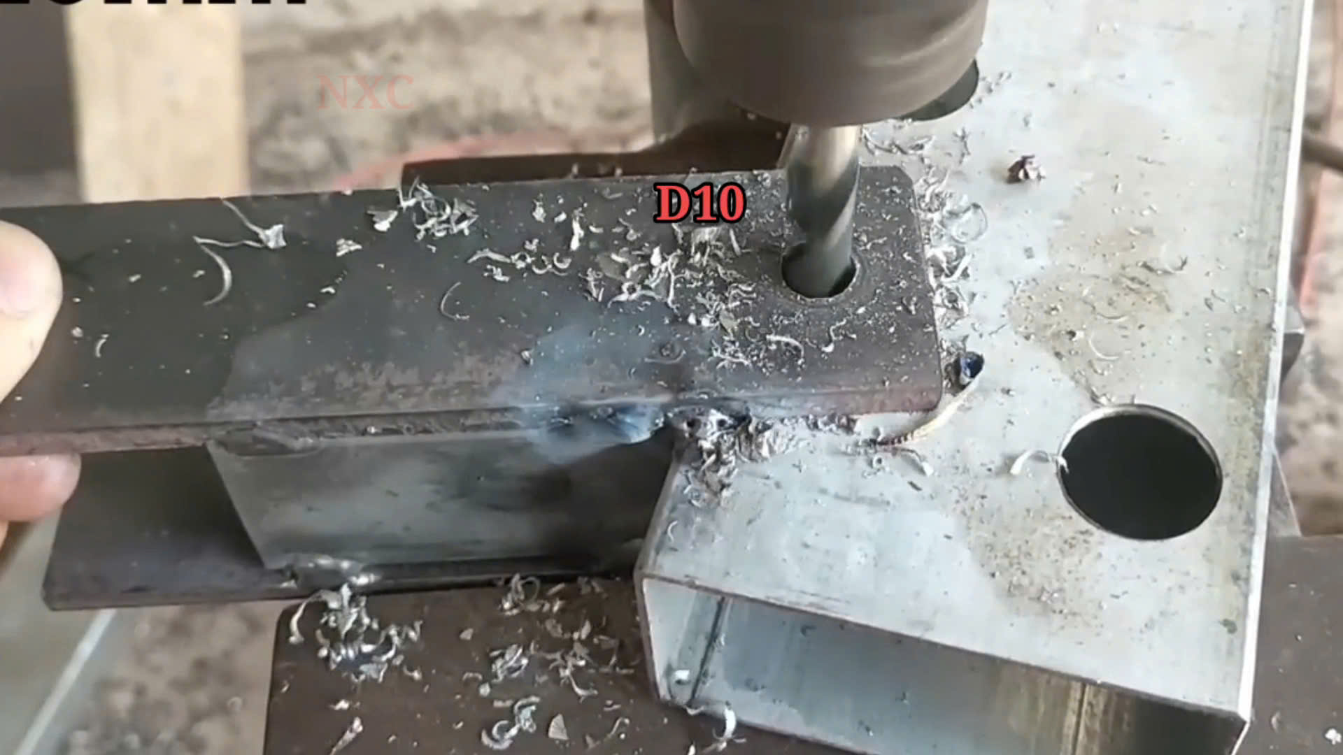

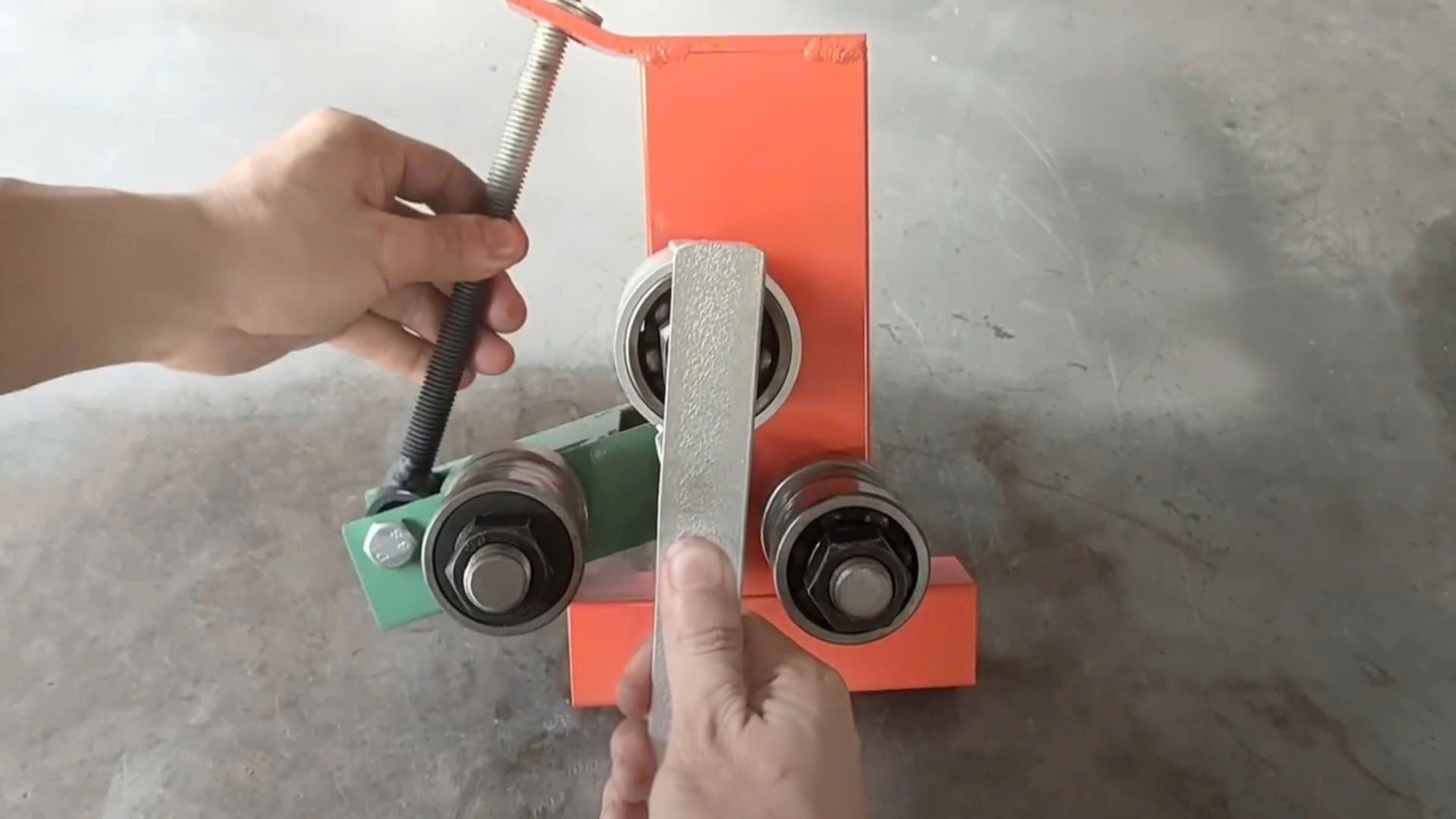

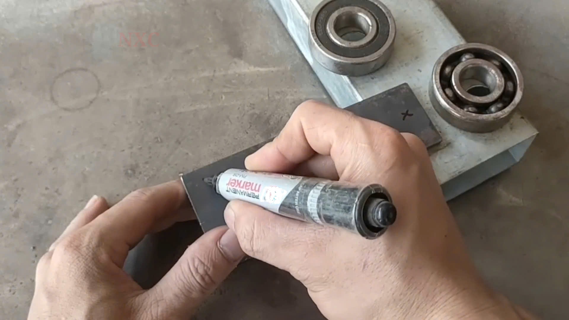

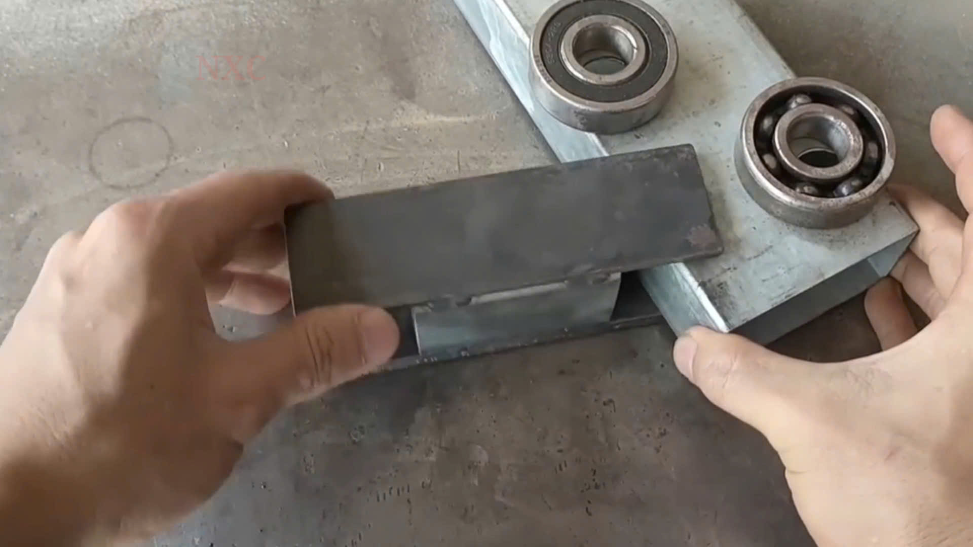

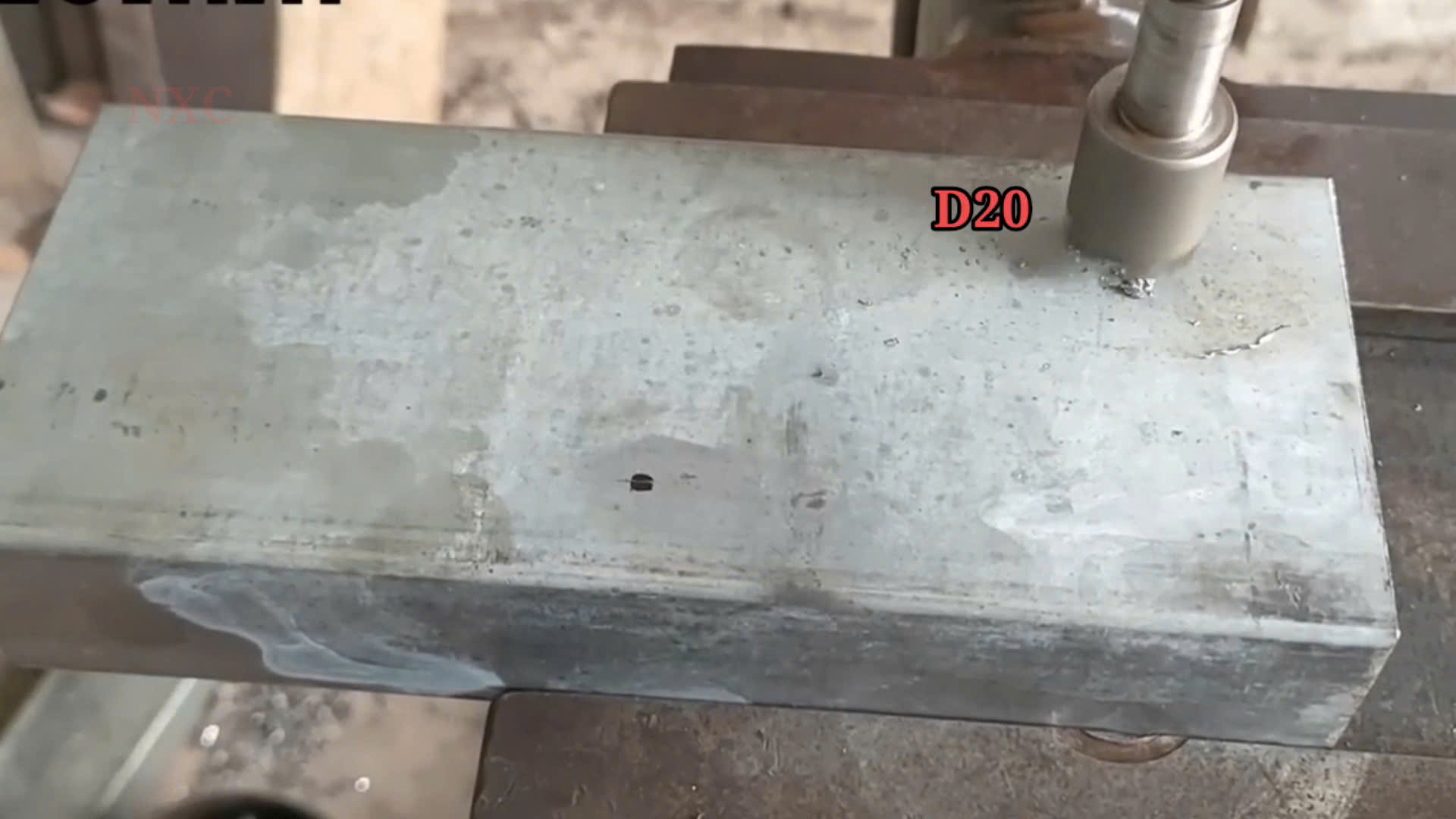

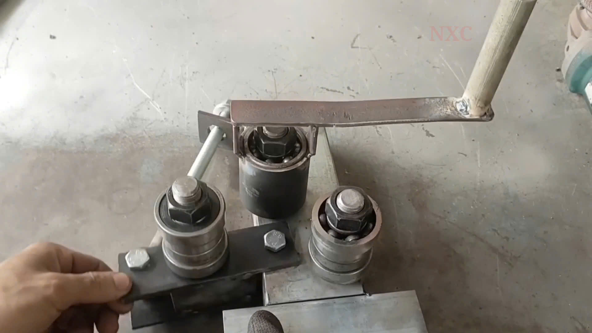

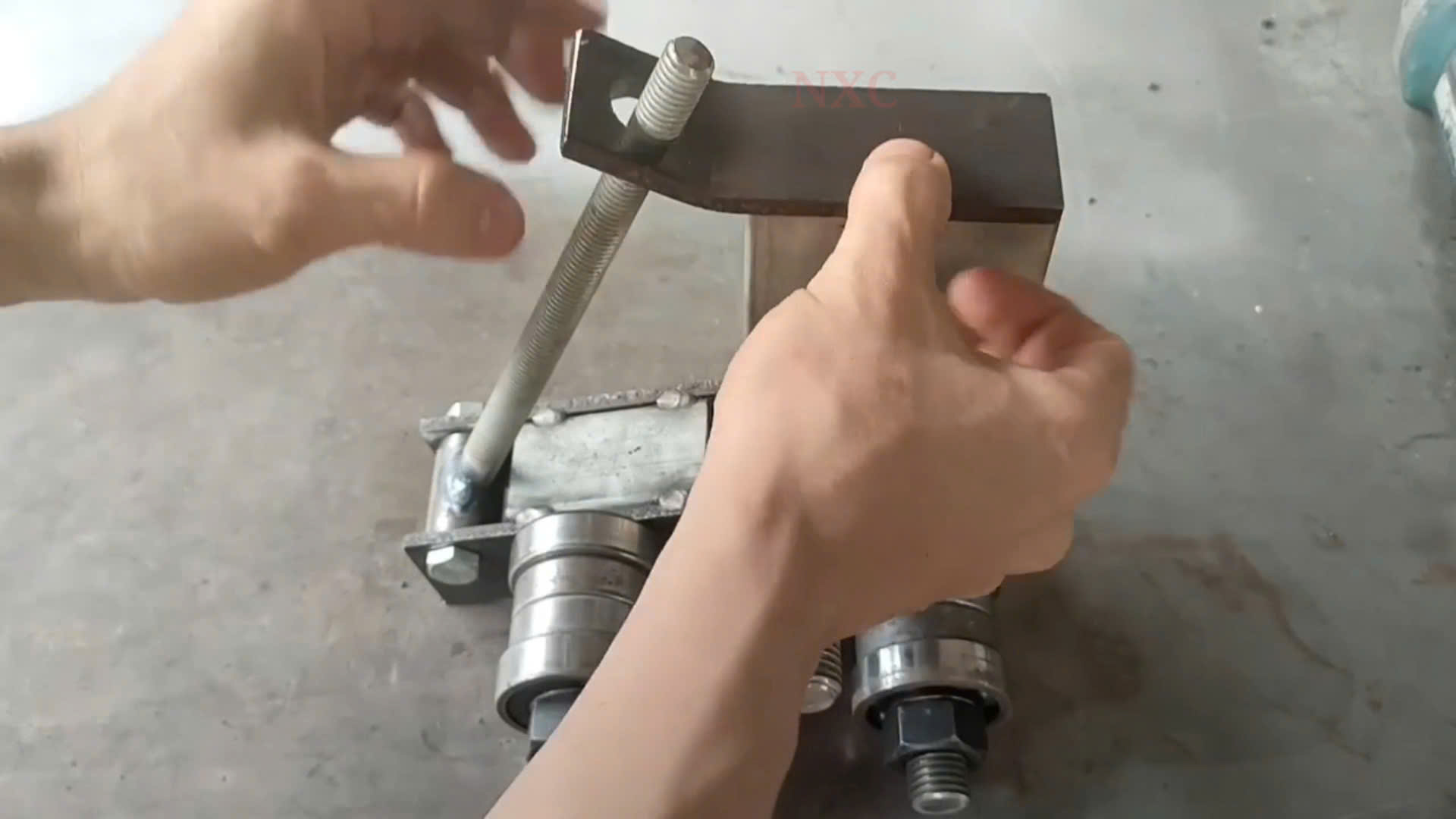

    This compact roller bender built used basic materials and components like bearings, bolts. This tool is perfect for small workshops.
