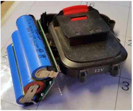

    I had a similar deal with my NorTools impact driver. #2 batter would NEVER hold a charge for very long and #1 is slowly catching up to #2. I took #2 apart and it couldn't be simpler. It's just 3, 3.7V 1300 18650's. Short money on eBay. If you can drive a soldering iron, the replacements job should be less than an hour.
