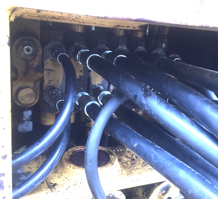

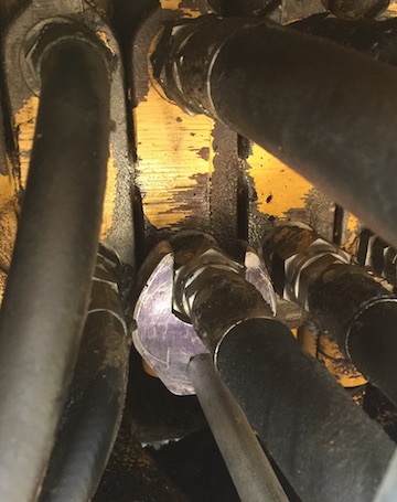

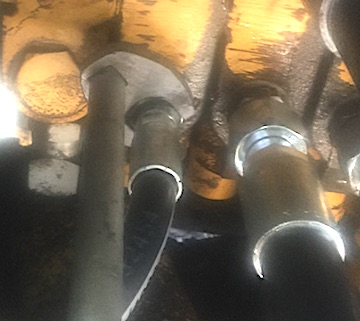

    Needed a 7/8 and 1 1/4 crows foot wrench to get into a tight space.
    Hydraulic manifold
    Failing to locate them locally, with broken equipment to get back into service, I headed to the shop.

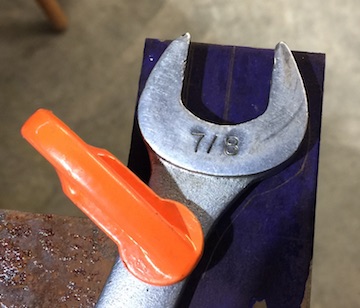

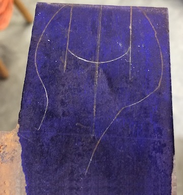

    After accurately laying out the proper size opening, traced the outline of a wrench on an appropriate steel plate. 3/8’ for the small one, 1/2” for the large.

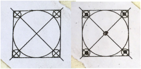

    I often use a paper pattern for repeated layouts. Tape the 1/2 square drive pattern to the plate . Center punch through the paper .
    Drill the corner holes through and start the center hole with a small bit, about 0.070”(5/64 is close enough). Then enlarge the center hole to 3/16 then 3/8 then 1/2”.

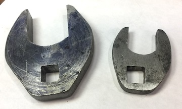

    Finally, bandsaw, grind and file the finished shape. The offset hole allows you to turn the tool over for different offset if necessary. I made the large one first. Learn from experience.
    You can reach as deep as you have extensions.
