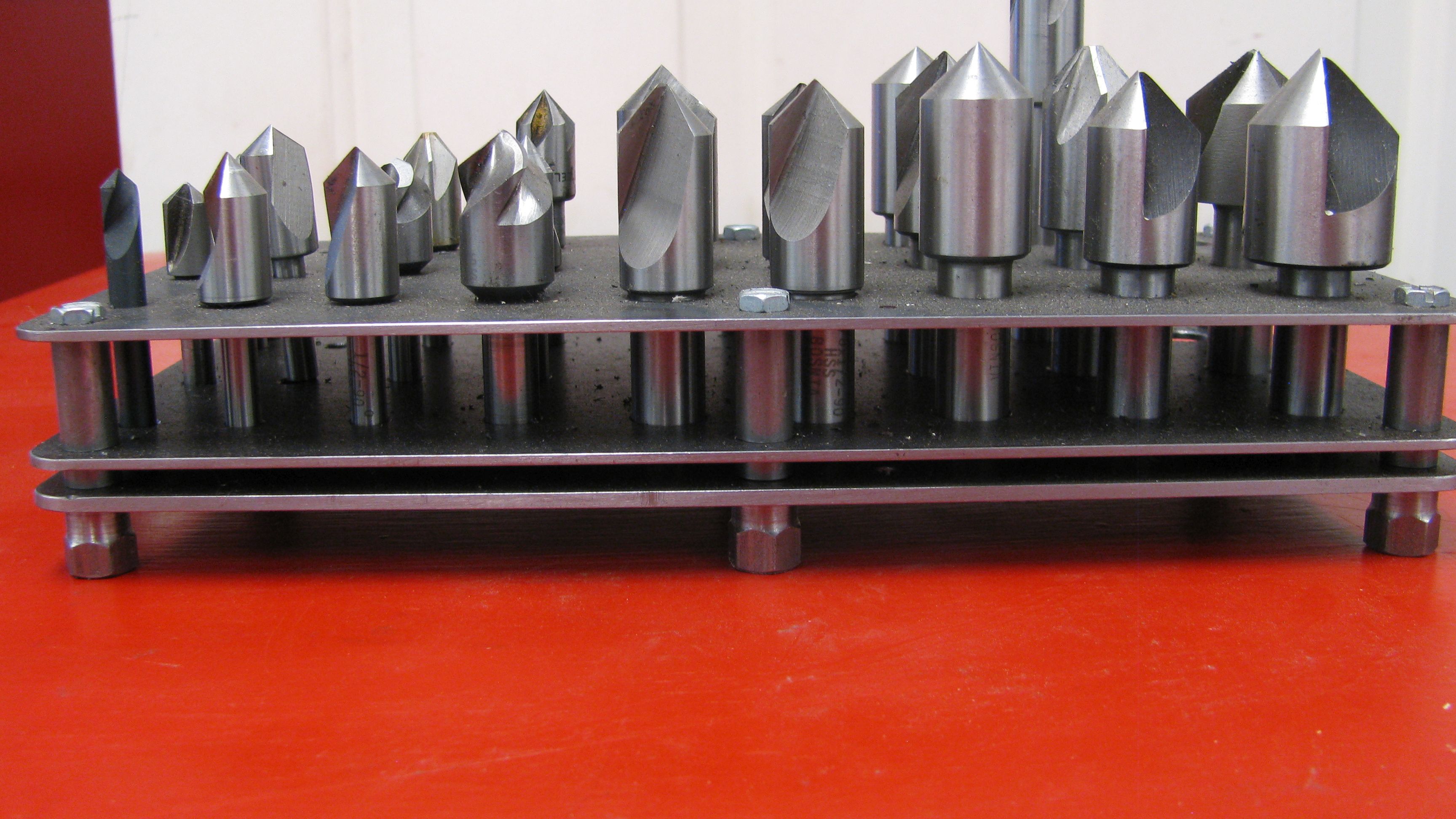

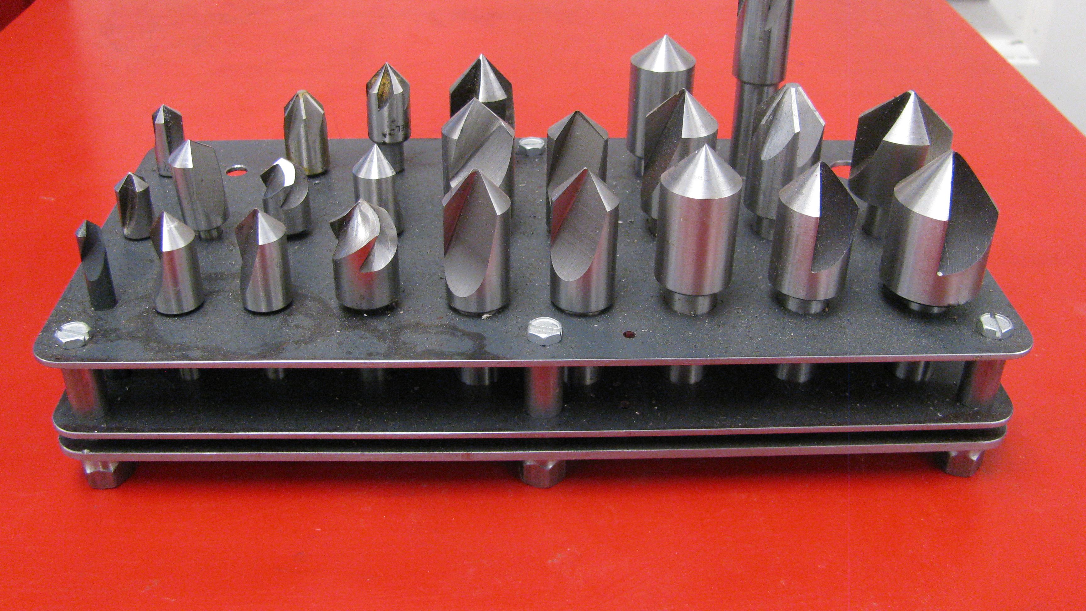

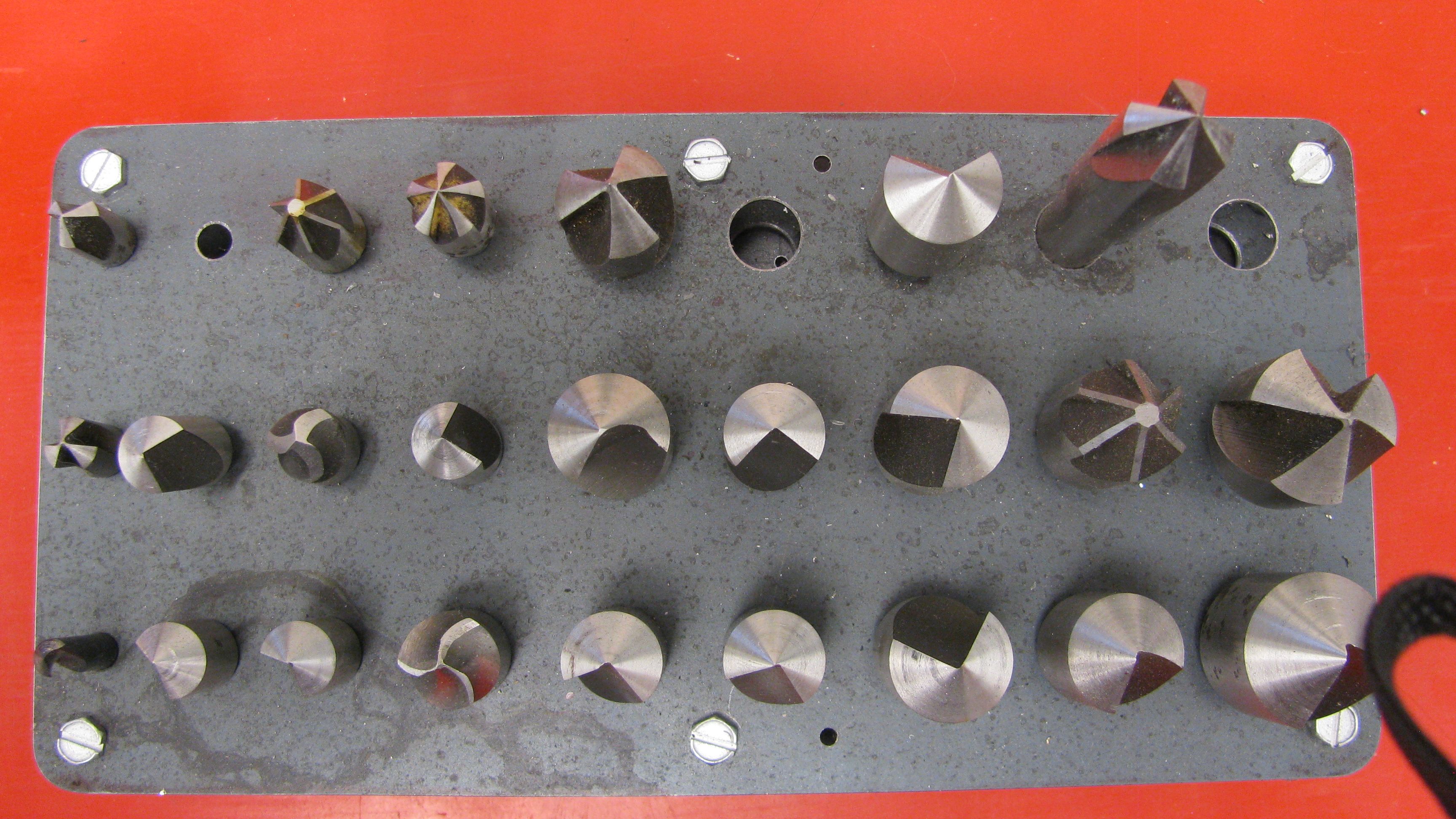

    Finally got tired of rummaging through my tool chest and searching for the appropriate c’sink.
    Here is a simple and useful project that can be built in about half a day or so. The CAD l/o
    probably took longer to develop than the actual time spent in fabrication.

    Nice organizational project, Phil and well done. Should last more than one lifetime the way it is built. Thanks for posting. It gives me an incentive to produce one for my shop. What did you use for material?

    old_toolmaker,
    Thanks for your interest. The sheet stock is some 16ga. Hot Roll Steel. The standoffs and nuts were made from 1018 Cold Roll.

    Shelly142,
    Thanks! I was unsure if the material was metal or some type of plastic sheet stock.

    Very handy, my countersinks currently live in 4 locations in the shop, need to centralize, thanks for you post

    My countersinks live in two steel blocks with holes for their shanks but I don't have space for all.
