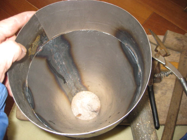

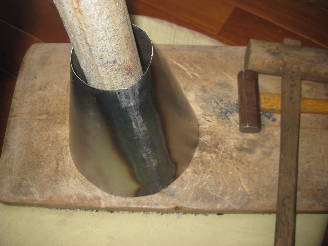

    I made one with 0.8mm thick steel sheet and an aluminium pan which I used to use on family BBQ twenty some years ago.
    First I made some tack welding to keep the cone.

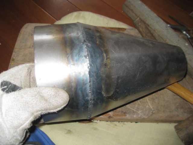

    Then gave this cone butt welding.

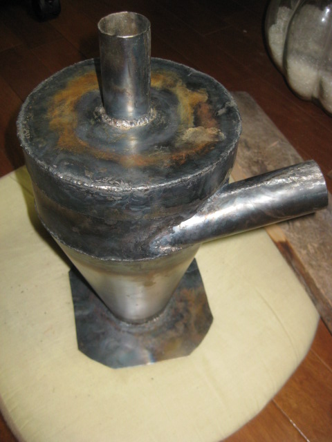

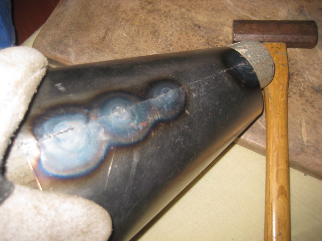

    Welding upper wall.

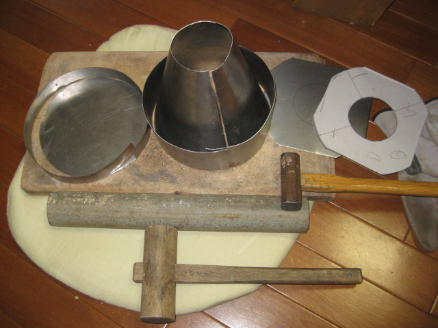

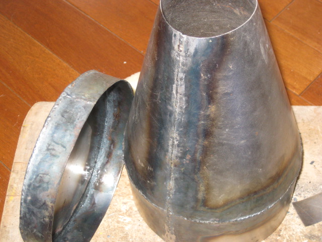

    Top cover was also made from 0.8mm steel sheet.

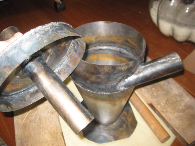

    Vacuum pipe and suction pipe are made from the same steel sheet too. But I was not very sure if this length of the vacuum pipe works well for my purpose, separating tree leaves and bamboo leaves. Mostly they are a tad bigger than the dust we usually deal with.

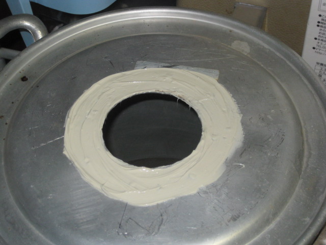

    The top lid of the aluminium pan got a round cut, and I put some silicone rubber for sealing.
    Epoxy added to the joint.

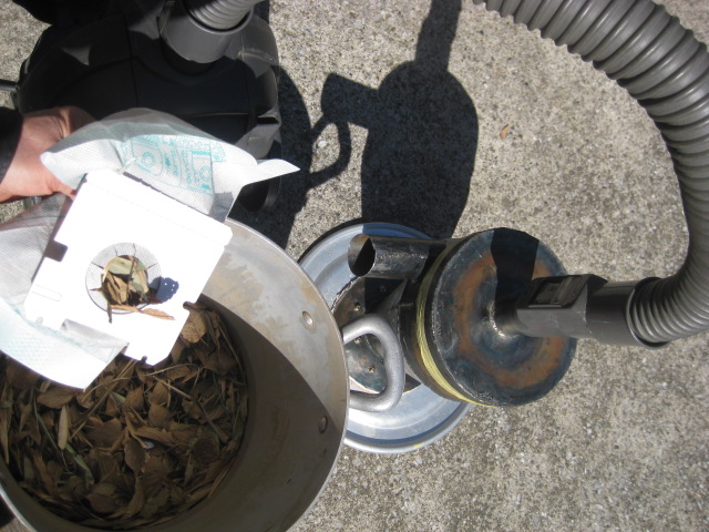

    A test run told me that I should better give it some alteration.

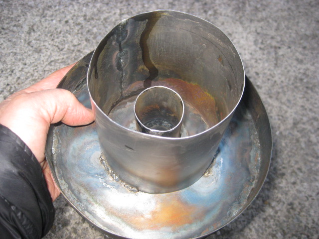

    So I made a cut to the inner pipe or vacuum pipe to make it short, and added another bigger round separator wall around it.
    Now it works better!

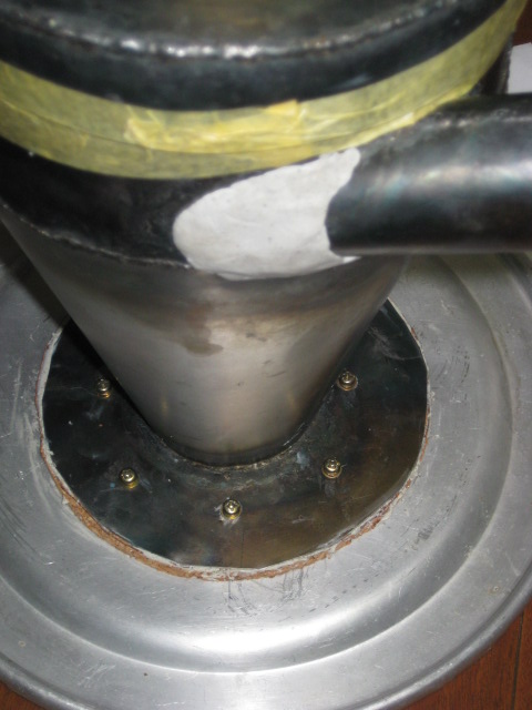

    I'd like to know more about the math of perpendicular joining of conic sections in pics 7 & 8

    Quote Originally Posted by neilbourjaily View Post
    Joining two cones ain't something for those faint-hearted, but "Elliptic Curve Handbook" might be something you're looking for:
    Link: https://webs.ucm.es/BUCM/mat/doc8354.pdf
    Sorry for being late here,
    that part is not very easy to me too, wanted to joint them with ox-athetilane torch welding but finish was no good, lol.
    see pic #9 where i used epoxy to fill up gaps.
    Thank you.
