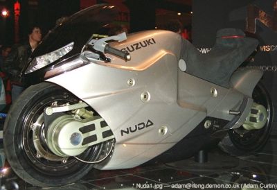

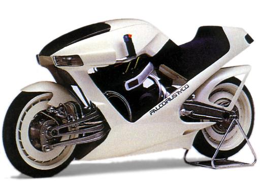

    BTW Tony,I've read a lot of your motorcycle stuff over the years, were you involved with the Suzuki 'NUDA' concept bike? It has similar steering set up to the GSX you built (pictures at Cadwell Park)
    Maybe you are thinking of the Rusty Falcon which predated the Nuda. The Nuda had conventionally orientated handlebars whereas the Falcon had roughly vertical bars as did the QL and Q2 series of bikes that I built, the first versions predated both of Suzuki's concept bikes. I had nothing to do with of those. Both the Suzukis had FFEs (Funny Front Ends) as did those of mine which you mentioned. However, the mechanisms were quite different to mine.
    For those unfamiliar with these concept bikes here are a picture of each
    Cylinder boring without a cylinder borer.-nuda-leftside.jpg Cylinder boring without a cylinder borer.-suzukifalcorustyco.jpg

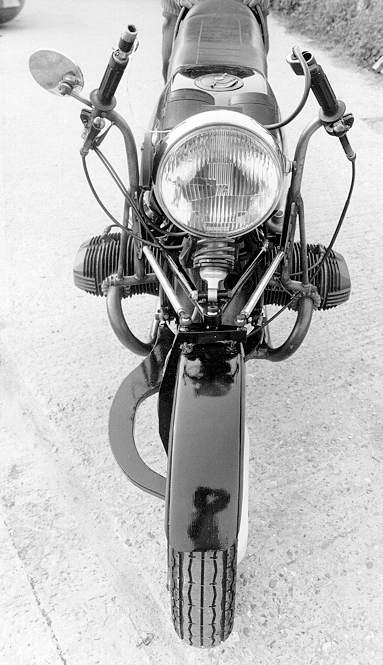

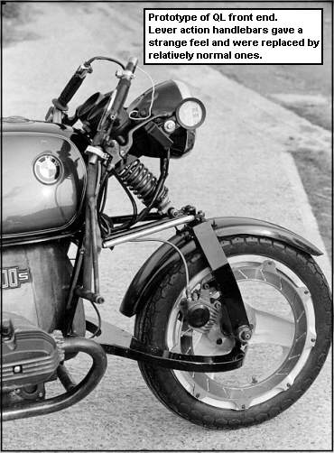

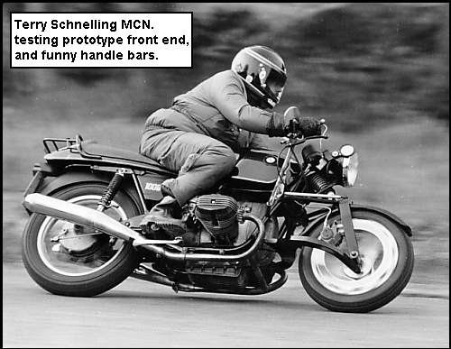

    Here are more. showing a test bike converted to my FFE and upright handlebars from around 1980.

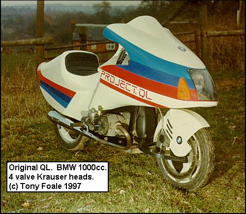

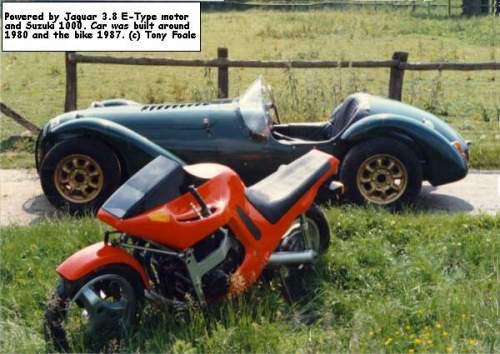

    Yep, it was the Falcon I was thinking of. I know I downloaded a picture of a GSX (maybe GSX-R?) engined special a few years ago (probably 12+?) If it isn't one of yours I'm wondering who built it? It had 'vertical' bars similar to the BM
    That sounds like one of the Q2s that I built. I did post a photo of one here in another recent post but here are some different pix. of both a QL and a Q2.
