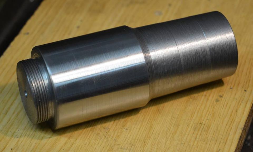

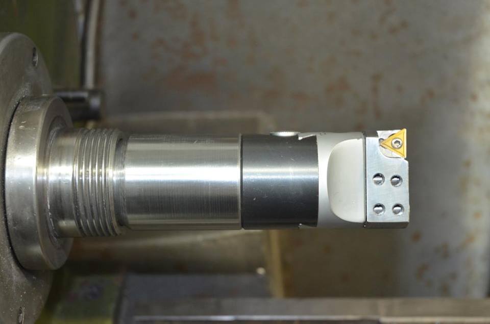

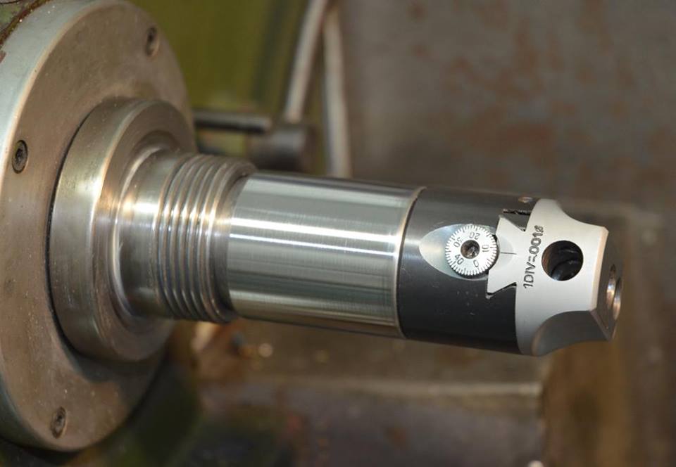

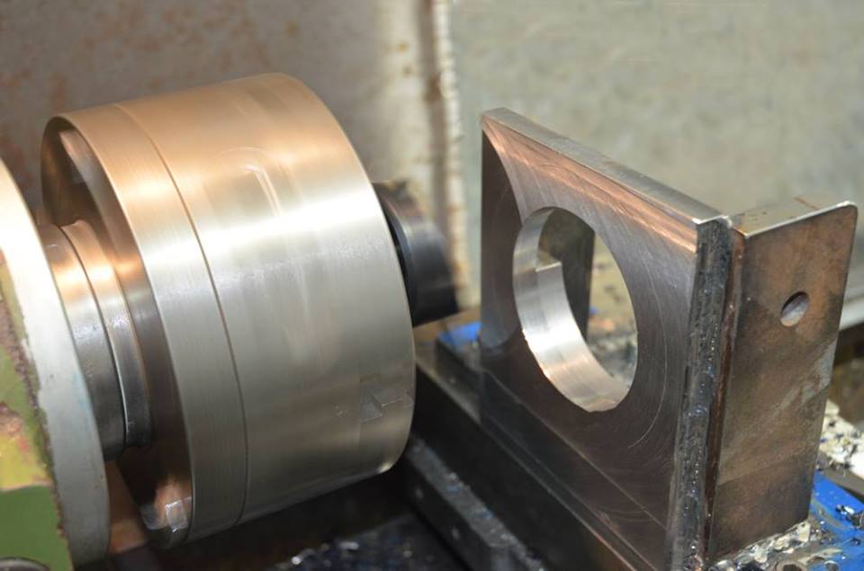

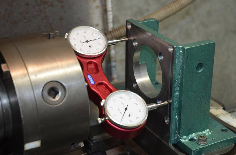

    I always like seeing your solutions, getting around obstacles. Very nice work.
