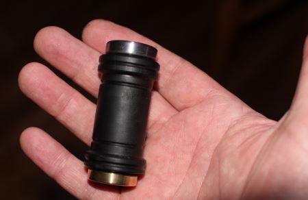

    Dead blow palm hammer
    I wanted to play around with the idea of a dead blow hammer and came up with this, more details on my page here: Palm Dead Blow Hammer – glue-it.com
    The size and weight is great and allows for gentle sheet metal work

    Two remarks gleaned from my experience making a near identical tool...
    Make the length of the tool such that, grasped in the palm, each end projects a minimum of 1/2" from your hand. This will prevent painful pinches.
    Lead shot makes for a deader blow than steel balls. I use #9 birdshot available from reloader suppliers.

    there are times when model making and working with thin brass sheet (eg 28 gauge) that you do need a gentler touch
