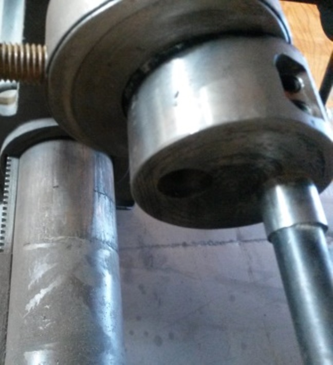

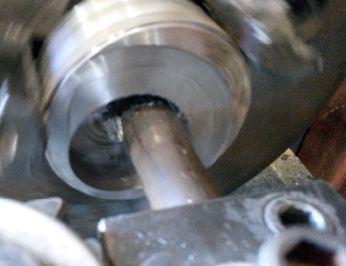

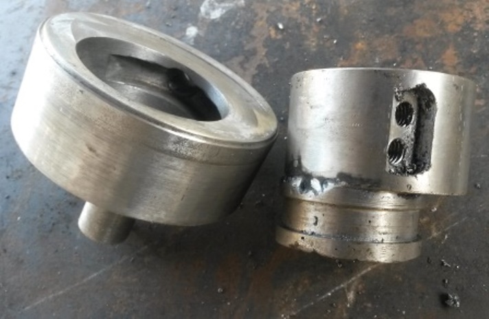

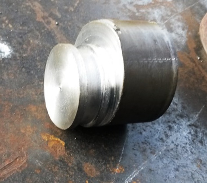

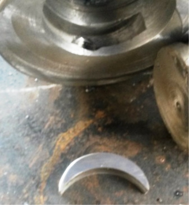

    Well I am off to plan "C" the idea of placing a set bolt in the center would only work for up to about a 1/4-20 without having to cut into the center shaft that goes in the collet and I feel that anything less than a 3/8-16 would not do much if I ever needed to use a longer boring bar cutter like for going into 3 " or so, and should I go ahead and install the 3/8" diameter bolt the relief area required for the head would require me ot mill away a notch that would remove nearly half of the shaft which would weaken it too much for comfort. So I will have to install 1 or 2 set screws at angles to the original lock.

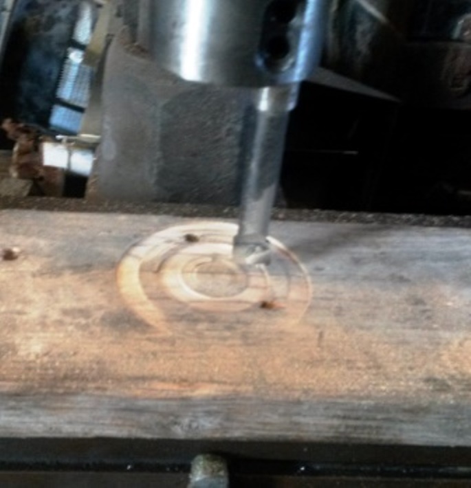

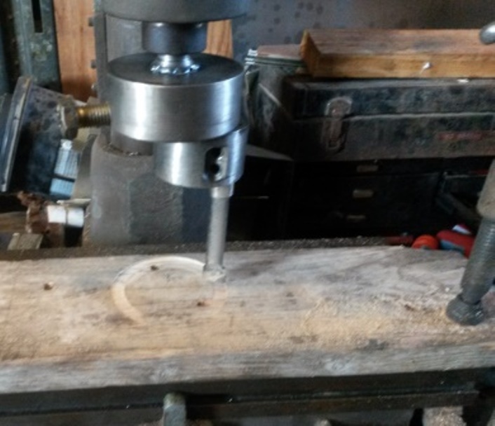

    Another thing I noticed after grinding the plates and trying the boring head again was as long as I force myself to take very tiny cuts it works great, however I noticed that I have quite a bit of slop in the quill bearings so I am going to have to deal with those soon.

    a real good quality1/4 or even 5/16 grade 8 with a hardened wavy washer under the head.will do a lot more than most people think torqued at only 14~18 pounds on that short of a bolt. as far as the 2 extra set screws, either use a "puck","key" something to keep from making an impression and making adjustability a chore. of coarse hardening the entire thing would also be a good way to keep brinelling&deformation ( boogering up)to a minimum. I tend to get impatent and dont like a lot of little cuts....thus..I sometimes swear a lot when something gets cut toomuch...., my worst thing seems to be making a new tool and not marking it for what it is and...sometimes it gets grabbed thinking it's a drop or whatever and... turned into annother tool...with out realizing it. especialy on round stock Ive made to hold something inpaticular to machine that part......and when Im done...ferget to mark it for what it is. sometimes scraps... are not realy scraps. I do repourpose a lot of stuff, like engine parts...forged piston tops are sweet for oh somany things. camahafts are great for many things too, but be carful if you try to cut the lobes off with a lathe it will beat the **** out of the lathe, those lobes are hardened. I started using a chop saw to cut the lobe's down before sticken in the lathe. keep on making and posting good stuff.we all need new ideas. even just seeing something gets our minds to wandering on something we havent thought of that isant the same but might have just 1 part that will set things in motion. as for the quill bearings....that tree your having lunch under is on a path that has no end.....

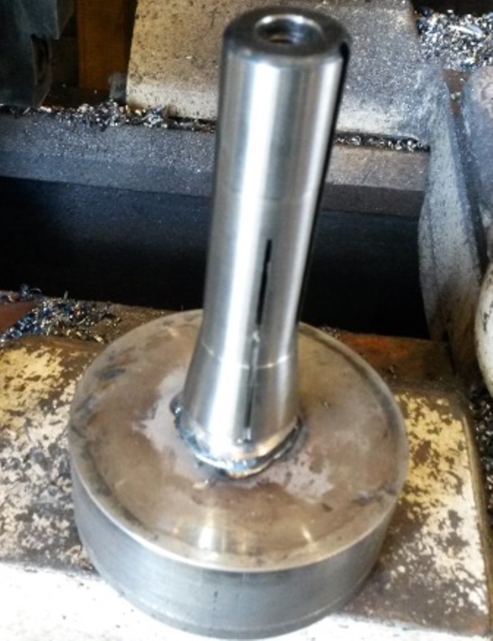

    This thread is old enough now that I guess it needs an update. Some of my observations after I made it and used it several times. #1 it is not as easy to index for bore diameters as a dovetail head would be. #2 after through drilling it from the bottom part into the top part and threading it for a 5/16-18 clamping bolt it did help with stability #3 the range of adjustment as I made it was a little lacking This could have been overcome by making the whole thing a larger diameter with slightly more eccentric offset and if I were to make another one like it, I would make the eccentric stem longer for stability. However, if I were to make another, I probably wouldn't use the eccentric design at all just take the extra time and make a dovetail boring head, the problem with that though is I still don't have any dovetail cutters.
    Ther is a consolation to a design of this type though. For someone with limited tooling or experience a boring head such as this would be an easier build and with some careful measuring you can achieve satisfactory results for about any bore you need to make providing you take your time. I am a little too impatient at times when it comes to running a mill, I just want to hog my way through the initial cuts and do a single final cleanup like I can do on a lathe, which is not a good practice especially with smaller machines I'm a T50 or MT7 type guy. The concept of an ER11 collet is as foreign to me as a bb gun would be to a gunner's mate on a battleship
